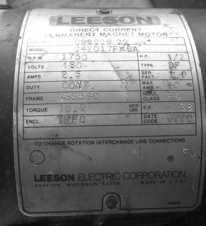

Seeking advice on DC motor speed control
« on: January 11, 2014, 08:18:53 AM »
I am hoping that someone can advise me on this. I have obtained two 180v 2.5A 1/2HP DC permanent magnet motors. I wish to control the speed of them and have found this on ebay:-  http://www.ebay.co.uk/itm/161069549443?ssPageName=STRK:MEWAX:IT&_trksid=p3984.m1438.l2649
To my limited knowledge it looks as if it would do the job, I aim to use the motors on a lathe and a milling machine. Could anyone tell me if they think that this controller is suitable.
thanks in advance.
Norman

Re: Seeking advice on DC motor speed control
« Reply #2 on: January 11, 2014, 08:49:07 AM »
Norman,
I would add another resistor in series with the speed control pot to limit the output as at 220V output it could well damage your motor.

  • Posts: 2540
« Reply #5 on: January 11, 2014, 10:37:09 AM »
The way I would do it is as follows......
Connect the speedo up to a 100 watt light bulb in place of the motor.
Connect a voltmeter across the bulb.
Now, add another pot by connecting it in series with the one supplied.
Turn both pots to max,then adjust the second pot until the meter reads 170-180v dc....
Switch off and remove your second pot,measure the resistance, that is the value needed....should it be an odd value then go up to the next preferred value available.....
Pm sent.....

  • Posts: 2540
« Reply #11 on: January 11, 2014, 03:50:43 PM »
Velocette/Eric,
The resistor referred to is effectively in series with the speed control pot and not with the motor....
Thinking about this, the speed pot itself needs to be reduced in value, such that the original value is not changed....Ergo, if the speed of the motor were to be halved then the value of the pot needs to be halved but the total resistance of the lot and the resistor adds to the original value....

  • Posts: 2540
« Reply #14 on: January 12, 2014, 09:01:32 AM »
I can report back success.....
I connected a motor to the output and with 240 mains connected the max output to the motor is circa 150v dc max.....
There is a small pot inside the unit that looks connected to the external pot, to provide some sort of min/max setting.
As this looks factory set (dab of paint/sealant or whatever) I was reluctant to twiddle....
Suffice to say the controller should power Norman's motor without risk of burning out....
