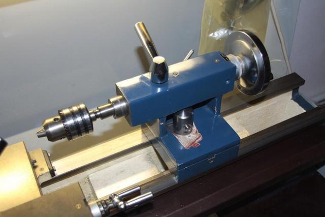

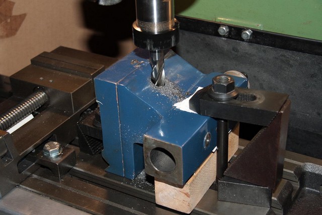

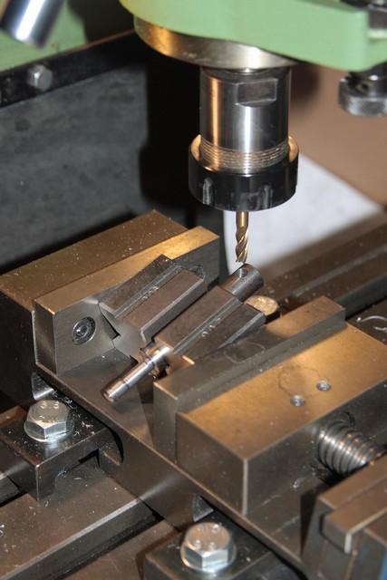

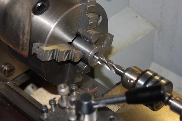

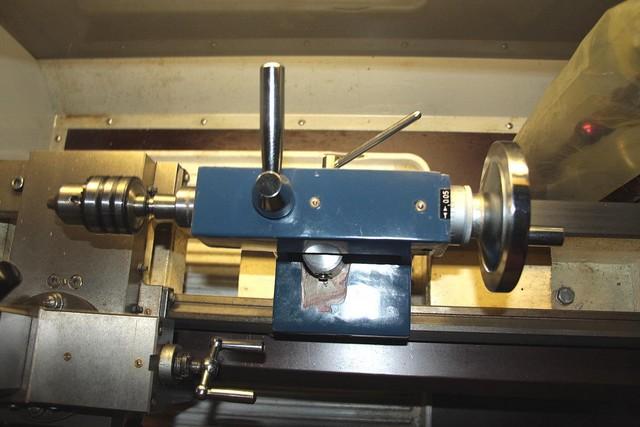

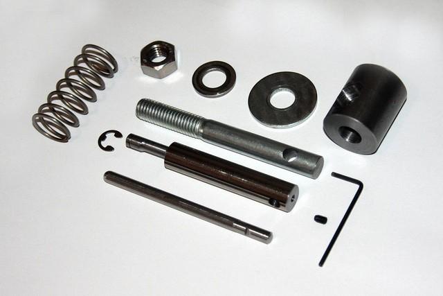

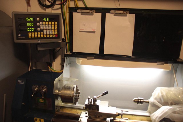

My small (table top) lathe came without CamLock, so I try to make one.

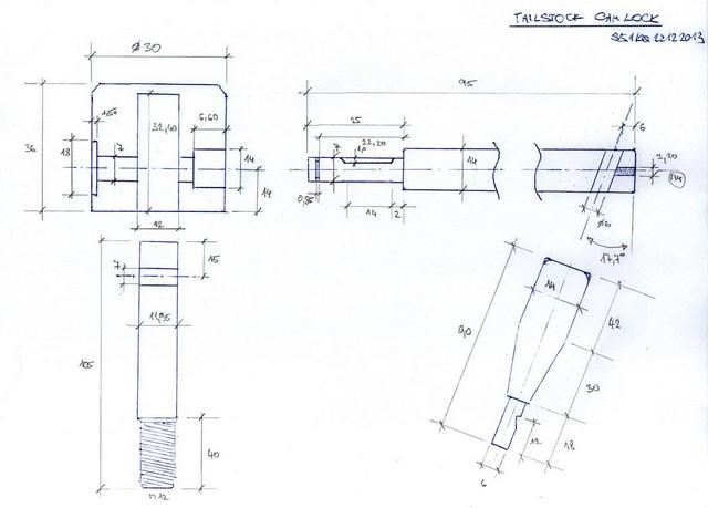

Re: Tailstock CamLock
« Reply #1 on: December 23, 2013, 07:16:25 AM »

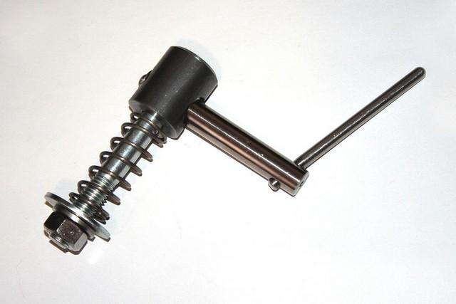

It's almost finished ...
All dimensions on schematic are in millimeters.
Mike
« Last Edit: December 23, 2013, 04:51:45 PM by dsquire »
« Reply #2 on: December 23, 2013, 09:00:28 AM »
Mike,
that's interesting and well made. I've been thinking about making one for my Compact 8, what make and model is your lathe?
Thanks for posting, regards, Matthew

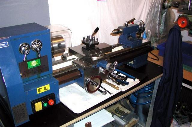

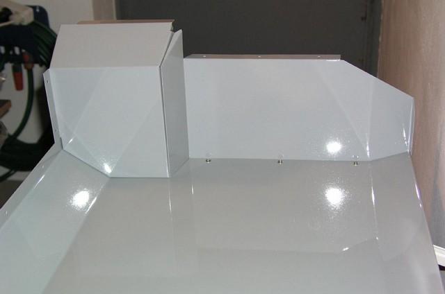

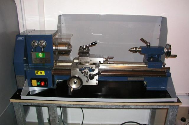

« Reply #3 on: December 23, 2013, 09:43:33 AM »
Hi Matthew,

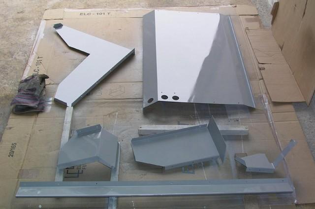

I guess it's a Chinese lathe, 108 cm long and some 200 kg of weight. Originally came with 100 mm chuck, but I made a larger plate and using now a 130 mm one. Also I've added (aluminium) sheet shield on back to limit chips flying around. A quick change tool post set was added. In the moment I'm in phase of installing DRO on.
Mike
« Last Edit: December 23, 2013, 04:56:05 PM by dsquire »

« Reply #5 on: December 23, 2013, 12:45:40 PM »
That is a BV20 probably an 1L. 9x20 in Imperial ambitions...  :D
Nice thing, more lathe than a C3 for example, but has some drawbacks according to some....
Kjelle
