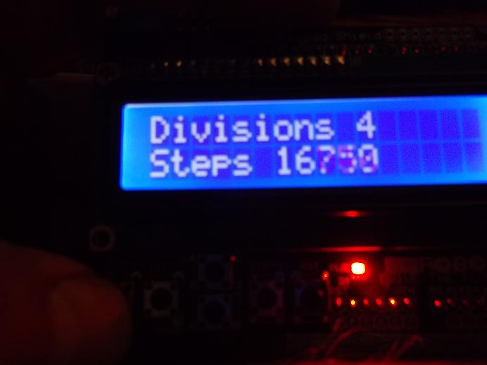

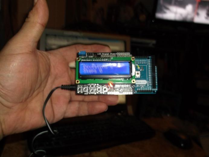

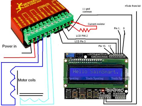

  thoughts?  I got a pair of $20 (UNO) micro controllers coming, three $12 lcd's displays with buttons made onto them, one for the one I have. Still need a Stepper drive and dc power supply, motor, gear train?? (sprockets and belts?)
  I have been doing the software for various things learning how to use them, write the programs. There are several people online running dividers, indexers with them. But most are "stingy" with the code. they want money for their work I guess?
  First two projects are definite, EDM is built, wires hanging out, capacitor bank, transformers SSR wired. I was modding it and missed out on a job recently with it.
/********************** project 1, division head, indexer ****************************
Variables in a divider head program..
Divisions of 360 degrees?
degrees to run per move,
steps per degree (for motor control, geckos have 10x micro-steps)

division head software, good enough to run.
Will do a electrical drawing in a day or so, have to go visit some folks today.
I'd sure like to learn how to address the non-violatile memory ram in a arduino.
Perhaps I will make that tonights puzzle.. to figure out.
CODE written this morning.. using drivers to drive the lcd-keypad and stepper motor.. configuration of stepper is inline with beginning of code in pins, accel, max speed.. etc..
currently 10k long, UNO I purchased has 32k ram??? (due next week) tested on a mega 2560 and lcd-keypad, no steppers tied to it.
'*********** code starts here, cut and paste into arduino ide *******

    if (millis() > endTime ) {
       lcd.clear(); // clear the display
        lcd.setCursor(0, 0);
        lcd.print("Divisions " + String(aDiv));
        lcd.setCursor(0, 1);
        lcd.print("Steps " + String(stepper.distanceToGo()));
        delay(10);
        endTime = (updateScreen + millis());

Gecko "Unkillable" vampire drive 203.. current adjustable from low to 7 amps by resistors in between the last two terminals.. I have two in my bridgeport now. The ancient 201's are now in the plastic 3d printer. THEY have excellent explanations of their drives, general principles and how to make it work in documentation on their website.
 This new style drive has "opto isolated" step and dir inputs, positive pulse, will work on a 2ms waveform.. so it will work direct connection to the arduino Uno's pins. (less current than a LED on a pin)
  I figured out the sainsmart-DF robot lcd-keypad terminals, posted a actual picture of the device and point to point terminations. HOW more simple can you get? ON the UNO arduino, pins are the same numbers on the mega I have here.
Posted is the terminal designation list on the 203 gecko drive.
Looking at Mike's divider, he may need at least a 400oz motor.. they are $65 on gecko's site.. or $35 off ebay.. beware.. the drive "power" on ebay are jokes.. they laugh, while you wonder why the motor won't pull the load.. (vacuum cleaners, air compressors, they lie about actual hp too)
'******************* cut and pasted drive information ***************
G203V TERMINAL WIRING
The G203V uses a 2-piece modular main connector. The connector is split in two pieces; terminals 1 through 6 (power supply and motor leads) and terminals 7 through 12 (control interface). Each can be removed separately by pulling the connector body upwards and off of the mating header pins on the G203V. The connectors must initially be removed to mount the G203V to a heatsink or chassis.
TERMINAL 1 Power Ground
Connect the negative (black) lead of your power supply to this terminal.
TERMINAL 2 Power (+)
Connect the positive (red) lead of your power supply to this terminal. It must be between +18VDC to +80VDC.
TERMINAL 3 Motor Phase A
Connect one end of your “Phase A” motor winding here.
TERMINAL 4 Motor Phase /A
Connect the other end of your “Phase A” motor winding here.
TERMINAL 5 Motor Phase B
Connect one end of your “Phase B” motor winding here.
TERMINAL 6 Motor Phase /B
Connect the other end of your “Phase B” motor winding here.
TERMINAL 7 Disable
This terminal will force the winding currents to zero when tied to the step and direction controller +5V.
 UNO Pin 3, LCD Shield = TERMINAL 8 Direction
Connect the DIRECTION signal to this terminal.
 UNO Pin 2, LCD shield = TERMINAL 9 Step
Connect the STEP signal to this terminal.
 UNO Pin next to 5vdc bottom LCD shield = TERMINAL 10 Common
Connect the controller’s GROUND to this terminal.
TERMINAL 11 Current Set
Connect one end of your current set resistor to this terminal.
TERMINAL 12 Current Set
Connect the other end of your current set resistor to this terminal.
POWER SUPPLY WIRING
Connect the power supply ground to term.1

I connected this to my plastic-3d printer panel sitting here in the floor. (wired a female db25 plug to a terminal strip, plugged the cable in) I was amazed, I had ran the motors, panel through Mach3 cnc software and the PC.
With the 10x multi-step resolution on the gecko 201 drives you can hardly see the motors moving. (10 x 200steps per rev) POWER is such you can't hold the gear pulley, but.. painfully slow.  Looking online, most all the 3d plastic printers use a different processor. Use 1x single step, or 2x half step polu drivers.
So I cleaned the code up some.  THE lcd "timed screen update", the lcd driver running in the back ground, had a 1 second per update, it was enough to "change the pitch" and stutter the drive when it took the time to write to the parallel screen update.  I changed the screen print to "moving" while it is in motion and abandoned the update.  I also moved the "if" statements for variable "limits" inside the Button statements where it would only be ran when data is entered and not every loop.
Possibly the "keypad button subroutine" is slowing this way down, as the F-keys used to in GW BASIC, it searched for a "Fkey" in between each line-statement.???
The simple stepper driver has a 1000 steps per second limit it says on the site.
I have been programming these Arduino's for two weeks now, some learning from everyone in the process. I felt pretty whipped at bedtime last night. I stuck the "parallel" cable back on the pc, the motors spun like 2,000rpm in Mach3.
I would not say this is a total failure, it has been a learning experience, but is pretty poor final results in two days work.
