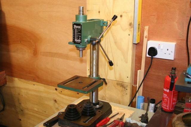

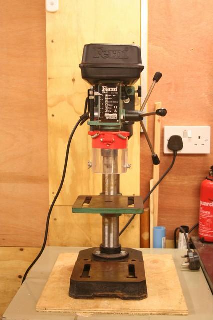

We will try to Turn a 22.5" Ferm pillar drill into a tapping stand.

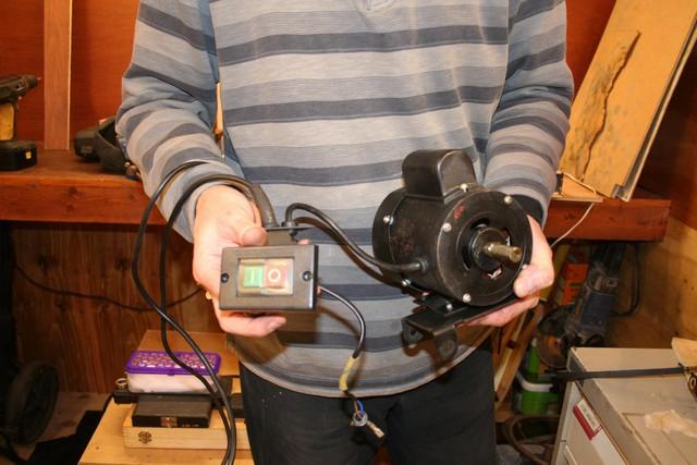

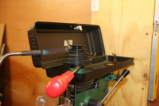

We have already take the electric's off and now struggling with taking off the front pulley, any ideas??

Look for a setscrew hidden at the bottom of one of the belt grooves.
Roy.

« Reply #2 on: December 22, 2013, 08:07:56 AM »
Yes - Already removed with Allen Key - Still tight to remove :lol:

« Reply #3 on: December 22, 2013, 08:09:23 AM »
Warm it up with a hot air gun and use a puller....generally works....

« Reply #4 on: December 22, 2013, 08:16:42 AM »
Good idea, will borrow a puller on Monday   :D

« Reply #9 on: December 22, 2013, 10:29:23 AM »
Johns Idea worked but instead of using a puller we levered it away with screwdrivers

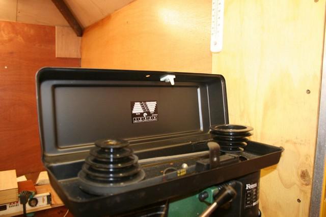

We then took away the safety shield
« Last Edit: December 24, 2013, 01:41:49 AM by dsquire »

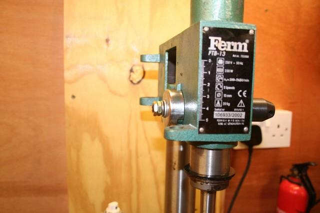

Right, so instead of using the rack and pinion we used the measurer on the front to support the chuck.  We used the bracket from the shield but first taking the Perspex off .  After we reassembled the spring mechanism on the front we realised that the spring was too strong so we are getting a new one.  That is easier to push from above.
« Last Edit: December 24, 2013, 01:49:19 AM by dsquire »

Be careful when taking out the rack and pinion however.  :doh:  :doh:  :doh:

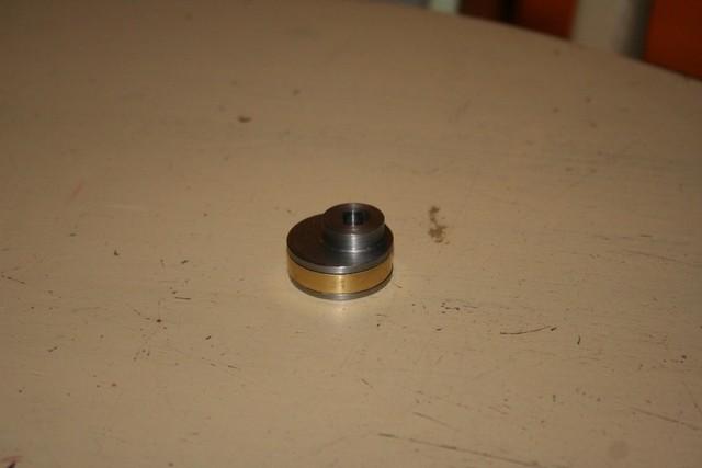

Now instead of turning our own part that drives the tap, we used the old pulley, but first we needed to adapt it by sawing off one of the grooves. We then drilled a 6mm hole and inserted a bar in the top, so you can push down and turn the tap with more force. Here is the concept in an image.  :smart: . BTW to secure the pulley back on the shaft we reused the little bolt in the side of the pulley.
« Last Edit: December 24, 2013, 01:51:48 AM by dsquire »

We then drilled a 6mm hole in the pulley
<a href="http://i1058.photobucket.com/albums/t405/Toptracks3719/004.jpg" target="_blank" rel="noopener noreferrer" class="bbc_link bbc_flash_disabled new_win">http://i1058.photobucket.com/albums/t405/Toptracks3719/004.jpg</a>
After we found 6mm for it.  Sadly, it was slightly too short we then put on the handels off the old drill for looks
<a href="http://i1058.photobucket.com/albums/t405/Toptracks3719/007.jpg" target="_blank" rel="noopener noreferrer" class="bbc_link bbc_flash_disabled new_win">http://i1058.photobucket.com/albums/t405/Toptracks3719/007.jpg</a>

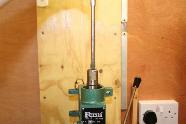

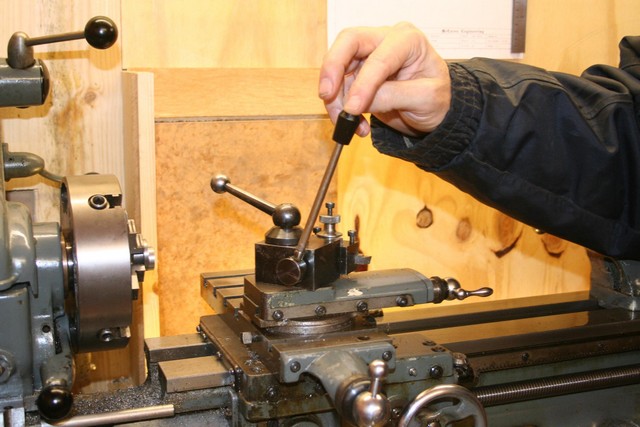

We turned down the diameter on the bar to allow us to thread it <a href="http://i1058.photobucket.com/albums/t405/Toptracks3719/002.jpg" target="_blank" rel="noopener noreferrer" class="bbc_link bbc_flash_disabled new_win">http://i1058.photobucket.com/albums/t405/Toptracks3719/002.jpg</a>.  Then we Araldited the small bar into 2 bigger bars then screwed on the handles.
<a href="http://i1058.photobucket.com/albums/t405/Toptracks3719/004-1.jpg" target="_blank" rel="noopener noreferrer" class="bbc_link bbc_flash_disabled new_win">http://i1058.photobucket.com/albums/t405/Toptracks3719/004-1.jpg</a>
Right remember how we needed a spring we got one out of a cracker and it is the right size and tension.  but first I learnt the party trick.
<a href="http://i1058.photobucket.com/albums/t405/Toptracks3719/007-1.jpg" target="_blank" rel="noopener noreferrer" class="bbc_link bbc_flash_disabled new_win">http://i1058.photobucket.com/albums/t405/Toptracks3719/007-1.jpg</a>

Now to finish we put a plastic handle on the top that can be used to apply pressure when tapping.
Then it was done, we may later paint it but not for now.  Thanks for the good support and  :mmr: :headbang:

Project Finished
