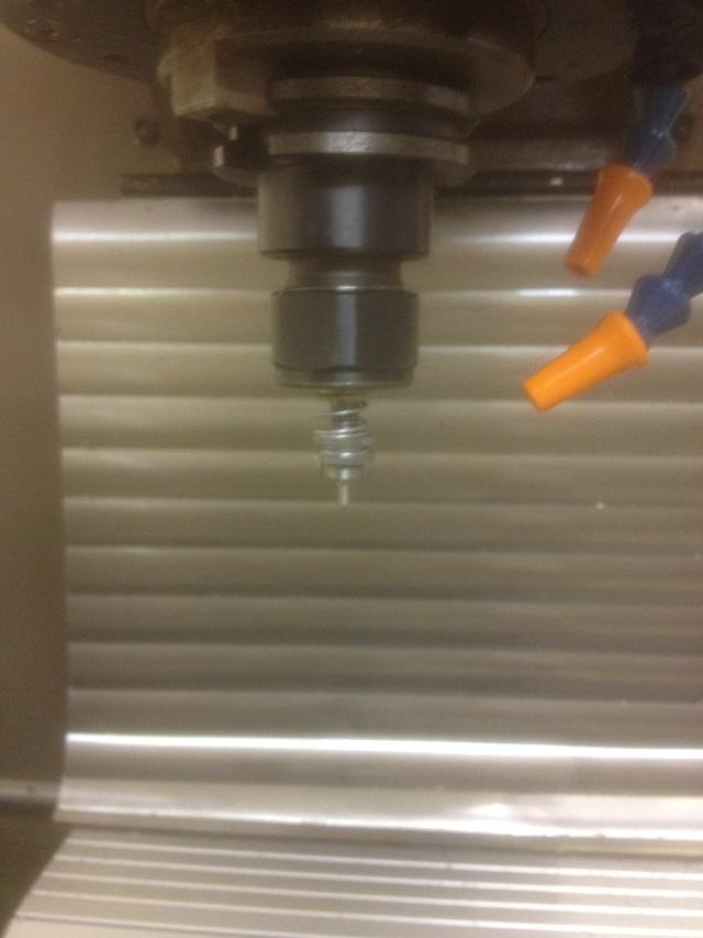

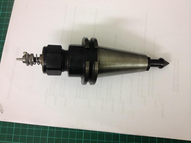

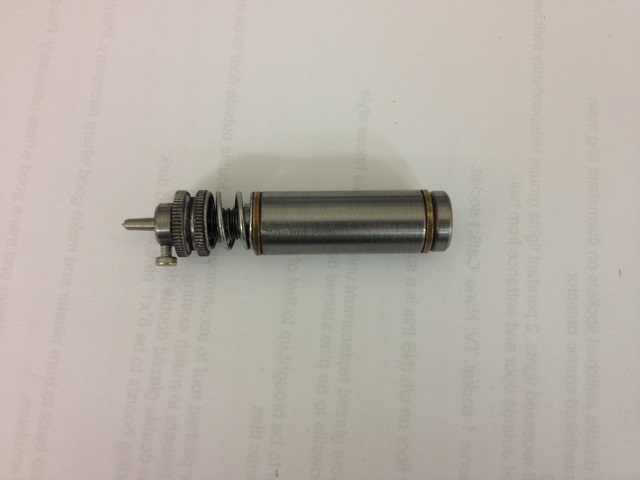

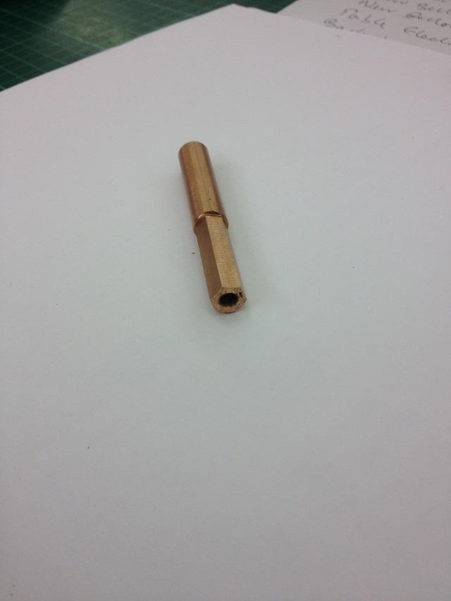

This is my take on a spring loaded 'drag engraver' for my CNC mill. Nothing particularly unique, just my take.
I wanted a co-axial design that would fit in a collet, so that it could just be one of the tools to select from the 16 way tool magazine. I made an air turbine driven engraving spindle years ago, and that can only be mounted manually as the airline needs connecting so cannot easily be part of a tool selection sequence.

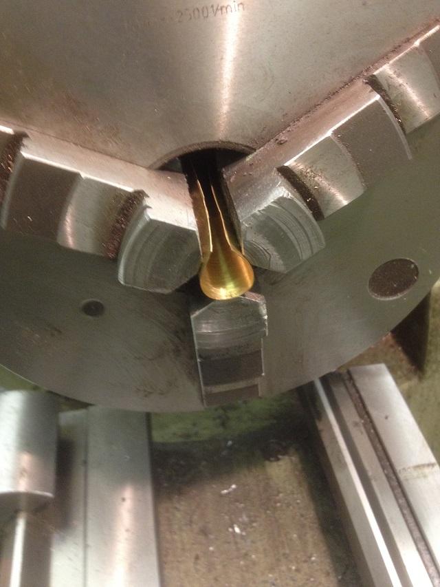

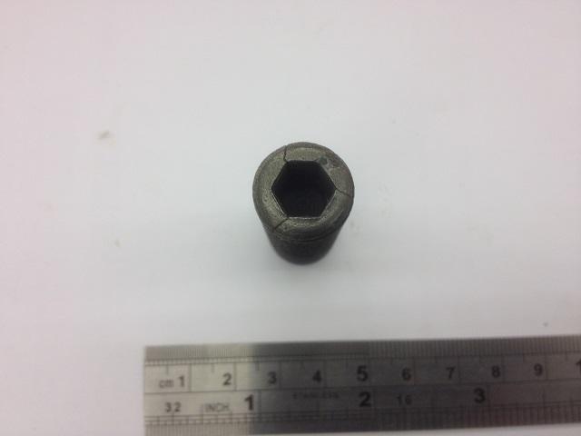

Searching around, the diamond tips sold for Dremel engravers seemed the cheapest for experimenting. they are about 1/8" and 1" long. I had some phosphor bronze 3/8" bushes left over from a project many years ago, so they were pressed into service. The housing is a piece of 5/8" re-bar turned down to 15.5 mm and bored 1/2" for the bushes. For what it is, the re-bar machined remarkably nicely.
  • Posts: 9051
Re: Diamond Drag Engraver
« Reply #1 on: December 13, 2013, 03:44:53 AM »
So how well does it work? Not bad at all for a quick cheap and cheerful projectette  :ddb:
The armature that holds the diamond point is currently mild steel, and measuring 0.373" is a '2 thou lose' in the bronze bushes. I've got some precision ground silver steel on order to replace it however with a non rotating spindle you would hardly notice it.

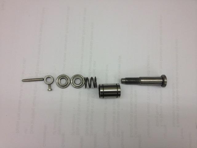

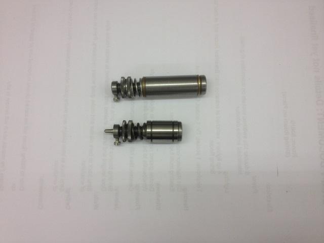

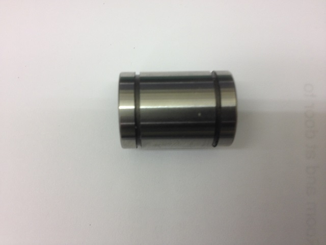

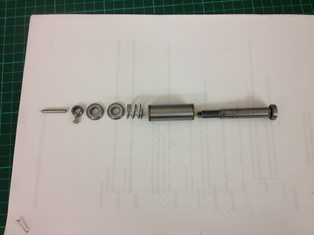

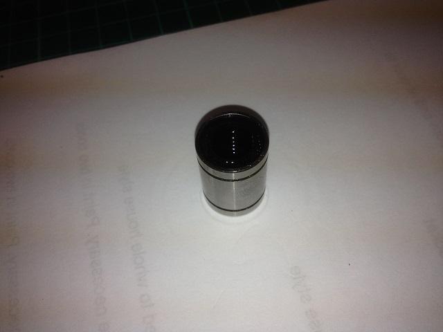

Well as intimated earlier I had an idea for reducing the side play so that fine engraving would be better. JS had suggested rectangular linear bearings but I wanted to stick with simple collet mounting. I found a 3/8" circular linear bearing sold by Marchant Dice, ordered up some 3/8" silver steel and put them together thus:
  • Posts: 9051
« Reply #16 on: December 18, 2013, 05:27:07 AM »
Compared with the Mk1 version it was somewhat shorter due to the length of the linear bearing, however as the silver steel was on the upper limit of tolerance (very marginally over 0.375 by maybe one or two tenths) there was no perceptible side play and a little pre-load on the balls in the linear bearing.
  • Posts: 9051
« Reply #17 on: December 18, 2013, 05:31:22 AM »

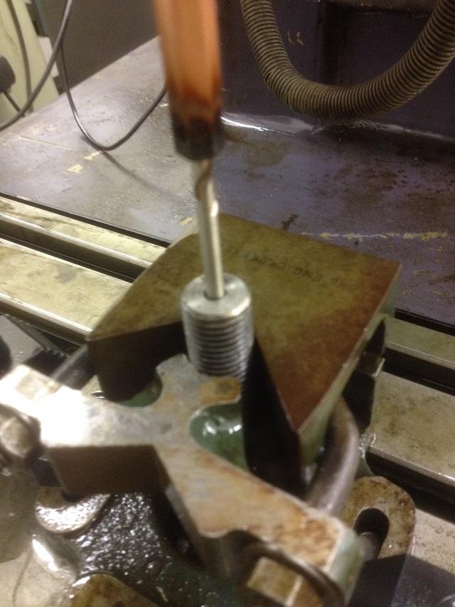

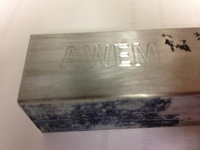

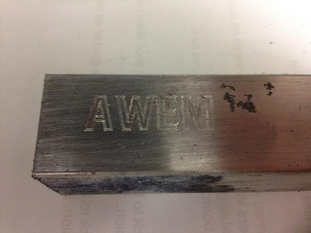

So what was the result. Well perfectly acceptable engraving  :ddb:

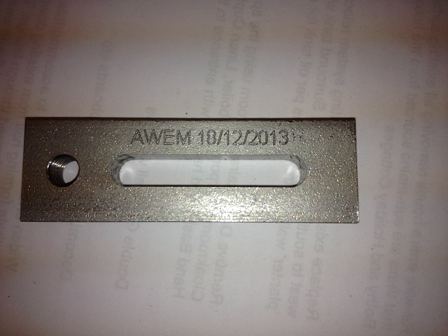

When I made up those EDM clamps from 304 stainless the other week, it was too hard to stamp with my Pryor letter stamps - I usually stamp my initials and date when I make something. Hence wanting the diamond drag engraver. So here is one finished engraved:
« Last Edit: December 18, 2013, 05:03:27 PM by awemawson »
  • Posts: 9051
« Reply #18 on: December 18, 2013, 05:36:33 AM »
That lettering is about 4mm high. While I've been typing this post the machine has engraved the other nine clamps, with me popping up and down changing bits in the vice .

Another thought is that Igus do these bearings with a polymer coating instead of balls and for short movements it's probably better than the balls which over a period of time will groove the silver steel.
I know RS do the 12mm ones, don't know what other choices are out there ?
