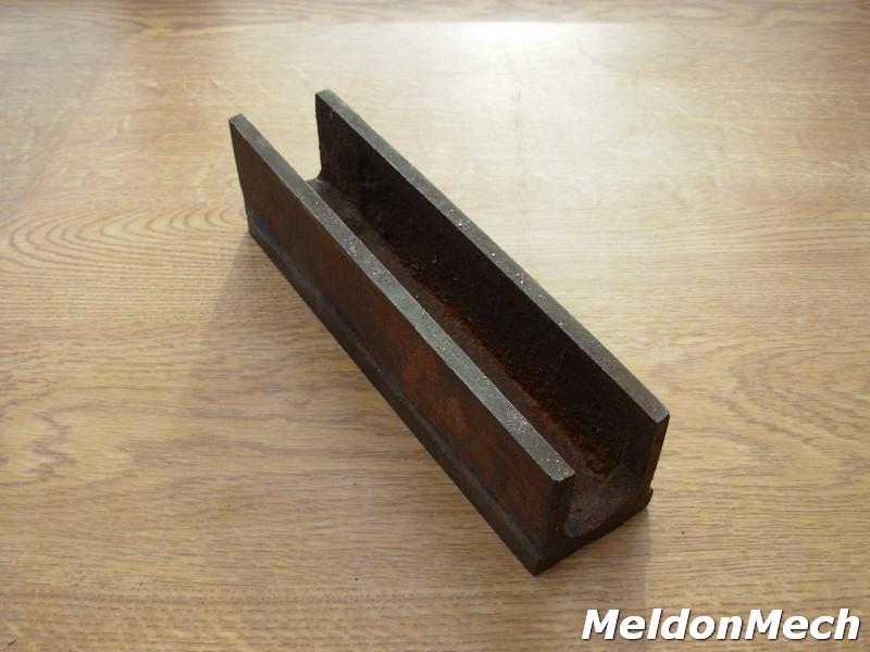

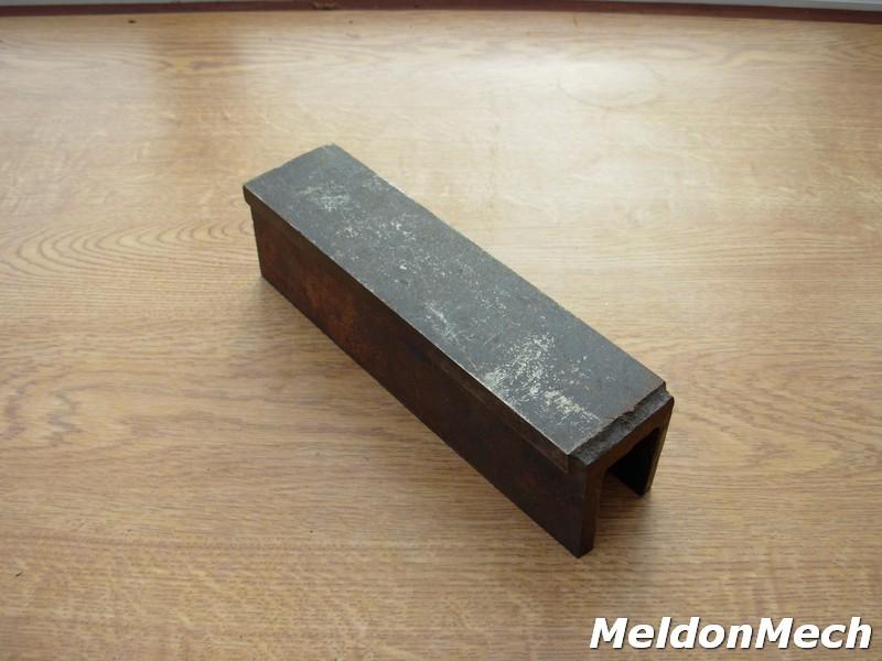

Hi Guys
               It was on a visit to a car boot sale in late summer that I noticed part of an old vice. The seller wanted a pound for it so I
  readily bought it. I knew it had potential, but had no idea what it was going to become. It was not until winter that I had   some fiddly items to hold on the milling machine, that it suddenly occurred to me, that the old vice would make an ideal small milling table.

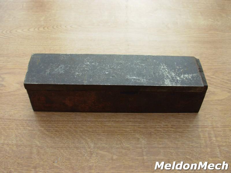

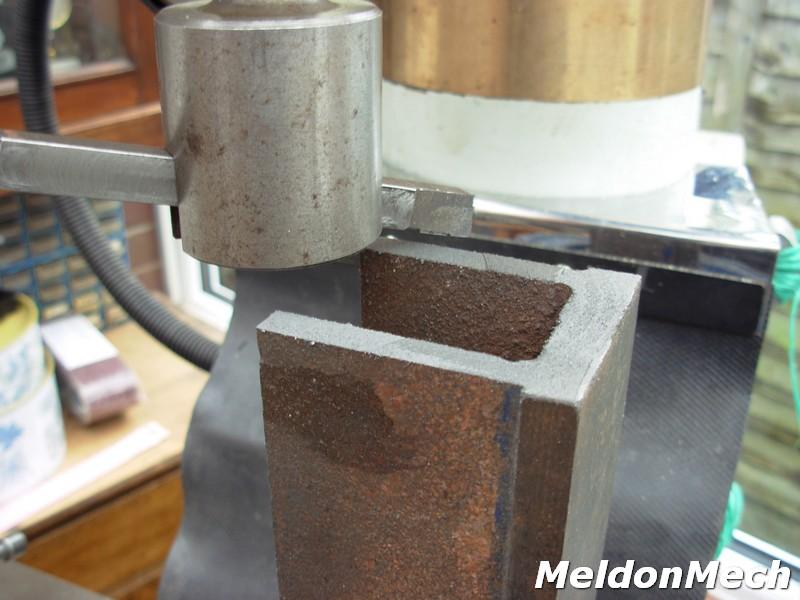

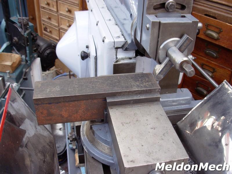

« Reply #1 on: January 23, 2014, 02:20:46 AM »
   Each end of the casting was as cast, and as sawn respectively, and needed squaring off.  So off to the shaping machine, a carbide tipped tool was fitted and the ends roughly squared.

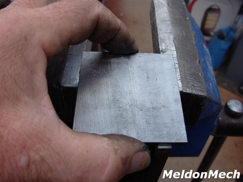

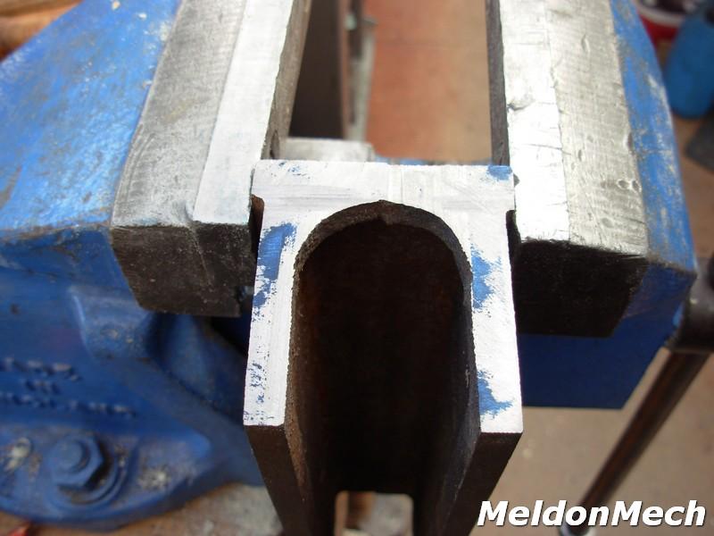

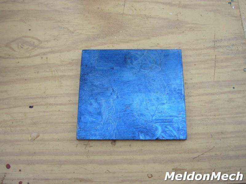

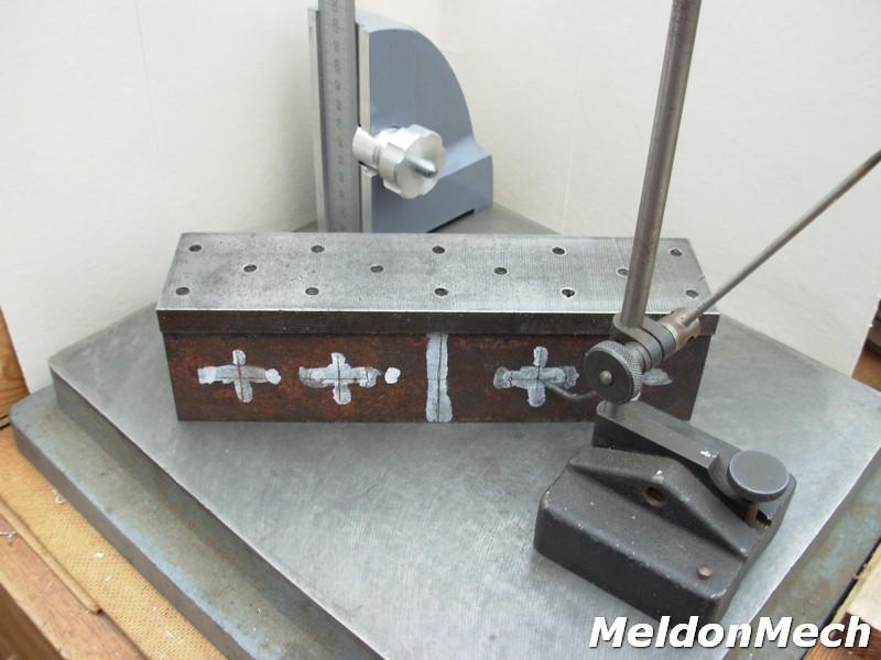

« Reply #2 on: January 23, 2014, 02:41:08 AM »
   One end of the casting was checked for squareness, and using a small blued surface plate, checked for flatness.  The high lighted blue areas were then  progressively scraped and blue rubbed until flat.

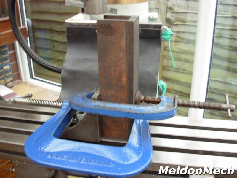

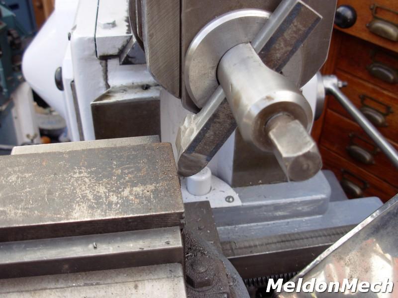

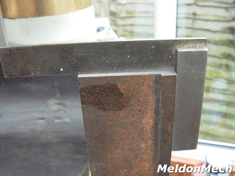

« Reply #3 on: January 23, 2014, 02:55:00 AM »
The casting was setup on the milling machine, sitting the casting down on its squared and flat end. A square angle plate was clamped to the machine bed, and the casting clamped to it ensuring squareness of the casting. The casting was then skimmed using a carbide tipped fly cutter. The end was then checked for squareness before removing from the mill.

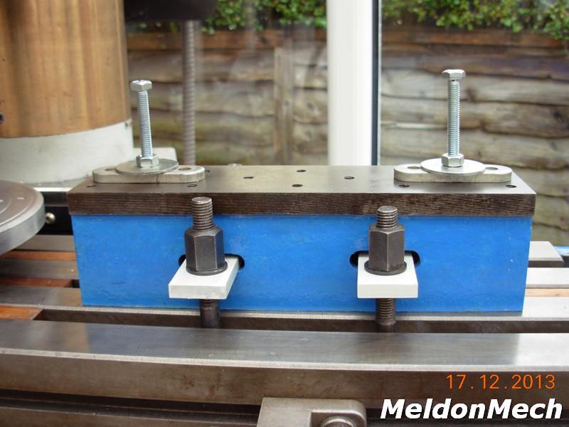

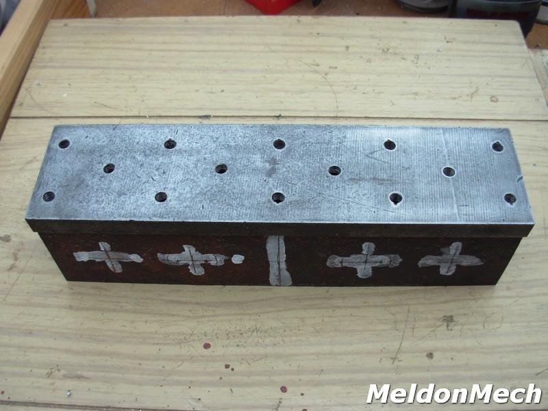

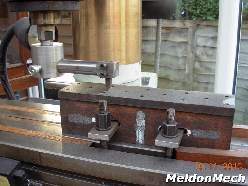

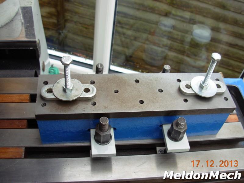

« Reply #4 on: January 23, 2014, 03:11:43 AM »
 The top face of the table was drilled and tapped M6, and the sides marked out, for table clamps. These slots were positioned to enable it to be used on both the X and Y axis of the machine. The slots were cut using a 3/8inch dia. slot drill.  The casting was clamped to the machine table and skimmed using the fly cutter.The casting was then checked with a DTI, which recorded zero movement on the dial
Re: A Small Milling Table
« Reply #5 on: January 23, 2014, 03:15:37 AM »
 The finished table has proved to be very useful, and I am pleased with the result.
                                                                                 Cheers  David
