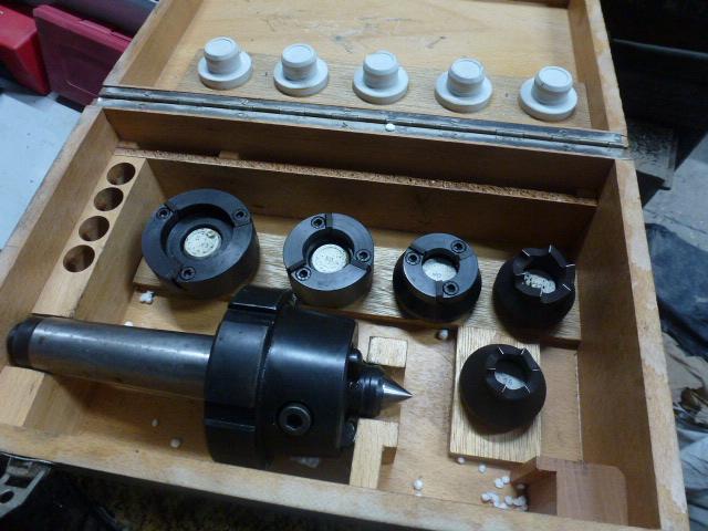

So i have seen the use of drive dogs here now and then and been thinking why isnt anyone using driving centres.. So for posterity.. i got hold of one fitting my lathe and thought i make a thread about it..
So here it is. Its my own prefered way of driving cylindrical material between centres - cause i almost lost a finger with a drive dog once upon a time long time ago and so on.

I got this set with my milling machine! I haven't used it yet as I have yet to make the morse 4 1/2 to morse 4 reduction to make it work on my lathe. Yes my Colchester has a Morse 4 1/2 spindle nose. I have a soft morse 4 to 5 that I plan to modify to be able to do some seripous turning between centres!

Strange tool to get with a milling machine if you ask me. =) but well a great way of turning a shaft not having to interupt the cut on the full length.

Actually these drivers were used for woodturning. If you look at lots of old clothes pegs they still have the marks of the driver. They save a lot of setting up by simply spiking the wood and things like catch plates, a single pointed centre and a lot of messy string. We used to use them to blank out square billets of blackwood into the round for the first stages in making Northumbrian small bagpipes.  I think that mine were made out soft No Morse taper blanks with a centre drill and offset driver.

Actually Norman, these are a little more sophisticated than the drives used in woodworking! I know what your refering to and these are not they!

            I use this type of drive for wood turning between centers, but I have not seen this metal turning drive before.  My first impression is that the set Matthew has shown, and the catalogue look very expensive, and one would need to have special production requirements to justify the cost.

Well if you can pick one up on ebay or other online auction they arent that badly priced, of course used they will need som TLC but not more than take it apart, clean resharpen the teeth on it make sure everything sticks together without play again. =)
