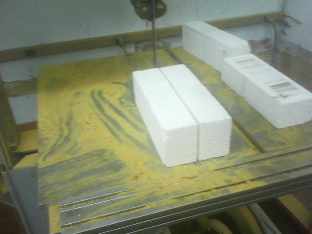

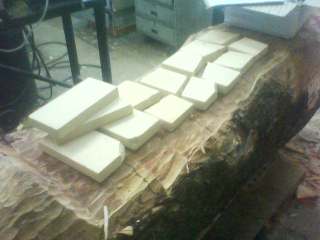

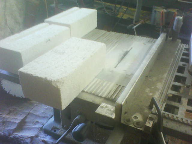

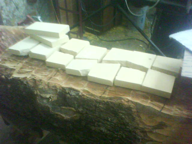

All nine bricks were damaged.  After receiving pictures of the damage
the seller replaced them.  I chose soft bricks as they were easier to cut
and  I would have more insulation.  I ordered a few more of the soft
ones and they arrived in two days.
http://www.ebay.com/itm/331060990306?ssPageName=STRK:MEWNX:IT&_trksid=p3984.m1497.l2649
I used the table saw with a diamond blade to cut the groove
for the wire.  Opened the doors and pointed the saw to the
outside.  Got a fine white abrasive dust everywhere.  Trimmed
the bricks with the band saw.  Had to be careful as they cut
as if they were not there.  The yellow dust is from and
Osage Orange tree.  The people here call it a horse apple.
Was making carving mallets.

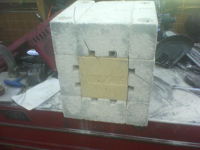

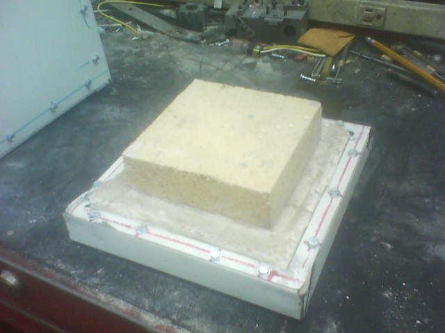

Assembled the one layer of soft brick with
a cut off hard brick as the bottom.  I thought
while putting it together that if I turned it
over I could use it as a furnace to melt aluminum.

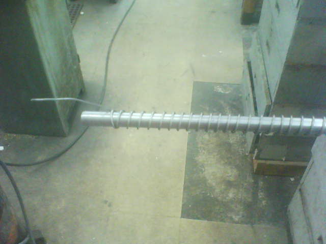

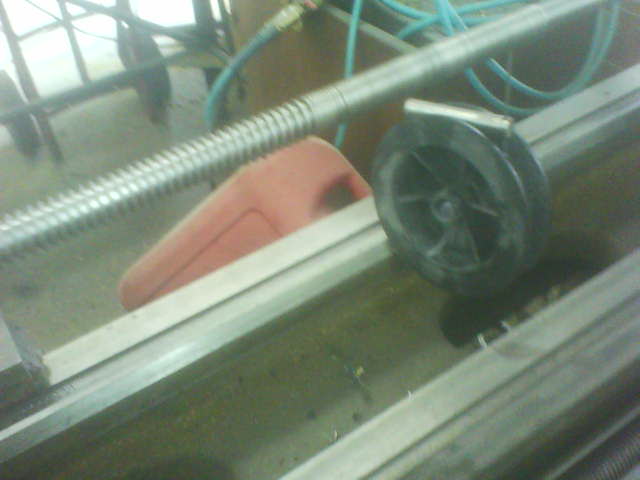

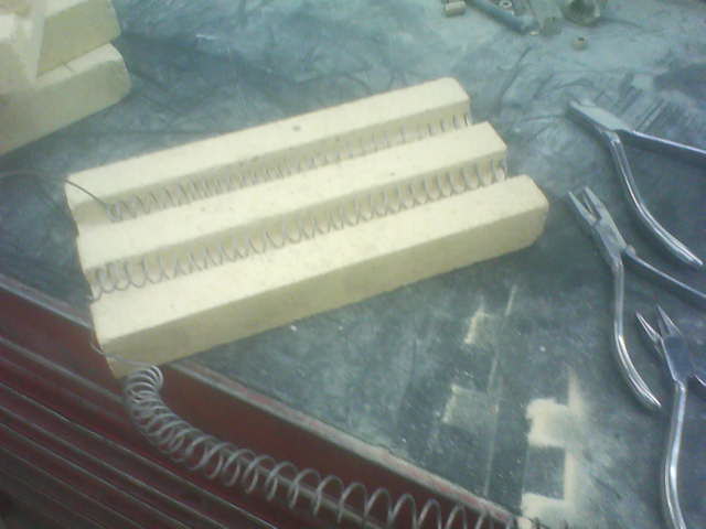

I estimated the length of the wire and wound it on the lathe
using a 7/16 bar.  It would have been easier to wind if I had
cut the wire in half but I did not think about that until I tried
to wind it from the roll.  I uncoiled it to about 3/8 between the
coils by mounting the bar in the vise and streaching the wire
over the bar.  This gave a much nicer finished coil.

I fitted the coil around the bricks.

I finished the assembly and made a covering
from some sheet metal I salvaged from a
refrigerator.  I made the door.  I used a piece
of the broken hard brick to fit into the opening.
Tapered the edges with the table saw/  I did this
so I would have more insulation at the door.
Attached it to the soft brick with cement, then set
the oven on top of it to cure the cement.

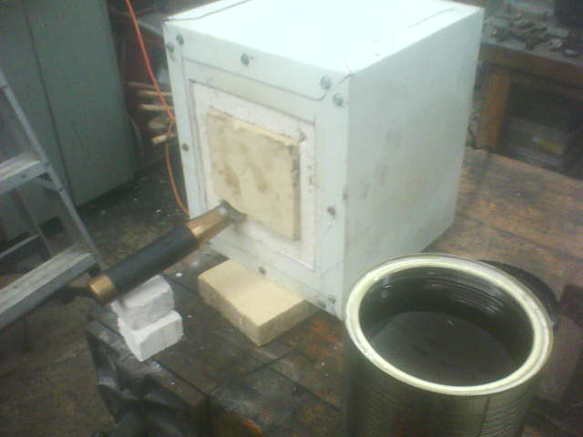

I ordered this control.
http://www.budgetcastingsupply.com/Heating-Element-Control-Basic.php

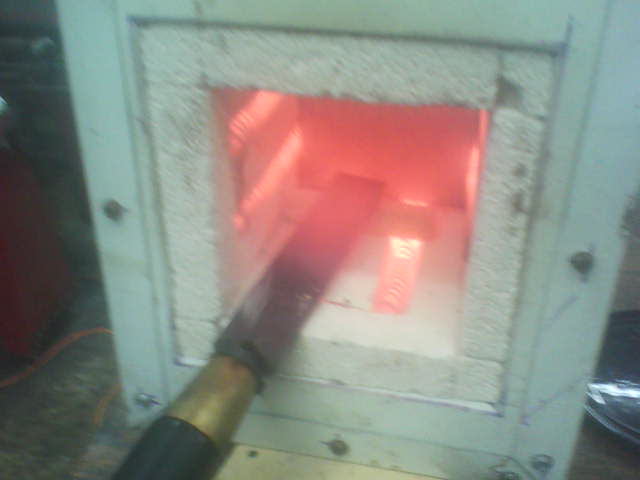

While thinking about the door attachment I did a
test heating.  I set a large chisel in the oven and
prepared a coffee can of oil.
Offline unc1esteve
  • Posts: 126
Re: Electric Heat Treating Oven
« Reply #10 on: November 09, 2013, 06:11:42 PM »
At this point I could see flaws in my theory.
Most instructions about tempering say to temper
right after the quelch.  How am I going to do that
while waiting for the oven to cool down to 400 deg.?
My idea of just a control defeats the purpose of the oven.
I thought that by watching it I could control the temperature.
So I concluded that I needed at least a pyrometer.  And two
ovens if your are going to temper soon after the heat.

« Reply #11 on: November 09, 2013, 06:32:34 PM »
It did not take long to heat up the chisel.
I decided not to quelch it as the epoxy I used
on the handle was melting.
And how was I going to correctly temper it?
Offline unc1esteve
  • Posts: 126
« Reply #12 on: November 10, 2013, 01:14:37 PM »

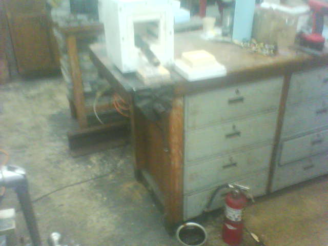

Safety
The placement of the oil next to the oven was
for illustration only.
The correct way to quelch the chisel would be to
place the oil container in front and below the oven.
This would allow one movement from the oven to the can.
Offline unc1esteve

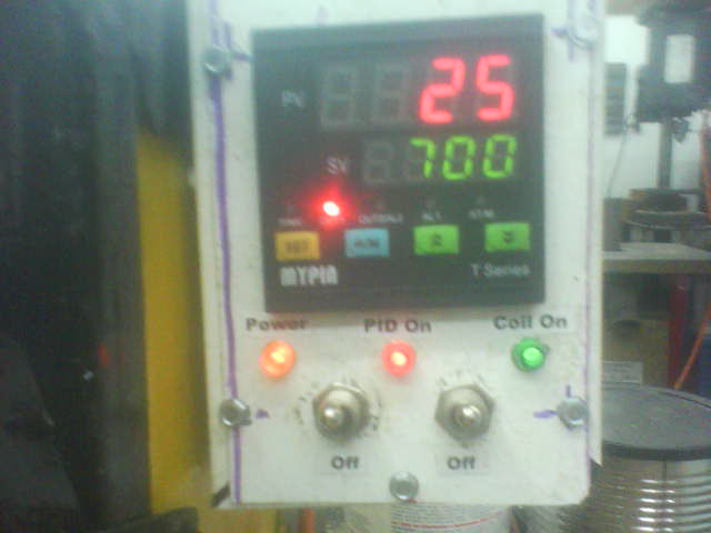

in the budget.  I decided to stay with the switch and
add a pyrometer.  I liked the analog one but found this
http://www.amazon.com/AGPtek-Digital-Thermometer-Thermocouples-50~1300%C2%B0C/dp/B0084JQLRU/ref=pd_cp_hi_3
It requires a high temperature thermocouple.

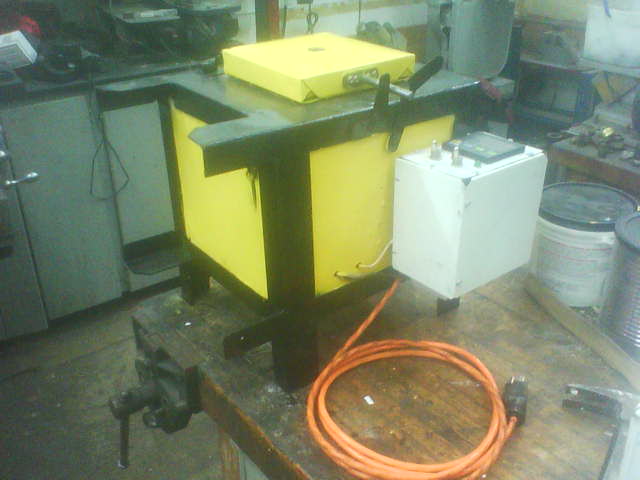

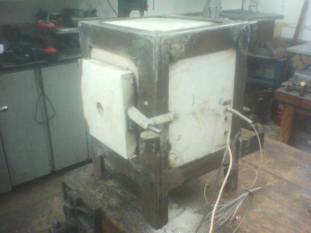

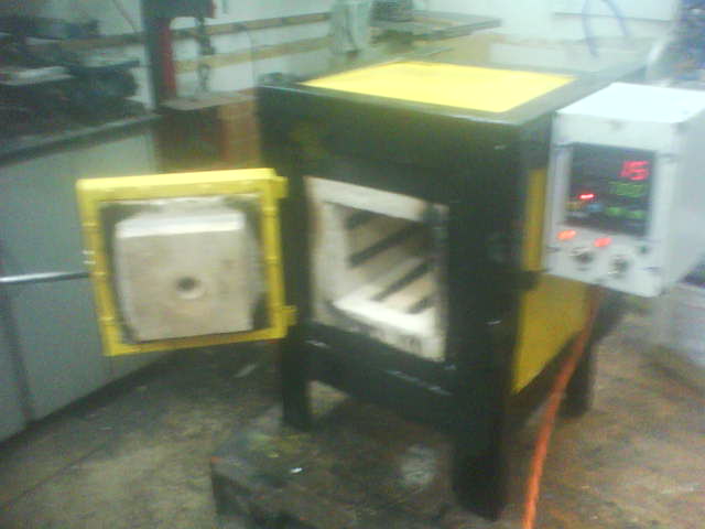

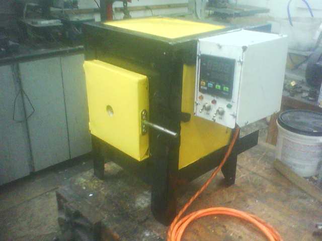

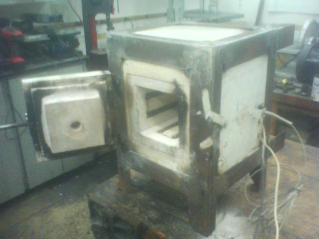

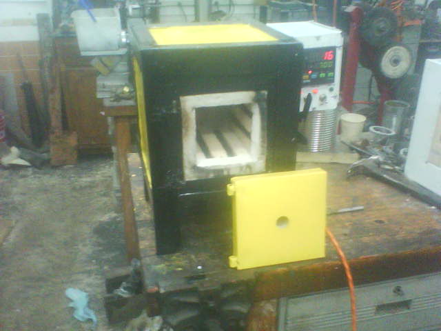

The ceramic board arrived.
I removed the sheet metal skin and

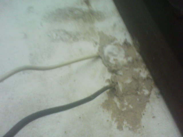

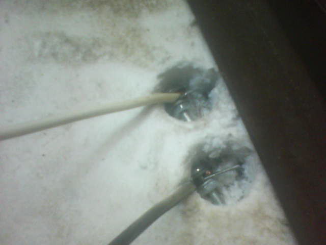

applied the board.  I ran the element wires
between the insulation brick and the board.
I connected the leads to the power supply with
small bolts and washers after testing the wire and bolts.
I re-used the sheet metal
by bending the corners back flat.
I made a ridged frame of an old bed frame.
I added legs to the back so the oven could be
used as a furnace.  Then did a test run to see
how hot the metal sides would get.  Let it heat for
about 45 minutes.  The sides were again too hot to
lay your hand upon.  But I am satisfied that no fire
will ensue.
The PID control I showed earlier was for demonstration.
It does not have the needed heat range for this oven.
Still looking for the correct controller.
As the heating coils are exposed and are electrically hot
when in use it is always a good idea to turn off the power
before entering the chamber.  As I plan on using the oven
with the door open at times I have not installed an
automatic shut off switch.

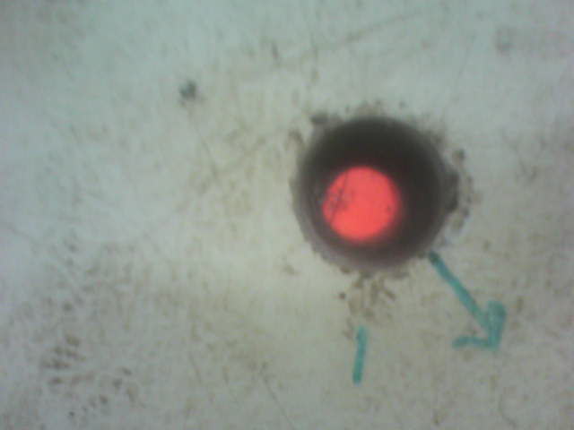

I attached the door with a removable hinge.  I also ordered
a small piece of glass for a site hole.
http://www.skylinecomponents.com/In-Stock_FusedQuartzDiscPlate.html

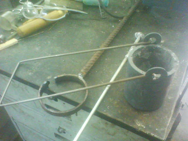

While I was doing this I thought a test firing
of aluminum would be in order.
I made a crucible of 1/4 steel pipe and a few
tools.  I collected safety equipment.  This oven
can be deceiving.  There is no harsh bellowing
noise.  There are no flames issuing forth.  It is
easy to forget how dangerous it is.
That picture of doubleboost's mate's face shield
with the brass splash on it scares me.

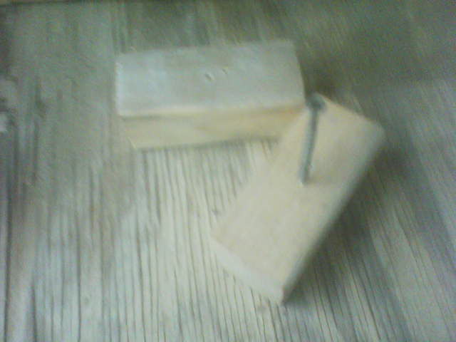

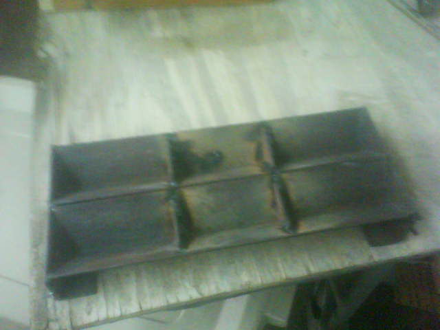

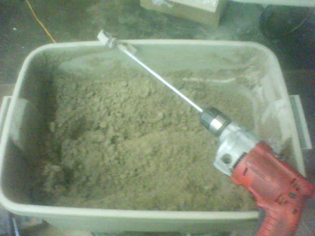

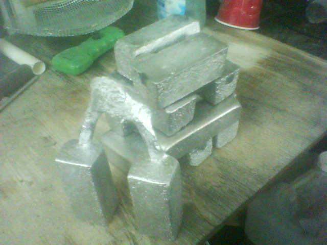

I made an ingot mold.
I purchased some bentonite clay for greensand
as I did not want to deal with oil.
http://www.ebay.com/itm/15-pounds-BENTONITE-HEALING-CLAY-Best-internal-external-DETOX-Guaranteed-/221310369189?pt=LH_DefaultDomain_0&hash=item3387203da5
I used the recommended play sand.
http://www.quikrete.com/productlines/SandPremiumPlay.asp
I used 4% water by weight.
Mixed together in small containers first.

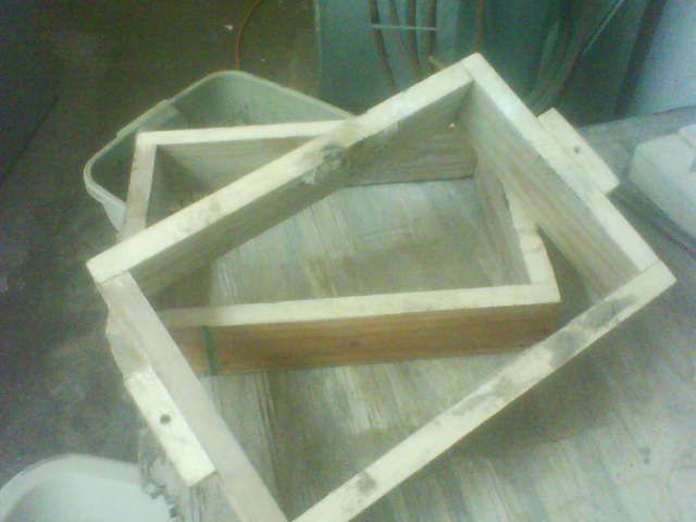

I made a pair of small flasks of wood and two ingot patterns.
I figured that this would be a good time to test things
and get used to the feel of casting as I had not done this before.

While waiting for the PID controller I made some test
ingots.  I made one change at a time to see the

This is the PID I ordered.
http://www.ebay.com/itm/161111236826?ssPageName=STRK:MEWAX:IT&_trksid=p3984.m1423.l2649
The thermocoupler.
http://www.ebay.com/itm/181187310615?ssPageName=STRK:MEWNX:IT&_trksid=p3984.m1497.l2649
And the SSR relay.
http://www.ebay.com/itm/Solid-State-Relay-SSR-25DA-25A-3-32VDC-Output-24-380V-AC-Solid-State-Module-USA-/161111607581?pt=LH_DefaultDomain_0&hash=item258300091d
I painted the oven and made a box for the controls.
I added a cut off switch for the coil so I could set the
PID without the heat on, and to open the door without
turning the power to the PID off.
The PID instructions are a little confusing.
I have it wired for 110 VAC but it could also control 220 VAC to
the coil by adding another relay.
I decided to behave like our government and pass the cost of
this project to the third and fourth generations.
« Reply #20 on: November 23, 2013, 06:57:53 AM »
          A very interesting project, detailing all the equipment and where you sourced it. Have you a total cost for the build, and have you any heating costs compared with propane.
                                                                                      Well Done  David
« Reply #21 on: November 23, 2013, 09:37:18 AM »
It looks as if you can run the oven with the door open and the power turned on;  even if by accident.
Is this so ?
Offline unc1esteve
  • Posts: 126
« Reply #22 on: November 23, 2013, 12:48:28 PM »
A final coat of paint and this project is complete.
I am satisfied, more than satisfied,  I started out
wanting a simple heat treating oven for a few small
parts.  Now I have that and more.  I did not intend
to use this as a foundry but it works well.  Precise
control over temperature if I can figure out how to
set the PID.  I have searched for pid terminology
but can not find a clear explanation of the settings.
Conclusions.
1.  I used 16 ga wire as I first wanted to use 220 VAC.  But
this works good on 110 VAC.
2.  I made the coil as long as possible.  I put the coil on all four
sides.  I wanted as much resistance as possible, more heat.
3.  The coil expands when hot.  The top coil may slip out of
position when hot.  A nichrome wire across it holds it in place.
4.  The coils are electrically charged when in use.  The expensive
ovens use glass tubes to enclose the coils.  Also safety switches.
I did not put an automatic off switch on the door.
5.  The lack of noise and great heat when being used as a furnace
makes this deceptive.  Hot and molten metal are very dangerous.
6.  My first idea of a simple switch control is not a good idea for
heat treating.  But it will work well for the furnace with a pyrometer.
7.  With the damage in shipping and a few mistakes I have almost enough
material to make a second oven.
8.  Use hard brick for the exposed areas as they will get damaged.  They
can be cut with masonry blades.
9.  PID control is good.  Make sure to match the correct temperature range
on the controller and the thermocouple.
10.  Casting Is Fun.

I made a temporary label for the control panel.  It shows
the coil switch and the indicator light.
It would be a simple matter to add safety switches and alarms.

I sorted out the problems with this controller.
On this model only the PV, the current temperature,
is able to be changed from C - F.  Everything else
remains in Celsius.  The instructions also talk about
turning on the autotune but it is always on.
The instructions are written as to assume the user
has previous experience with a PID.  No explanation
of the meaning of the terms used.

There are many PIDs out there.  They state their specifications.  I could not
find a glossary of the terms used.  I found it confusing trying to chose
a controller.  It seems that the ones sold by USA companies are more expensive
but are more USA user friendly.

After a few test runs I have noticed that the ssr relay must have a heat sink.
