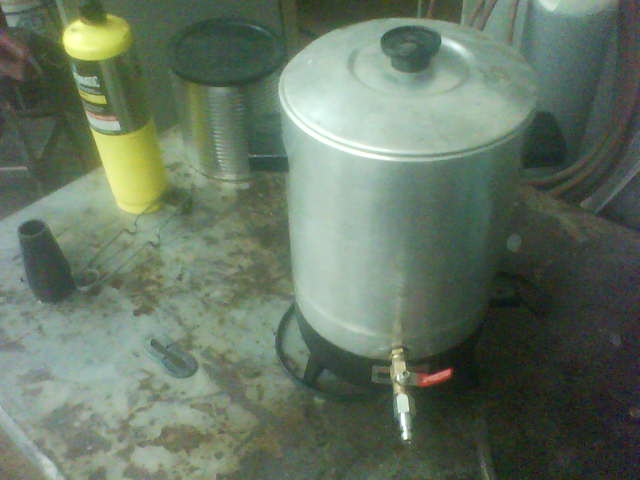

I started by collecting and filtering the oil.  I first
used a colander to remove the large particles.  Then
I used a flour sifter to remove smaller pieces.  And
then used the filter in the coffee pot.
I bought a 48 cup perculator from the thrift store.  I  removed
the valve and replaced it with a brass ball valve for a
safety shut off.  I am going to use copper tube for the
fuel line but I do not have the proper size compression fittings.
I used clear plastic tube now as I wanted to see the oil.  The pot
heats the oil very well.  I removed one of the heating coils because
I felt the oil was getting too hot.
The oil must be heated for the burner to light.  This includes the
oil in the fuel line.  Before lighting I drain the cold oil out of the
line and make sure hot oil is right up to the burner.  The pot
will be well away from the furnace in use.  It will have a drain
valve right at the burner.

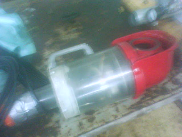

A broken upright vacuum provided all the parts for a 2 inch blower.

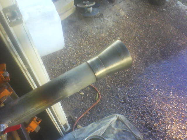

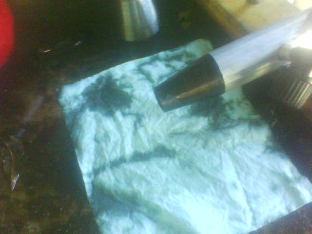

I made the first nozzle from a cap instead of a plug.  I thought
that the 3/32 hole was not the correct length, too short.  I made
another nozzle with a longer hole but it made no difference.

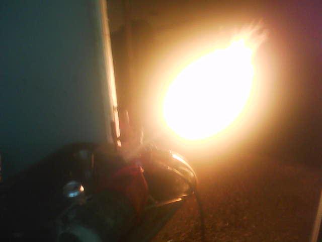

It seems the only adjustment that affects the flame is the distance the
nozzle is from the mig tip as vtsteam mentioned.
I made a venturi and a flare.  The flare makes no difference
at either end of the burner.  If fitted at the flame end the venturi
speeds up the air flow but puts out the flame.  Fitted at the other
end it restricks the air flow but makes a definite improvement
in the flame and the heat.

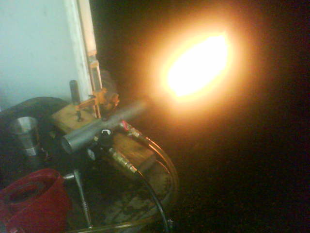

The burner will not work with the vacuum blower.  If I blow a hard
breath into the burner it will flame out.  I am going to let the flame burn
on a large piece of steel and see if it will burn more oil.  If it does
I will try the blower again.  Need to move this operation outside.
Once the nozzle is set this thing is a monster.  I have no doubt
it will melt case iron.
It is easy to build and I would recommend it to any one that has
a supply of waste oil.

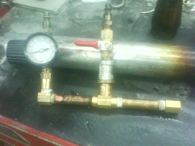

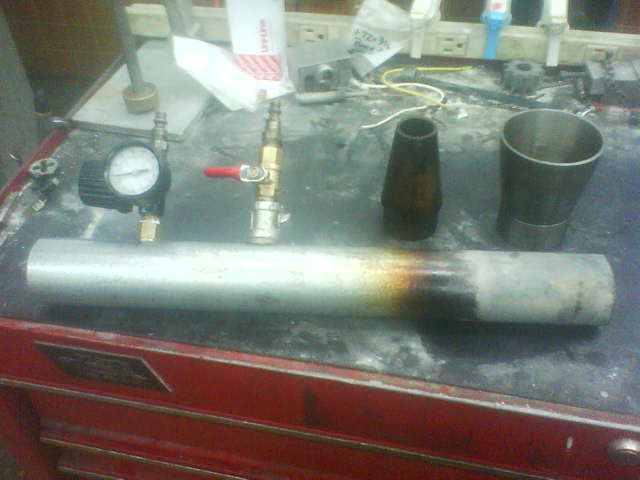

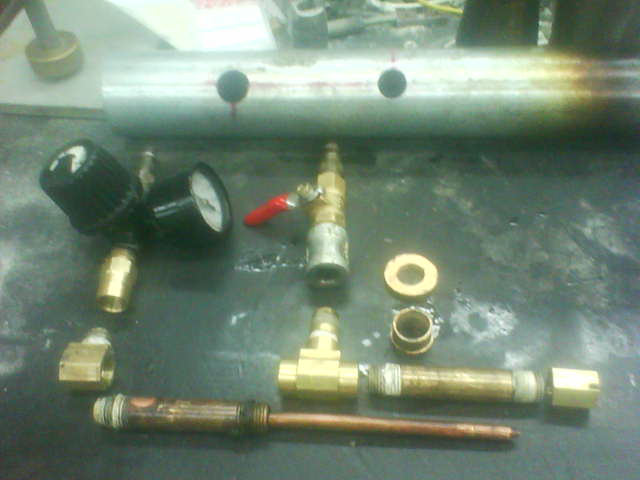

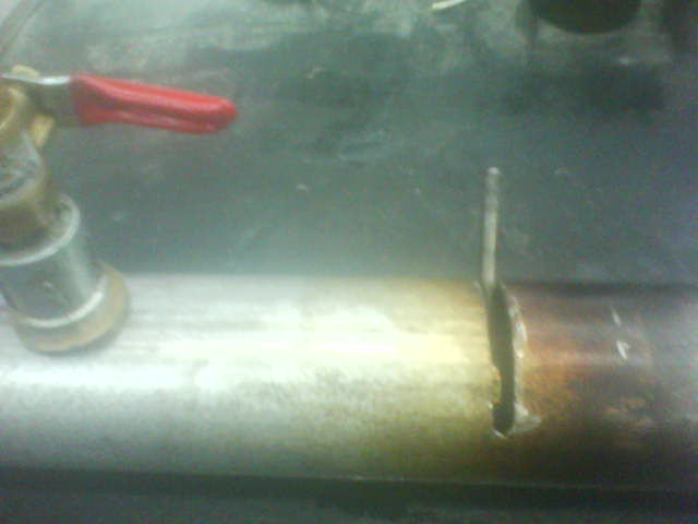

I have been adjusting the nozzle with a socket and an extension
in between burns.  I decided to take it apart and make an
adjustable handle so the nozzle could be positioned while burning.
The tubing is held to the outer burner tube by the coupling at
the oil line,  A collar and a washer provide the correct spacing.
The mig tip is hard soldered to a 1/4 tubing.  At the other end the
tubing is placed inside a collar , swedged and then hard soldered
to the 1/4 nipple.  This added room for the oil improves the
burner performance.  There does not seem to be very much siphon
power.  The outer burner tube is 16 in length.  The nozzle
is 5 1/2 from the end of the tube.  I do not know if these dimensions
are critical.  I wonder if changing the oil hole size would help with
the drip?
I used a 3/16 dia rod for the adjustment handle.  I machined a
groove about one third of the tube diameter.  As I had made another
nozzle with a deeper 3/32 hole I used it for this purpose.  I threaded
6 holes around it as I did not know the correct position when assembled.
