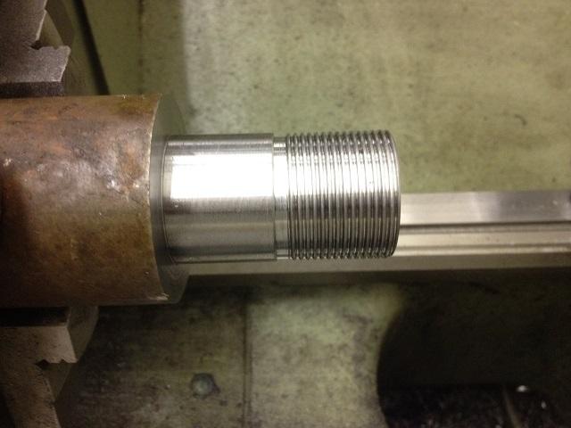

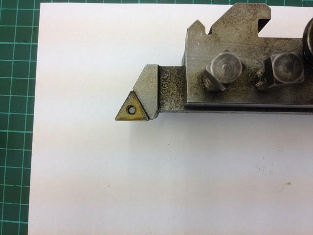

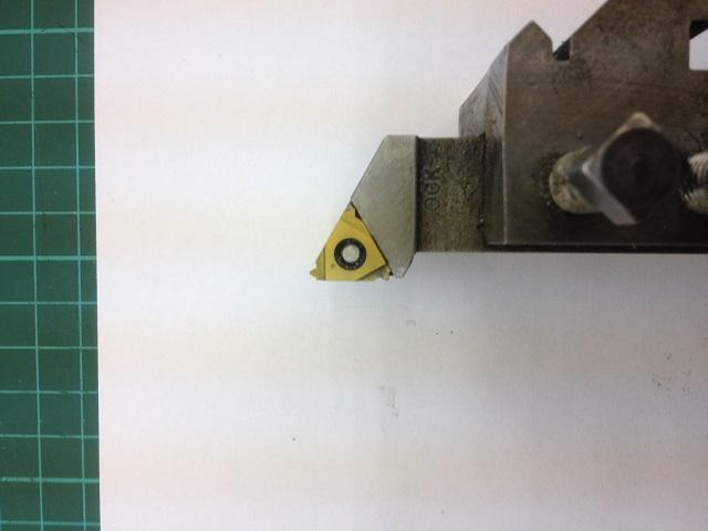

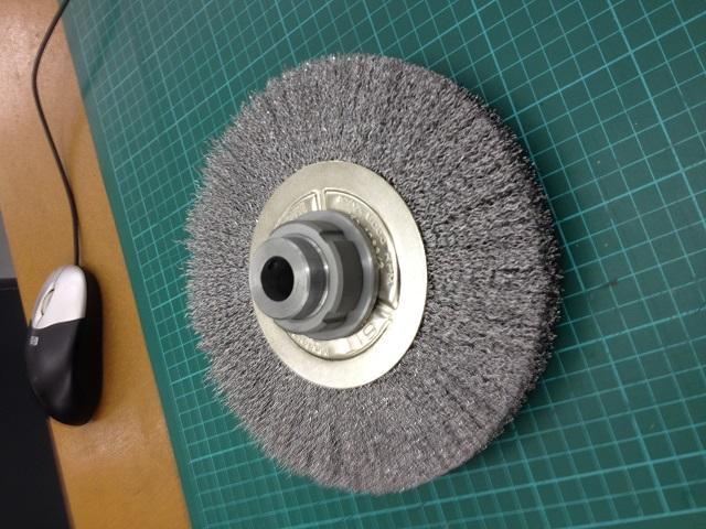

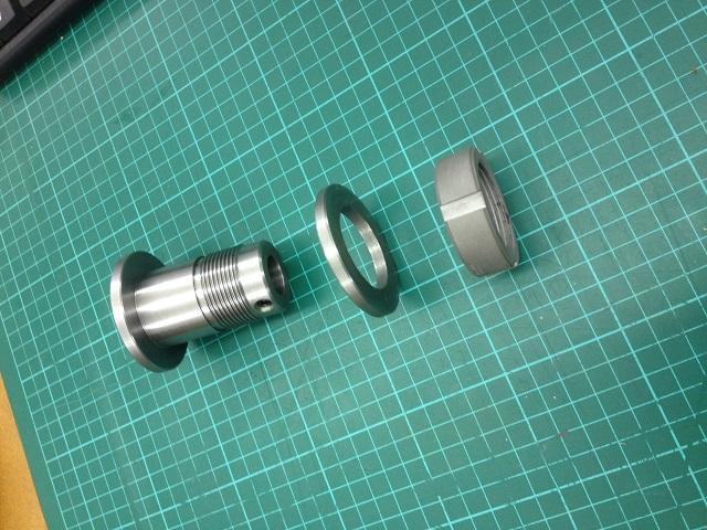

Today's task was to make an adaptor to mount a large wire wheel brush on the spindle of my buffer. Simple turning and threading exercise. Bore of wire wheel brush 38 mm, diameter of shaft of buffer 19 mm so make a bush clampy screwy thing ! Started by turning down a piece of 60 mm bar to the 38 mm required. Then thread the end an arbitrary thread size for which I need to make a nut.

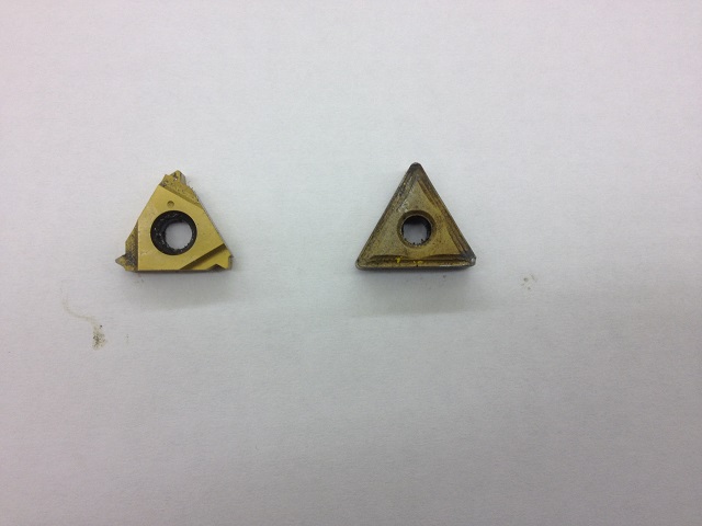

I decided on 2 mm pitch as I had an internal 2 mm threading insert that fits my boring bar, and had just bought various external threading inserts for the Traub including a 2 mm one. OK set the lathe for 2 mm pitch, and decide how to mount the external 2 mm insert, as I don't have the correct threading holder. Well looking at the insert and comparing with a TNMG insert the overall size is the same. Will it fit?

Well they seem to be the same overall shape and fit on the holder

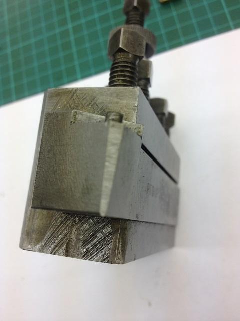

So I fit the tool holder to the lathe, carfully adjust centre height, and try to check that there's clearance under the tip (a clue here !)
And off we go threading. total depth of cut for a 2.0 mm thread is 1.2269 mm, so slice by slice we produce what starts off as a nice thread form, but at about 1.1 mm deep oh heck why's that thread so manky? A very careful look at the holder shows it's rubbing the work below the insert despite my having checked earlier, and we are so close to finished depth it's too late to sort things out. Anyway decide to carry on having truncated the tip of the holder to produce an under diameter thread as after all I'm making the nut to suit.
  • Posts: 9154
Re: It's the little things that catch you !
« Reply #3 on: October 25, 2013, 11:04:53 AM »
Then it dawns on me - the DRO is set up for diameter measurements so is only showing HALF depth of cut - we've a further 1.2269 to go - loads of room to clean up the mess.
So one error, compensated by another error ends up with a workable solution

don't those threading inserts have a carbide shim under them to set up the helix angle ?
the proper ones that I have do have a shim that need to be changed for different thread pitches
it improper ones from the far east nee chronos RDG do not have the shim

There should be a shim to give more support to the insert, but I think (may be wrong) that the helix angle is inbuilt to the insert

It's an interesting point Stuart that I've previously not looked into. This is what Sandvik have to say:
http://www.sandvik.coromant.com/en-gb/knowledge/threading/thread_turning/insert_clearance_angles/pages/default.aspx
But oddly tool dealers like shop-apt.co.uk where I get my inserts only stock one shim for the whole range
http://www.shop-apt.co.uk/shims-seats/tne16-shim-seat-for-apt-ser-16er-threading-tool.html

« Reply #8 on: October 25, 2013, 01:56:28 PM »
sandvik tells the same as greenwood but call it flank clearance
as usual its a mine field and it depend where you look for the info i would believe the chip manufacture rather than the dealers

I've got less knowledge for sure, and not a dealer, but this kind of came up for me last threading I did -- not with an insert, but a ground HSS tool.
Technically, the clearance angle is variable depending on the pitch and diameter -- the helix angle -- if you want an ideal clearance. But you can also grind in what is an excessive clearance angle, as long as what's left is strong enough to handle the forces and material. Then the tool can be used for a wider range including lesser pitches or wider diameters. It will wear faster however. So maybe that's what the more "universal" inserts do as opposed to those that use wedges, or have a specified low range of helix angle.

One other thought. If you have variable shims for an insert you are slightly altering the thread profile. Obviously that must be an acceptably small amount, since they supply them. But it must occur to some degree in that type. The tools that don't use shims can have an ideal profile, but probably overdo the clearance for most threading in their range.
Or do I have that backwards? Is the ideal thread profile normal to the axis of the part, or normal to the helix angle? I assumed it was normal to the axis.

I >think< I've sussed it.
If you look at the chart in the Sandvik link I posted above, the vast majority of threads fall in the 'needing 1 degree' category so the 1 degree supplied shim is right in virtually all 'normal' threads, so  this is why most dealers only supply that shim. Sets of other inclination shims are available at significant cost  but rarely needed.

Well it all turned out ok in the end  :ddb:

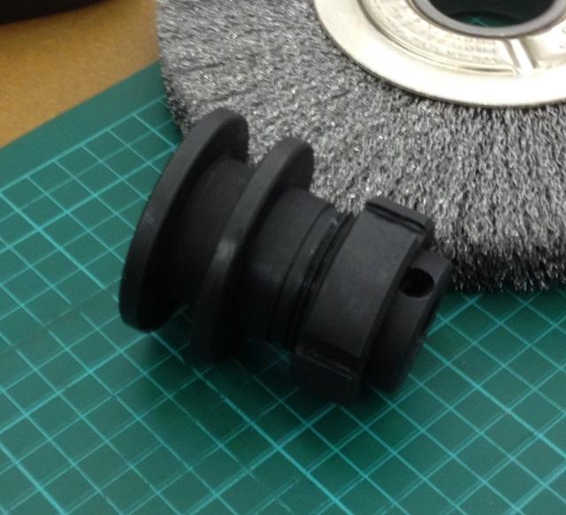

This morning I finished off the nut
  • Posts: 9154
« Reply #14 on: October 27, 2013, 08:21:05 AM »

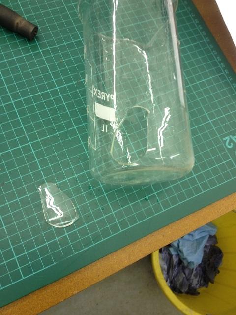

I decided to continue an experiment started seven years ago and never finished due to my move. I had heard that hot photographic 'fixer' works as a good durable blacking agent, I bought some, tried it on some bits of scrap and then packed it up and moved house!
So digging the rather fly blown bottle out I set up this blacking rig

I still had some of the original fixer that I'd diluted about 1:3 which had light yellow flocculations in it. Oh well I thought lets do another test with it.
I sand blasted a bit of scrap, and popped it in having warmed the solution to 75 deg C and sure enough a nice black finish. So I carried on and blacked the rest, and wiped them down with Shell Ensis rust proofing oil

Now it's important to stir the solution, so I had the bits suspended on some iron wire and was jiggling them. The last part to do was the nut, jiggle jiggle,  :bang: CRACK  :bang:
I'd knocked the side out of the beaker - quite a neat hole! A gush of the diluted fixer shot out, over my lab coat and jeans leg onto the floor.
Tell us more about this experiment, it looks interesting. How long did it take and how resistant is it?

I can't remember where or how I heard about fixer acting as a blacking agent. Probably a bit of web trawling by me years ago. I don't know if the blacking is a deposit, or if it converts the surface layer of the steel.
I did try a rub with one of those pan cleaning pads and it stood up to that ok - I wasn't going mad at it as I wanted the finish ON!
With that electric hob, and a pyrex beaker that was too small for it I could only get the solution up to 75 deg C and seem to remember it should be almost but not quite boiling. However it works ok at 75 and dangling the part in it blackened within a minute. No doubt the longer it's in the thicker the black is.
The other thing I have no idea about is it rustproofness (if that's a word) which is why after drying thoroughly under an electric hand dryer I rubbed Shell Ensis rust preserving oil  on the parts.
Considering what happened to the beaker I'm glad I hadn't got it up to nearly 100 deg C as that'd be a lot morec energy to dissipate down my jeans  :lol:
