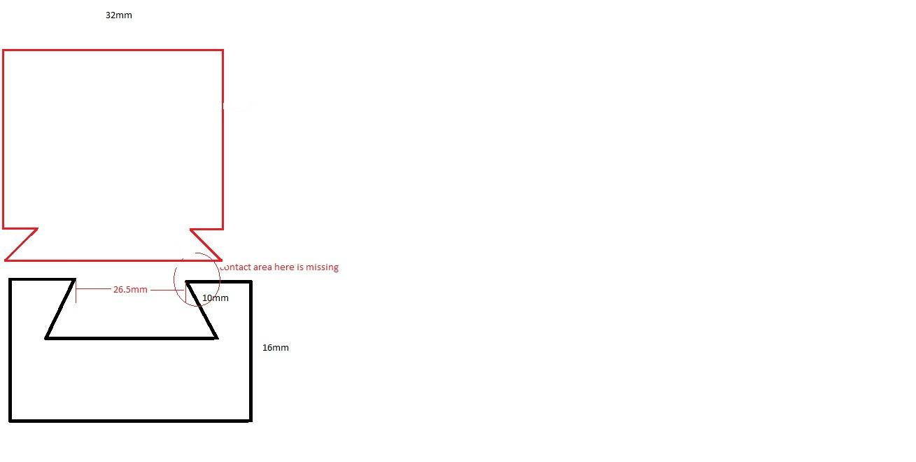

Looks like there should be about 5mm of metal there. Is that what you have?
(nope, that's wrong..........hang on, checking....)
I make it out to 5.38 mm.  If your piece width is under 50mm it will reduce that.
Do you have 10 mm at the top of the dovetail?

« Reply #2 on: October 25, 2013, 04:33:15 AM »
ok,
Here's a crap-o-cad sketch of how it's fitting together.....and how it doesnt work out....
Basically if I offer up the lower slide and insert it into the swivel block, the side where the gib strip goes has virtually no landing area supporting the lower slide

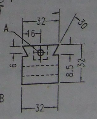

John, I have the book, too. Can you check these dimensions on your part?

Also, John,
The lower slide dovetail appears to be 8.5 mm deep. (it would be easy to misread the tiny dwg and make them 6mm deep)
The slide swivel pieces appear to be 8mm deep.
I'm having a hard time visualizing the finished assembly, even with the assembly drawing, but it seems like the dovetails would therefore ride on the bottom rather than the shoulders.

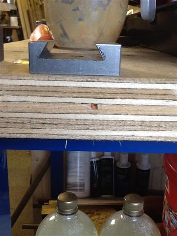

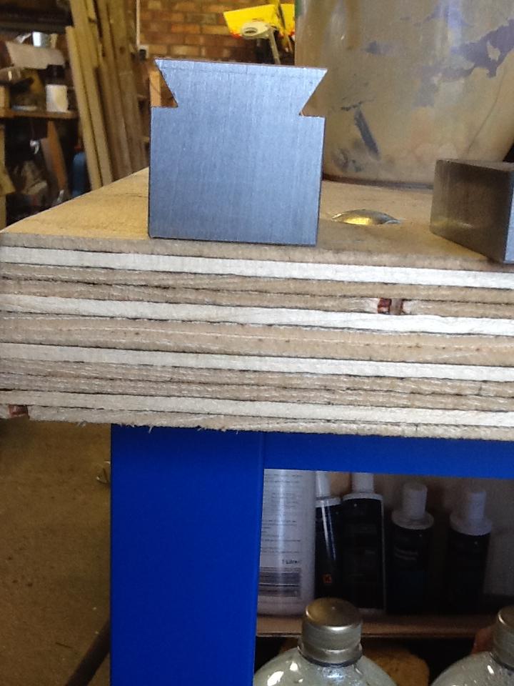

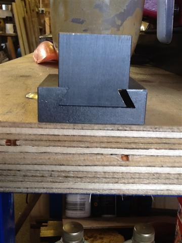

« Reply #11 on: October 27, 2013, 11:13:58 AM »
Right, here's a few shots of what I'm trying to do.......
Chuck some of your fotos would be good for comparison please......
As can be seen from the second foto, not much support on the right where the gib goes.....

« Reply #12 on: October 27, 2013, 11:35:01 AM »
John, as I said before, shouldn't it be that the dovetail (male part) should be riding on the bottom, not the shoulder? Therefore zero support there -- instead there should be vertical clearance, and the shoulder width is irrelevant.
According to the drawing, the male part is 8.5 mm  deep, while the female part is 8 mm deep. Or have I got that wrong?

« Reply #14 on: October 27, 2013, 12:06:13 PM »

« Reply #15 on: October 27, 2013, 12:11:01 PM »
Could be a mistake on the drawing, or could be intentional.
It's possible that on a small dovetail like this the intent was to ride on the bottom since it was likely it would be clamped a lot, ant that would give better clamping area - resistance.

  • Posts: 6835
Re: HH. Grinding rest
« Reply #19 on: October 27, 2013, 01:56:27 PM »

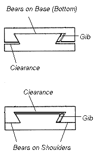

Here are the relevant dwg details, so people can stop guessing. And in the photo above it looks as if, yes the dovetail is not intended to ride on the shoulder, but on the bottom (or top, depending on which slide you are referring to -- there are 2, and in opposite orientations).
John, it looks like you may have reversed the 8 and 8.5mm depths, since yours doesn't seat on the bottom.

It doesn't make any difference whether he sets it upside up or upside down on a workbench for the purpose of a photograph. We're talking about a fit of two parts.
Yes a gib ALWAYS forces a dovetail to contact the opposite slope, AND either the shoulders OR the bottom of the slot, depending on the intent of the designer. In this case, according to the drawings, it's the bottom. In the case of most dovetail slides on the lathes I have seen, it's on the shoulder.
For most dovetails, using the shoulders as bearing surfaces reduces friction when sliding. Using the bottom (or base) of the dovetail increases friction, but that may be an advantage where you intend to lock a short part into its ways.

« Reply #24 on: October 27, 2013, 06:30:54 PM »
I have over the years had a number of questions regarding the grinding rest that result from the very small scale of the assembly drawing in the book. Because of this, I added to my website some time back an enlarged assembly drawing of the top half of the rest. This can be found at http://www.homews.co.uk/page145.html. The link being in the bottom line of the text.
If there is any one reading this thread that are unaware of my website the home page is at http://www.homews.co.uk/index.html but the best place to start for the metalworking content (now around 500 pages)  is at the book style index at http://www.homews.co.uk/page463.html
Also, I have started to add galleries showing a number of setups for a given situation, typically, Using the faceplate. The index for these is at http://www.homews.co.uk/page542.html there are though a lot more to come.
I would add that I have already mailed John directly with some help and telling him about the larger drawing which should answer his questions.
