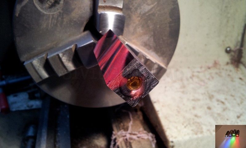

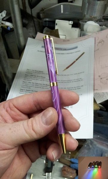

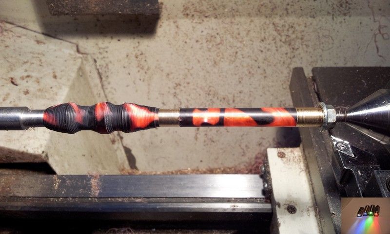

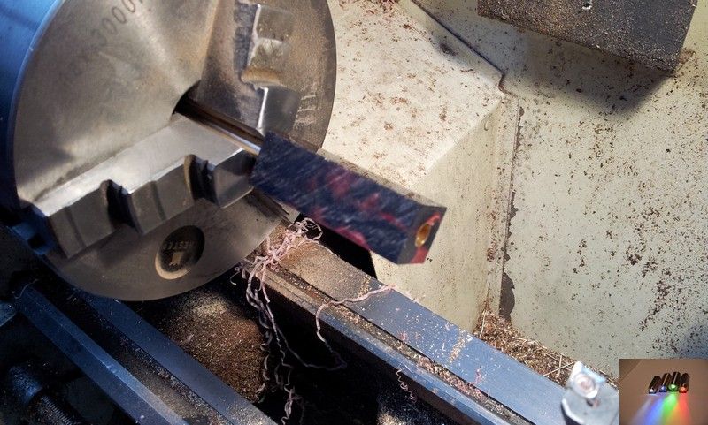

First the basic. I started with a generic Chinese pen kits that you can buy of e-blag etc. Added to that were some acrylic pen blanks and some wood blanks too..
The wooden ones mostly didn't go to plan.... I'm sticking to acrylic  :thumbup:

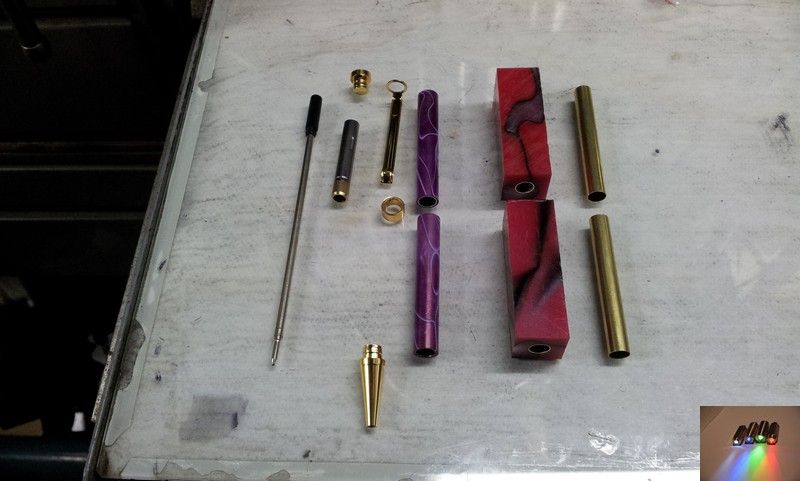

I made a rough and ready pen mandrel and an assortment of brass bushings (as needed to fit the kits I purchased)

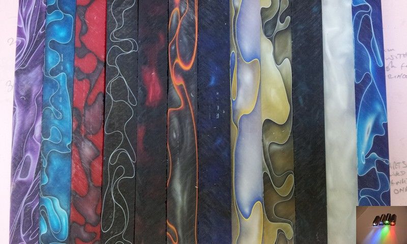

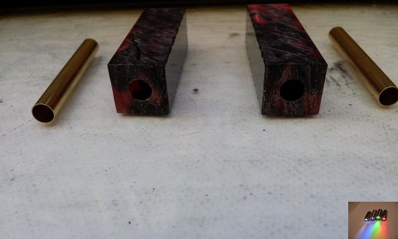

 I then started by chucking up the square blanks in the 4jaw chuck. Roughly centred using the cutting tool and the corners of the blank.  ( roughly cause the blanks are far bigger than the final pen size). Drilling them with a long series 7mm drill bit with a long spiral for easy swarf clearance.

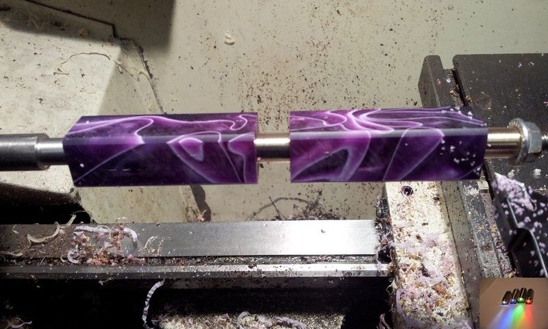

The blanks are then cut to slightly longer than required and the brass pen tubes are glued in using a 5min epoxy clear resin.
The resin sets to a glass like hardness quite quickly and was easier to remove any overspill that dripped into the tubes after 2 mins ish, while it was still elastic.

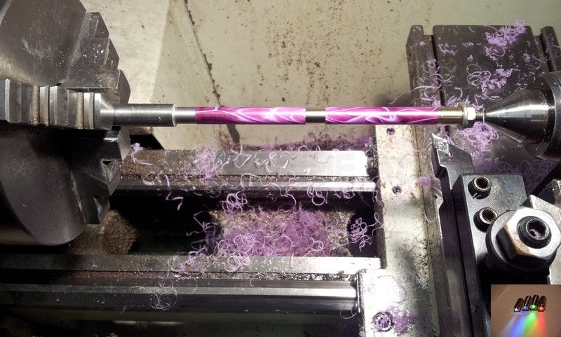

I squared off the blanks to the tube ends and then mounted them on the mandrel with the bit to become the tip of the pen to the left (just the way I did it)  then a spacer bushing then the other blank, a spacer bushing and then a nut to hold it all there tight for turning.

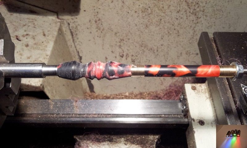

First pen was an experiment and was made to basic "just turn it all down and press it together" spec.

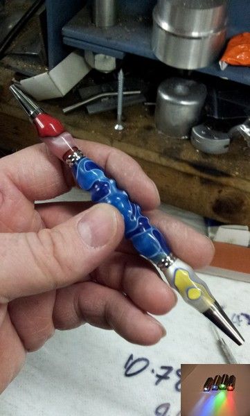

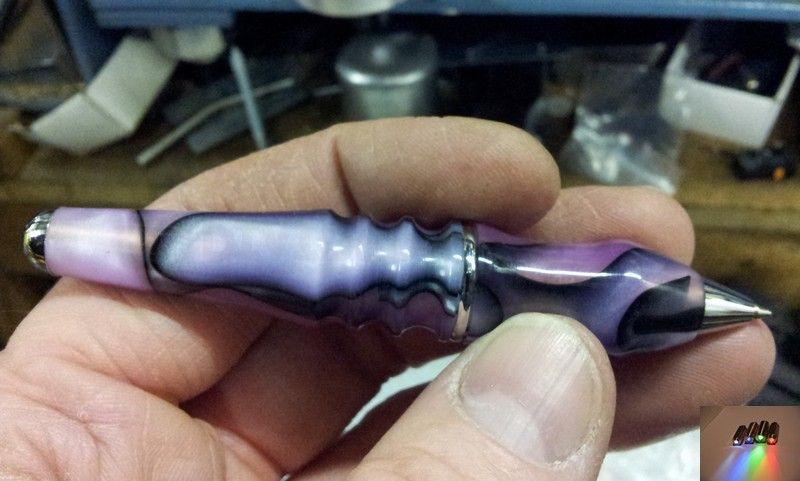

With that under my belt I started getting a little adventurous.....  :)
And more adventurous....

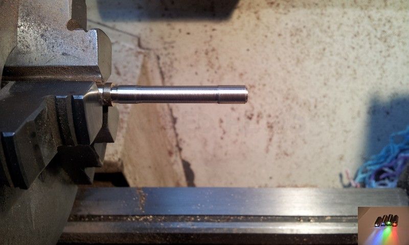

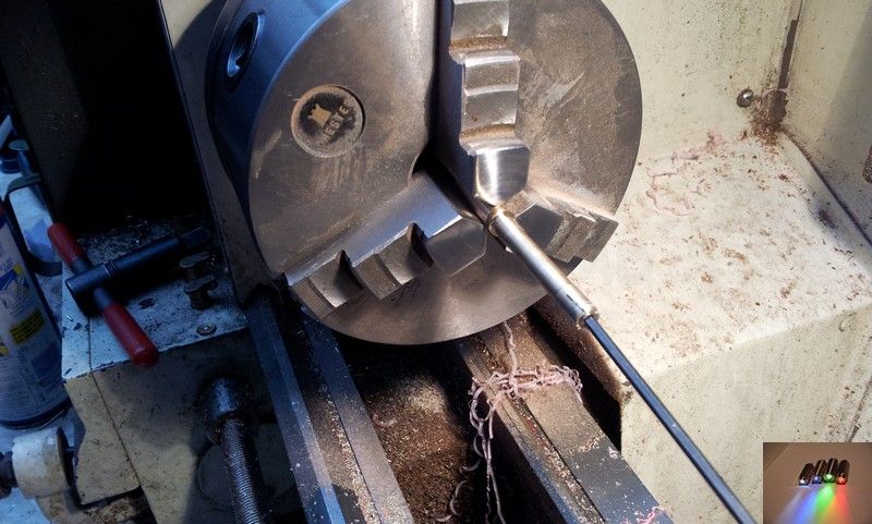

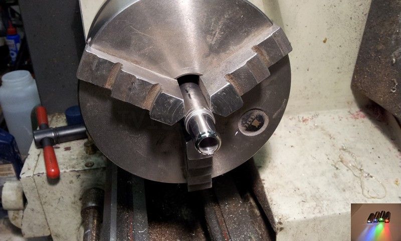

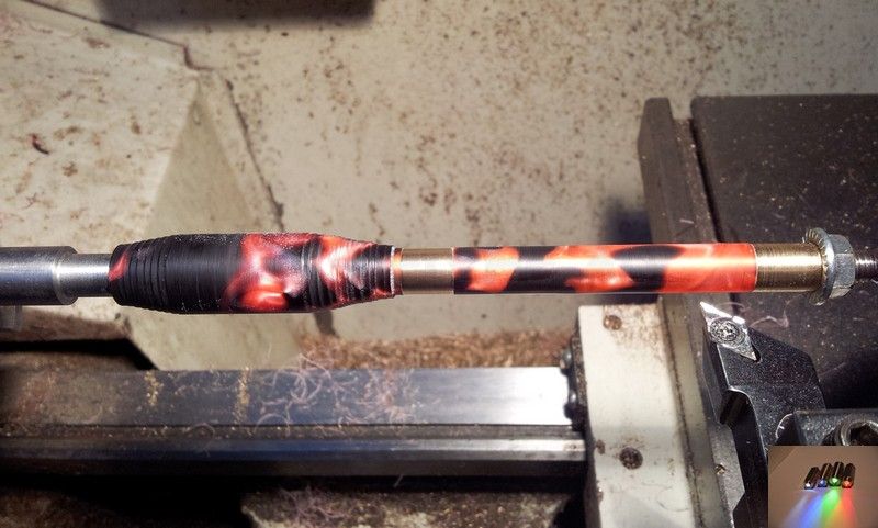

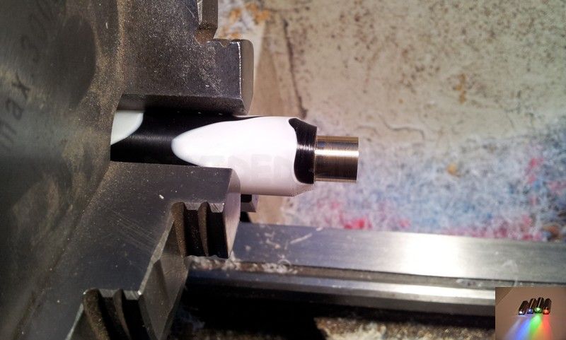

I ran into a but of a niggle with squaring the blanks off after gluing.  I had changed the chucks back over to use the mandrel and found it annoying changing back to the the 4 jaw in order to square the blanks.
So I made a little rough and ready arbour ( I was rushing to make more pens so no slitting saw was employed... Rough but functional)

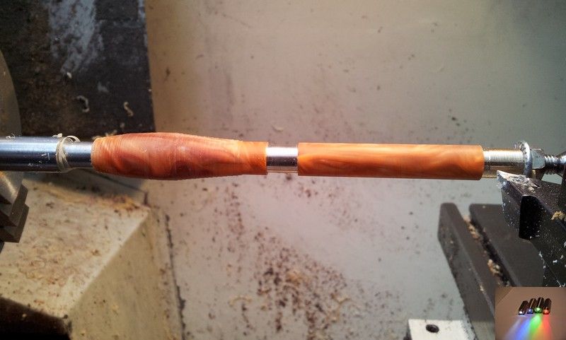

First, I turned the mandrel/arbour to size (6.3mm - 1/4")  Then I turned away the centre section to make it easier to mount the blanks. Drilled and tapped using only the starter tap to make a tapered thread inside the tip.
As said, Rough and ready... Terrible hacksaw cross cut   :bugeye:   Screwing in a grub screw forces the 4 sections apart due to the tapered thread created using only the tip of the number 1 tap.
I can now mount blanks quickly in the 3 jaw and square them off.

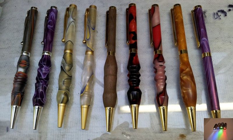

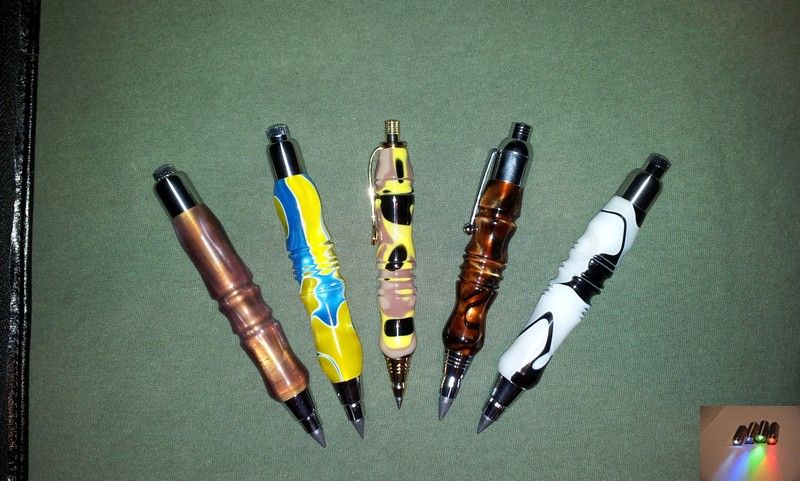

This is my first week or so's efforts... I have 20+ done now! All sorts of different sized and types are starting to enter the collection. Some would say I'm becoming obsessed  :loco:

Oh, BTW  I'm using the super sharp carbide inserts for aluminium to do the turning. Razor sharp and cuts this stuff like butter  :ddb:

I can see those being very popular Ralph, was expecting them to light up as well. whats the best way to get tthe machining marks out of acrylic, Ive used  fine scotchbrite pads soaked in WD40 followed by a soft cloth and WD. it can be slow though depending on the surface finish. A Nice looking job well done  :clap:

I've used Brasso  or Mirror metal polish with good results on perspex. It's actually a very fine abrasive paste. Could be used on scotch bright and then with a rag.

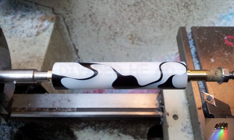

I'll try and answer these best I can without pic's to back it up.... I haven't taken any action shots or videos yet.
John,
After stepping out the basic shape I use files where possible to remove the bulk of the material. then step down through grades of emery tape and wet and dry (all dipped in water... Keeps the heat down and stops you burning the acrylic) from 100, 280,400and 600 grits.
Then again with the 600 with some brass polish added to the water. Then final cutting using this "micromesh" stuff in 3600, 8000 and finally 12000 grits. All wet and with a few dots of the brass polish added.
Remove residue between grits with a soft cloth and use a clean soft cloth for a final buff. Not sure if this is a prescribed method. But it works for me.
(Of course making sure the lathe bed is very well oiled before and after due to the use of water)

I remember this method. But there is an issue with these blanks. They are far from uniform! Some "16mm" square blanks are 16x18mm! The same issue with the 20mm ones. So 4 jaw is the only way to get reasonably accurate centre holes.

Wong,
Yep. Just playing with the dials. I use the main carriage and cross slide wheels (rarely use the compound myself).
Some of the cuts are done with a powerd cut in the Z axis and turning the cross slide handwheel  five, one quarter turns in and 5 back out. Some times slow count some times fast. Some times a much higher count. it gives me some interesting stepped curves to smooth out  :dremel:

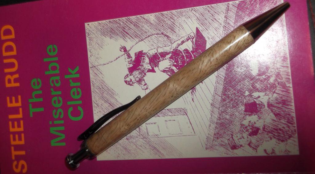

VT the micro mesh is usually found at places that sell pen parts or woodwork stores. For those that have wives with Avon products snaffle their cattle dog and look under nail stuff (her terminology) nice gear there and been using it for years on wood and acrylic pens.
As for acrylic I don't use it much now as there are many available in shops and I prefer the wide variety of woods available world wide at reasonable costs. Fruit woods are nice as well as some of our native trees which lose a limb now and again (pruning saw is handy). I have also found the fumes to be harmful from acrylic blanks....it sets of my wife's asthma every time.

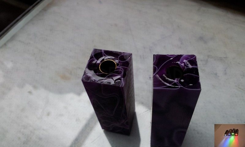

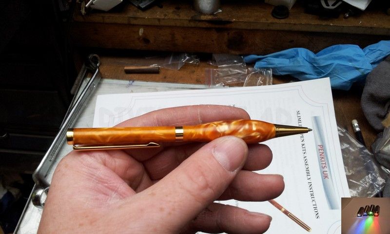

As promised I've got a few pic's of the "incident"

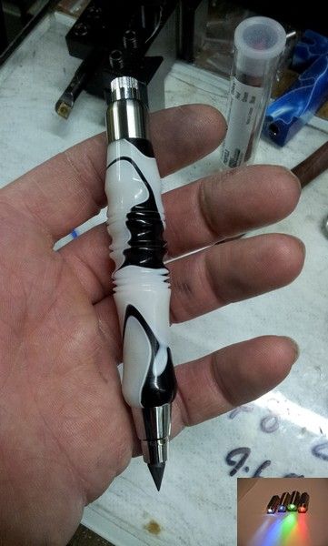

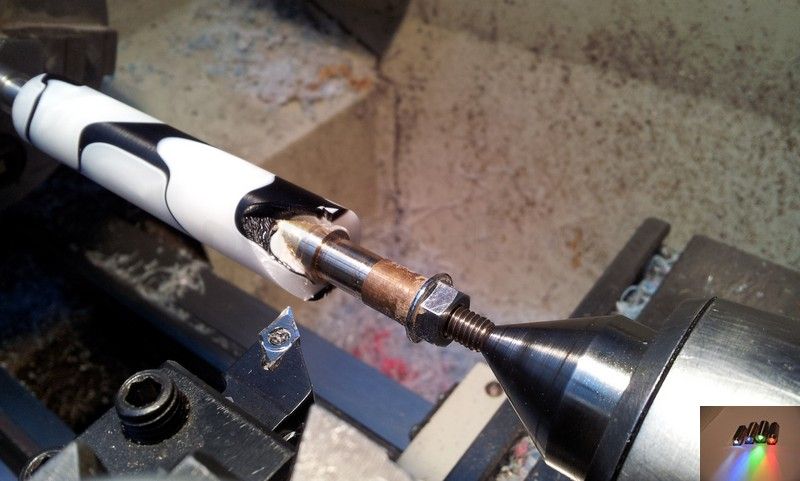

I was making the second of the Jumbo pencil kits I purchased and got a little excited and put a cut at a higher feed than should have... It  simply was too much for the lathe to take.
Started off with this...
And rapidly turned into this....
This simply would not do!
I had seen some "deluxe" versions of these with chromed domed tops. I had no chromed domes so Stainless steel would have to do...
I cleaned up the breakage.
Made a cap like this one.
Saved  :)
This is now my finishing method for the cheaper pencil kits. I have made a deluxe version Chrome dome with a clip)  and a "mini" gold plated version of these too, it's 10mm shorter in length and has a 3mm lead instead or a 5.8mm lead.
My pencils so far...

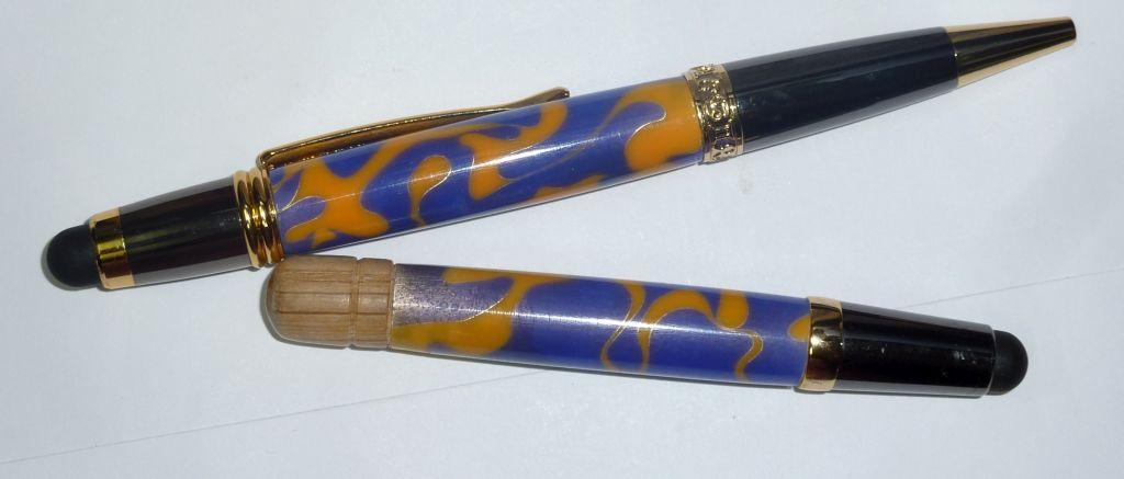

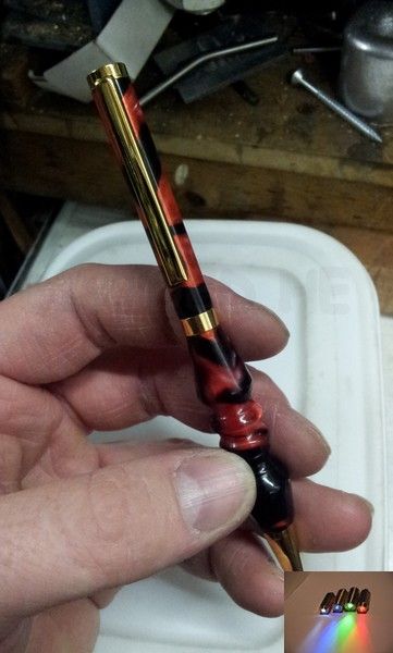

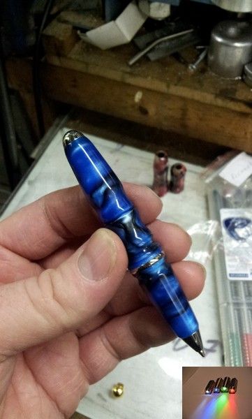

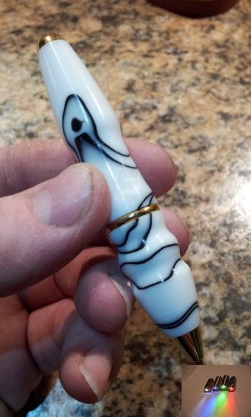

Oh and showing off a few more pens While I'm at it...   :)
A teachers pen - red one end black the other.
And some stubby pens...

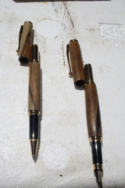

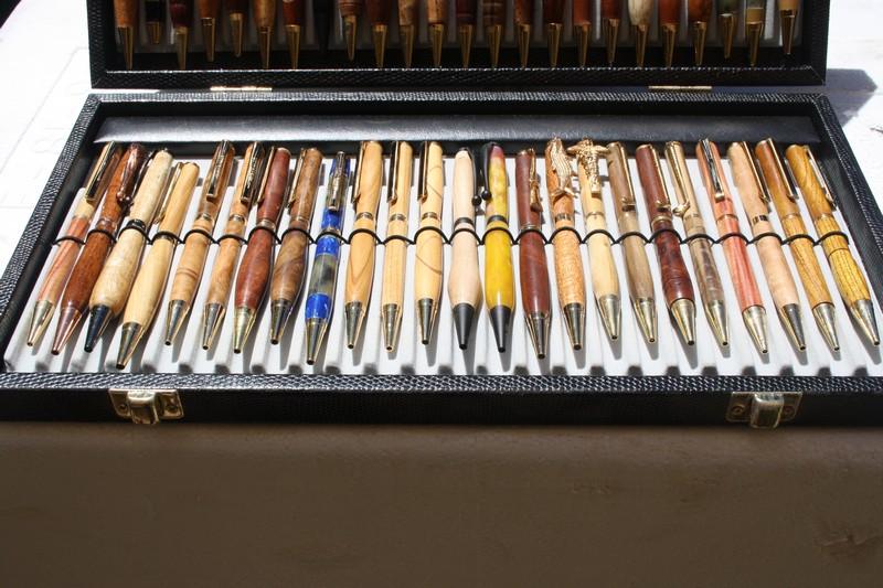

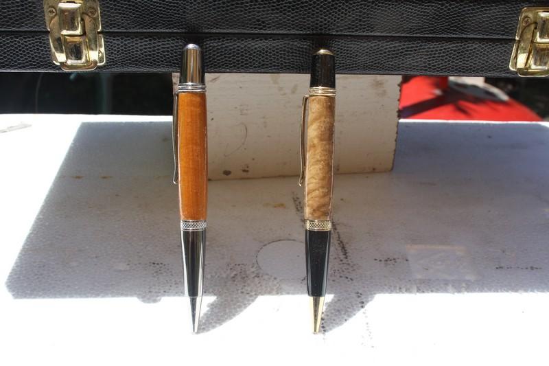

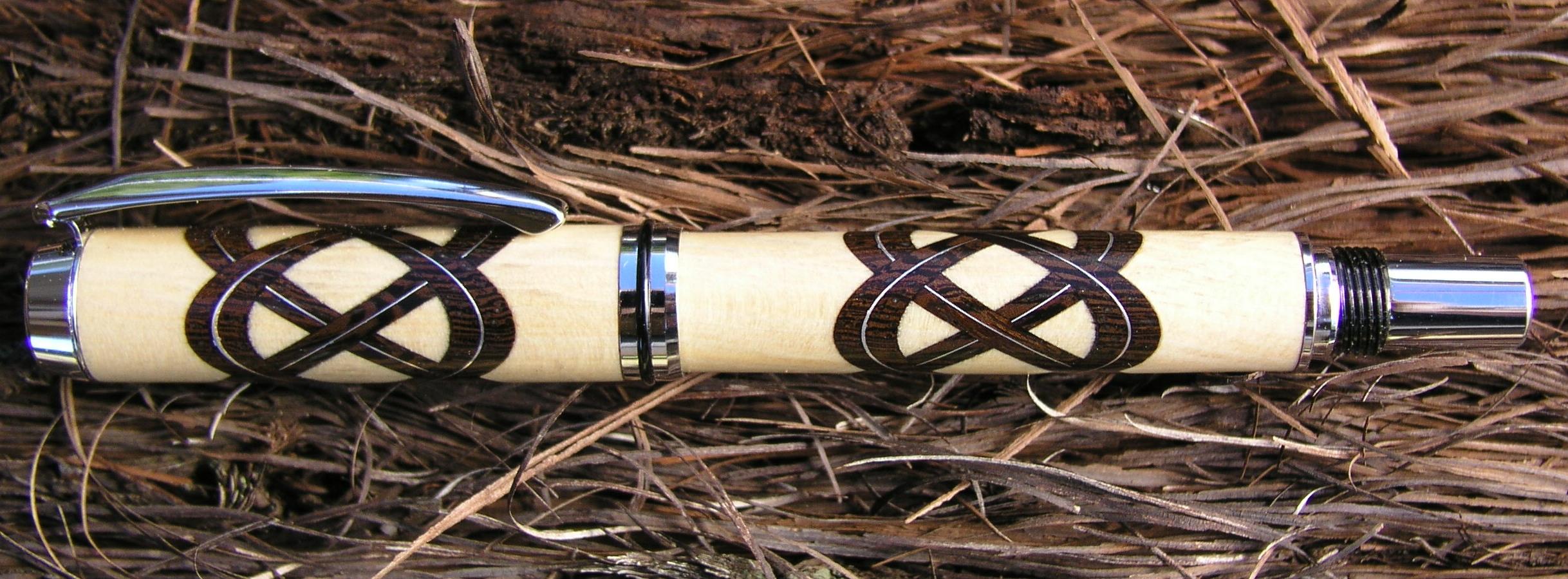

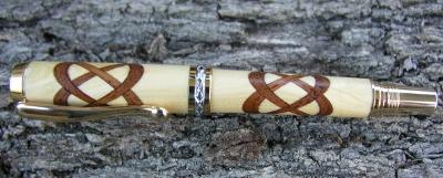

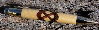

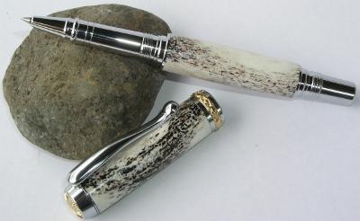

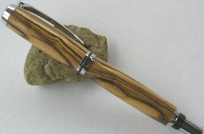

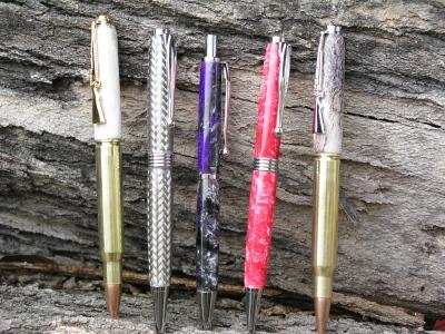

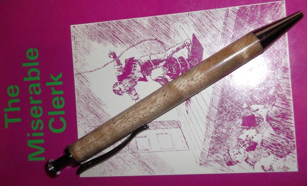

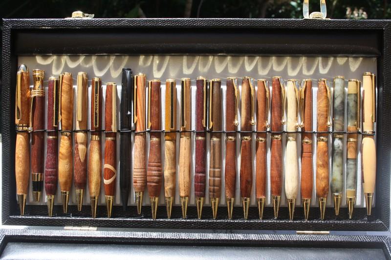

OK here are a few from my collection. The only 2 acrylic are the bright yellow and the bright blue pens. The blue is made from cut offs and a piece of stone which are also the other grey pens. The stone (from West Aust) I can't remember the name of it but its softish   :scratch:. All the rest are timber, mostly Australian wood with a piece ebony (black pen) cocobolo and amboyna thrown in.
The roller ball and fountain pen set is Tasmanian blackheart sassafras.  The reddish orange is a desert timber from the NT called conkaberry. Anyhoo enough dribbling I'll let the pics say it for me.

That's some very nice looking pens there Pete  :thumbup:

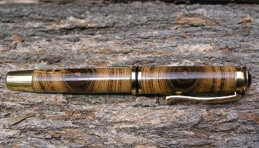

Stone sounds interesting! I'd have thought you'd need carbide or diamond tipped tooling for stone.
Looks like it polishes up really well though  :)
Do you turn these on a wood lathe?
You have some of the more expensive kits there and interesting colours of wood.......  Not that I could tell you which is what colour! But I can see they are different and have nice patterns in them.
Are the kits expensive over there? Some cost a fortune here!

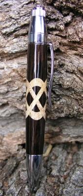

Thanks for the compliment Ralph. I'll see if I can find the name of the stone. Here's a link to one of the suppliers I use and the prices.
http://www.cws.au.com/..... DaveH follow the link and you can see what's in the kits, some more than others.....basically 2 tubes, the ends and clip and a refill. There are also plenty places in the States that supply some really exotic blanks and parts like laser cut piano keyboard blanks,flags, snake and cane toad skins even a circuit board pen blank. Some pen turners even use metal to make some great looking pens.
I have even made a pens from 308 cartridges from the target crowd. Nearly all my pens are made on a mini wood lathe similar to the jet mini but I have used the metal lathe on some like the brass pen I made for a friend . Imagination is good :wave:

The stone stuff is cut with HSS lathe tools and don't blunt them much at all.  YAY found it  :clap: It is a form of talc called steatite.

very nice pens mate , it gets addictive and you will be constantly trying to come up with a new style or material .one thing i have learned is dont make them all to suit what you like cos i have made a few that i hated and some one else loved em .i have been making pens for quite a few years , must of sold 5 or 6 hundred of em i would think . the wife used to keep an exercise book with all the sales in but she gave up half way through the book and no longer keeps a record of them .
try some celtic knot type pens , they are a bit of a challenge .
johno.

« Reply #30 on: June 13, 2014, 07:14:03 AM »
whoops sorry about the size of that pic .
couple of smaller ones .

Who'd of thought pens on this forum. Some real nice work in whats shown.
So I shall join in if its ok.
Recent birthdays of Grand daughter age 5 and grand son age 7 they both have iPods so a Stylus was in order.
Being as sweet as she deserves a little bling as well.
Offline AussieJimG
  • Posts: 381
Re: Acrylic pens.... Easy Xmas gifts?
« Reply #32 on: June 15, 2014, 12:10:48 AM »
Oh I do like the idea of making it into a stylus as well, how did you do that?
Jim

here's a couple more of the celtic knot one's i have made .
johno

Latest pen an Executive Clicker Gun Metal kit with QLD Mango polly finish.
