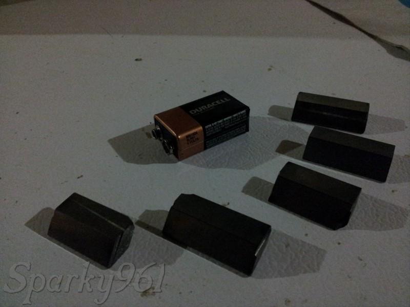

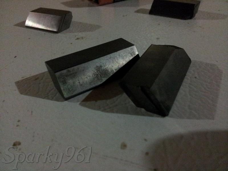

That's about my best guess for these things I found in a couple bins of odds and ends I picked up at a sale.  One of them seems to be a blank, with the ends flat.  While the others seem to be sharpened as turning tools.
They're magnetic, but seem much more like carbide when tested on the grinder.  I'm not entirely sure what they're made of.
I have some ideas on making a holder for these, but curious to know what these are intended to fit into.

They don't look right for tangential inserts Sparky, the angles are all wrong. My tangential stuff has a diamond shape when looking at the end of the bit. Sorry, no clue as to what they may be. But other members might be able to offer the information you seek.

Hardened steel gib key cut up into bits...?     :scratch:   :scratch:
Cobalt (the most common binder for Tungsten Carbide) is ferromagnetic, so is Nickel which is also used as a binder.
Sorry no idea what they are/were for though...

Thanks for the magnetic tidbit. That one had me very puzzled.
Still unsure what they are but pretty still sure they're meant as turning inserts.  I guess I'll just make up a holder how I think it should look... :-)

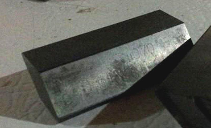

They are indeed diamond shape. I guess the pictures don't show that well.  What do your holders look like?

Get them in a good light then photograph w/ macro straight on, and put the image into a graphics program and enhance contrast. Read the markings and then do an internet search for them.
Here's the best I can do with the photo you included, but you can do this much more effectively with a better lit shot, from straight on.
