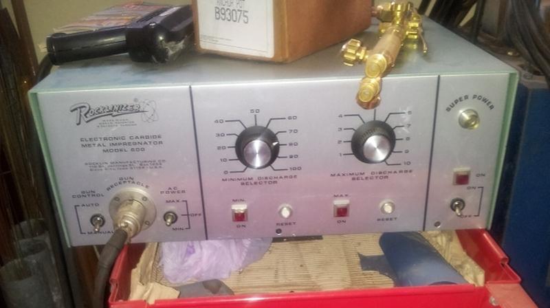

I have a Rocklinizer that deposits tungsten carbide to tool steel, at one time they made an attachment for a small EDM. The main unit is a power supply, the depositor is a vibrating handle, figure you change the electrode and reverse polarity? But before I try that would like to know more info! there is one on ebay way to high price! http://www.ebay.com/itm/Rocklinizer-500-Electric-Charge-Generator-with-EDM-Router-Model-9750A-/330660662115?pt=US_Heavy_Equipment&hash=item4cfce94b63
My Rocklinizer is a 600 a larger unit.  A long time ago HSM or PIM did a series on a diy EDM (looks like I'm type alphabet soup!) About what year was that??

I have had severe asthma all my adult life.  The price of the Rocklinizer put me into a acute attack.

that price is 500+ bucks off the original asking price!  :bugeye:

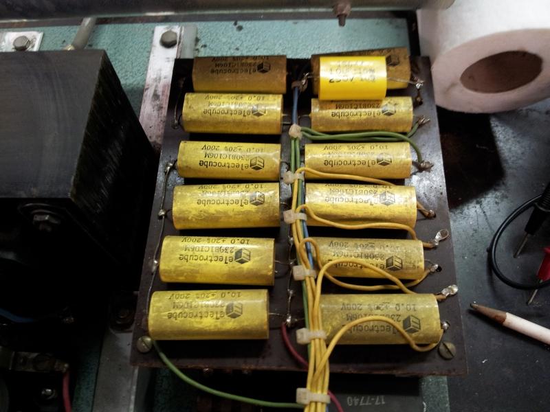

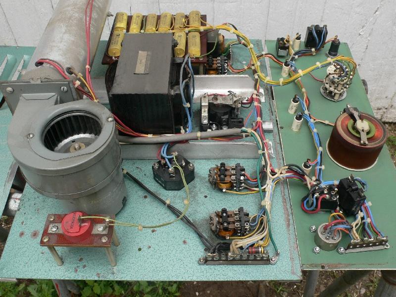

I broke a tap off and have join the hunt for a tap zapper or making one of these work.
Rocklin the EDM looks like part of a portable drill press for the stand, the working mechanism is like a tattoo machine.
I also have a 314 I'll attach a couple of pics so you can break it down electronically. I replaced one cap on it metalized
