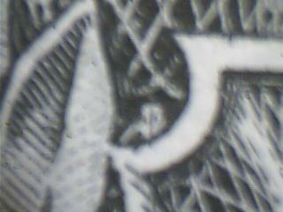

I have a microscope on a "home made rig".  Need a .25 or .5 objective to increase working height-focus range so I can work under it better.
Thoughts, sharpening drill bits like I used to be able to see, once upon a time. I had a camera-monitor hooked up once. wrote software for it.. things fall by the side like that. more important issues to attend to.
Photo- molock the owl on the dollar bill under the microscope.. Crescent moon, top left in right corner in the Rothschild shield of the $1 USA currency.
