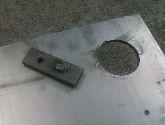

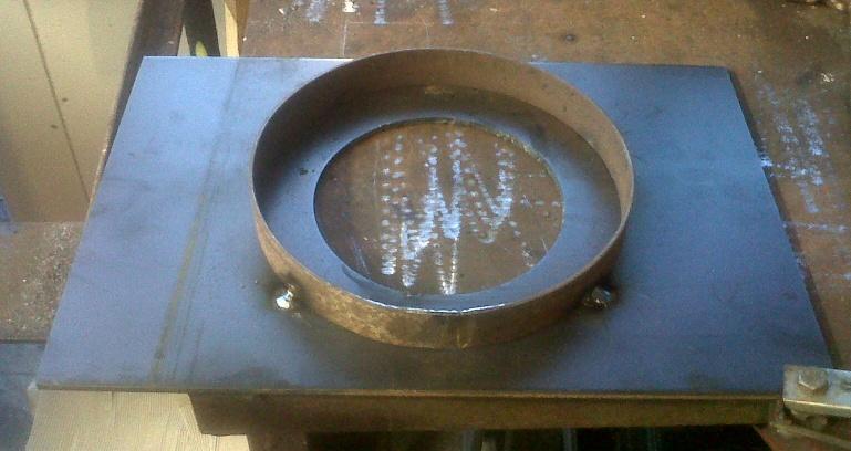

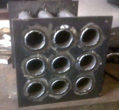

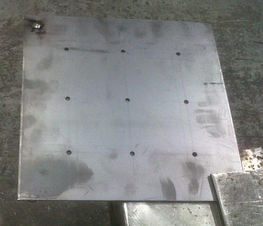

I can put it off no longer so I nipped to our local B&Q and picked up a garden burner. (pic 1)

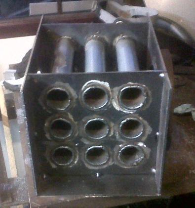

The plan is to place it outside the workshop and fit a heat exchanger to draw warm air into the shop thus the fire will not be endangering my shop.
So I took 2 plates and marked and drilled 9 holes then plama cut the holes for the exchanger tubes using a simple circle jig. Then it was just a case of welding in the tubes and that how far I got today.

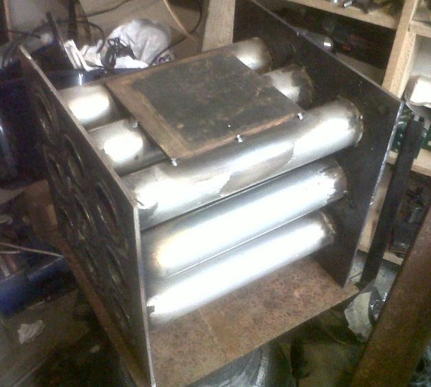

Now here I would like advice should I flue around or through the pipes? the origional plan was to mount the exchanger with the pipes horizontal and the flue would be going around the outside of them but as luck would have it the 9 tubes equal around the same area as the hole in the top of the burner. so the question is do you think the unit would be more efficient drawing air through the pipe or from the area around them?
  • Posts: 6864
Re: workshop heating
« Reply #1 on: October 14, 2013, 08:01:23 PM »
I'll vote for around them because you'll increase turbulence of the hottest gasses. But you'll need to box it in and insulate, and also make it accessible for cleanout. The more heat you extract, the more you will collect ash and creosote because you'll cool the smoke in contact.

« Reply #2 on: October 15, 2013, 05:18:07 PM »

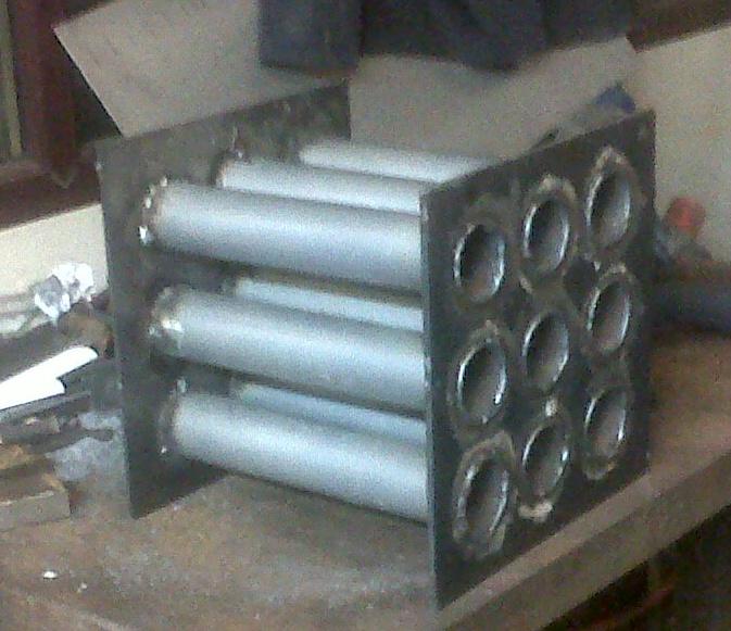

thanks vtsteam I am going to box it in but havent got to that part yet. However you mentioning creating turbulance gave me an idea, so I have placed a plate on the top layer of pipes right in the middle. The reason being that now none of the hot gasses from the fire will be able to go up the chimney without hitting some part of the heat exchanger on its way out.
  • Posts: 6864
« Reply #3 on: October 15, 2013, 10:17:57 PM »
Baffles are good, they increase residence. You can use more than one if you alternate them. Since you have a central one at the top, the next row down could have two side plates with a central space, etc. More complexity, though does increase clean-out difficulty. Everything is a compromise.
btw it's tough making tube plates. You did a good job with thin stock there  :thumbup:  :clap:

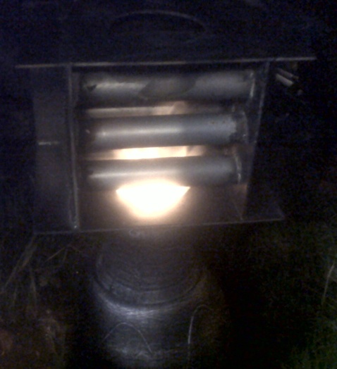

todays progress:

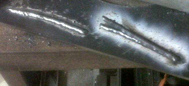

cut the rest of the plates and started to weld them together then ran out of gas for the mig welder  :doh:.
I dug out my old hobby arc welder and did a few practice welds but decided I wasnt confident enough in the rather rubbish unit, The (probably) damp rods and the fact I havent touched a arc welder for donkeys years, to carry on. so I will wait until I get some more gas friday probably.
Being the impatient person I am I tried a test burn with some kindling and have to say I was pleased with the heat that even this small fire put into the exchanger.
edit: sorry for the big pic have replaced it with smaller one.

Offline RossJarvis
  • Posts: 174
« Reply #6 on: October 16, 2013, 05:22:34 PM »
It might be too late, or just stoopid, but could you put fins on the pipes or maybe get perforated mesh in there, contacting the pipes to increase the surface area further?  A bit like an old Scammell radiator.

not stupid at all but yes its a bit late for fins now and I dont have any perforated plate. I am following the advice of vtsteam and putting a access panel on front so might be able to add more metal to soak heat if needed later.

You don't want to restrict the exhaust too much, and clean-out becomes a problem with small stuff. A few nice big baffles with big spaces to let the smoke travel are helpful, and can be more easily cleaned.
In something this small, fins won't work well if too thin. The heat may be picked up on the broad surfaces, but then must travel through a thin cross section to reach the pipes. The thinner the cross section, the slower it travels. Mesh or thin sheet metal would provide little assistance to heat transfer to the pipes unless there was a very large number of them -- as on a baseboard radiator pipe or car radiator. A few won't do much. And they are hard to fabricate and very difficult to clean where used with a wood fire which produces tars and ash in the smoke. They soon build up an insulating layer and become ineffective.

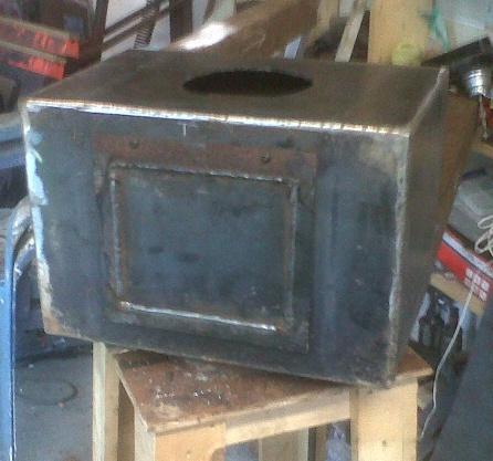

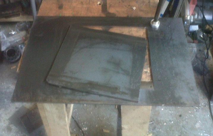

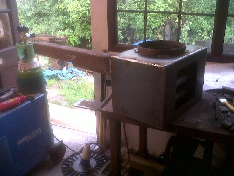

So got more gas and cut the access panel out of the front and welded it to the exchanger along with the ends and the air pipes.
I will get the access panel sorted tomorrow and if the rain holds off I can sort out where it is going to sit.

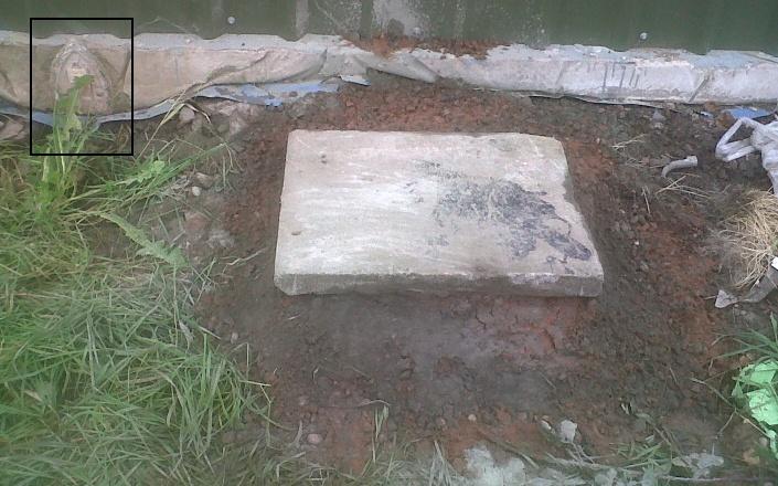

Not for too much longer vt they are starting to turn now so wont be long and it will all be bare.

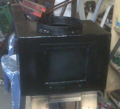

today I:
sorted a place for it all to sit.
sorted out the access panel.
Painted the exchanger with stove paint.

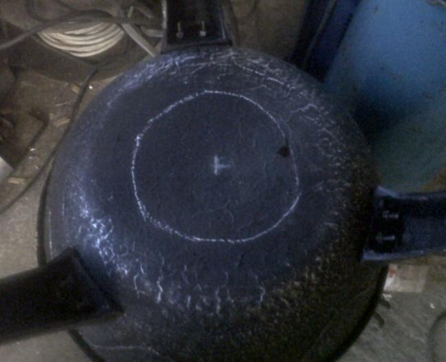

and for my day off tomorrow I am going into work to make use of the plasma to cut the bottom from the chimenera to save me have too much trouble clearing the ash out. Tried with a jigsaw but would have took ages.

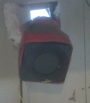

« Reply #12 on: October 21, 2013, 10:45:48 AM »

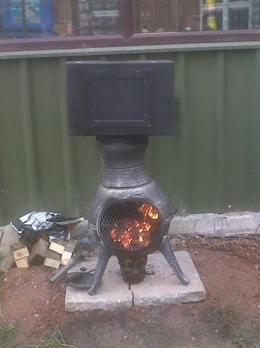

It works and works well  :ddb:
I know its a bit lop sided but the ring which has fitted well all the way through decided it didnt want to fit but I was on my own and it took a lot of effort to get it in place so didnt want to take it of, I will let it cool down and get my mate to give me a hand to fit it properly.

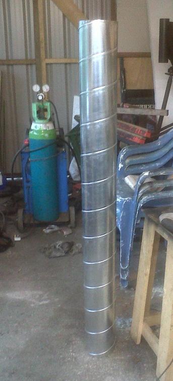

I temp fitted the fan blowing air into the exchanger with cardboard and tape and let it rip and it works very well the flue pipe arrived today as well and I have started to make the fittings for that.

« Reply #13 on: October 21, 2013, 12:36:39 PM »
Looks good!  :clap:
The door vent looks huge -- will you be modifying or fitting a solid door with adjustable vent(s)?
As it is, it will draw in excess cold air, and at full burn might make for a cooler heater than a slower burn would provide.
Other suggestions:
If you could put a second skin over at least some area of the outside of the firebox case and draw combustion air through that before going through a vent into the fire, it would pre-heat it, as well as utilize some of the large radiant heat losses that the firebox will have .
This is all icing on the cake for your more moderate climate probably, but around here it would probably be necessary.

Thanks vt I did think about a solid door with breather holes but not sure now. A slower burn would be nice however I think I went a bit too far with the hole in the bottom to clear the ash I think I will have to replace it with a removable plate.
As far as preheating the combustion air I dont think its needed when it puts plenty of heat into the shop as it is.

Put the plate over the hole and started it tonight and it burns lots slower and still puts plenty of heat into the shop.
If there is one quibble the heat is very dry (if that makes sense) and dries the throat a little but nothing plenty of tea wont solve.
