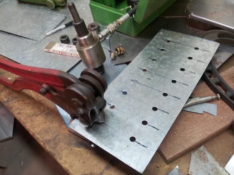

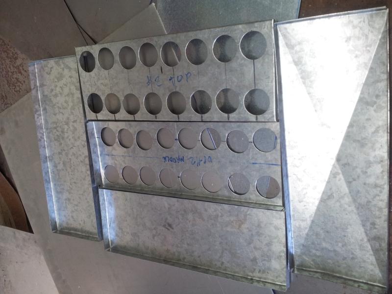

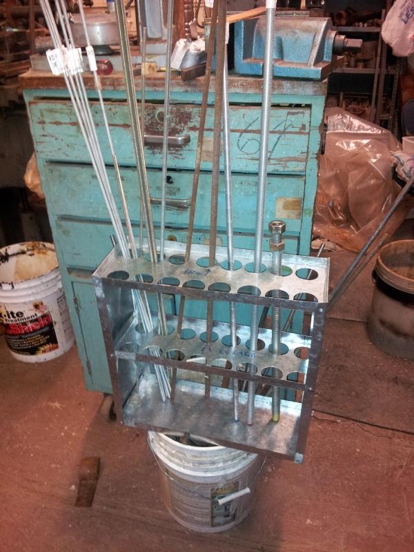

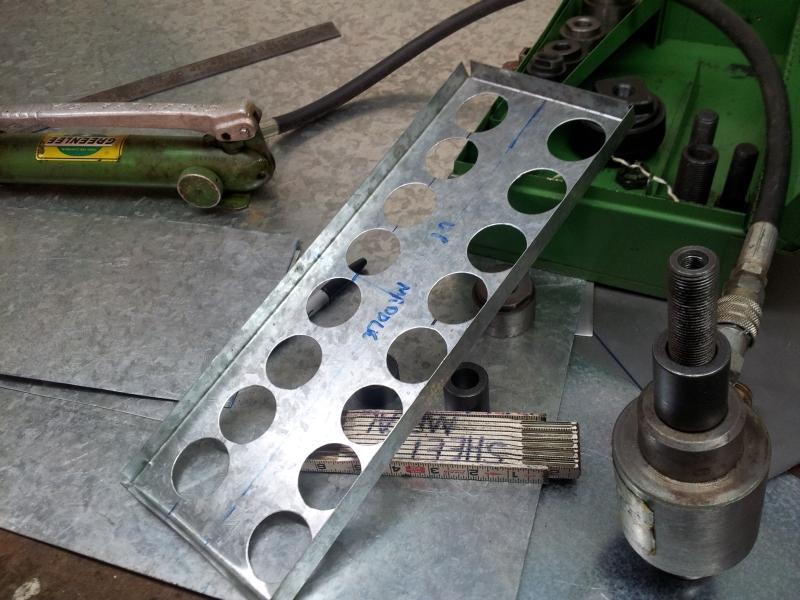

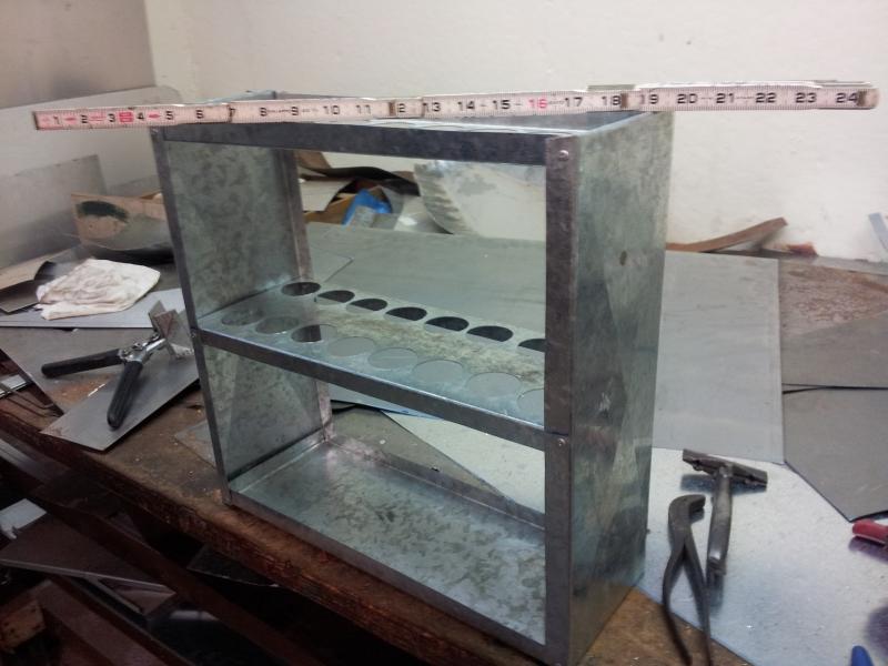

Just made a couple of these for 3' and less threaded rod, s/s rod, brass rod.  smaller stuff pile on a shelf, longer stuff piled on the floor and stacked up along the wall. Made from 22 gauge 36" wide stock, so the rough cuts were 7.5" by 18" to not make scrap. Each rack is made from 5 pcs, 2 of which get holes. I have greenlee round dies no squares so that is why they are round. Soon as I can make a spot they will get screwed to the wall  :zap:

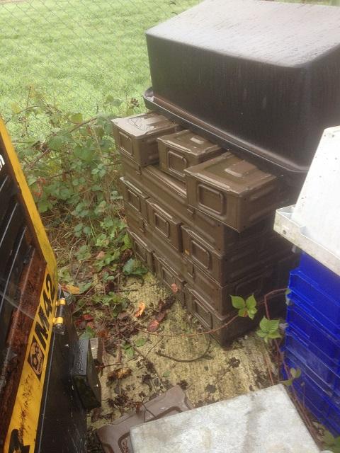

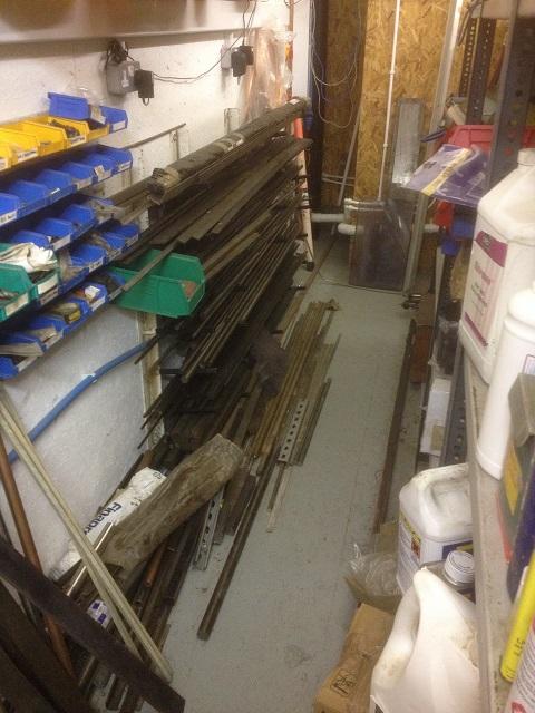

Similar to John S 's mine is mainly racking on the wall. I do have a stack of 'carbine boxes' - like bullet boxes but a different shape, that holds the more 'chunky' pieces. Separate ones for brass, steel, aluminium, plastic and paxolin.
Incidentally I do have rather more of the carbine boxes than I need if anyone needs some.

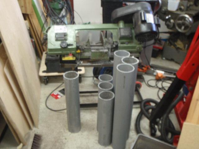

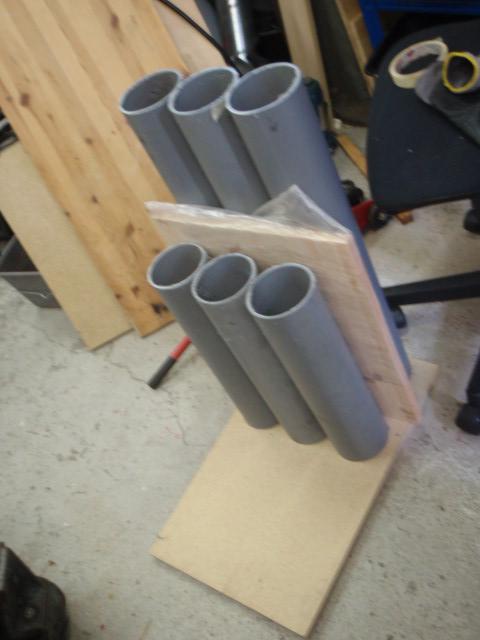

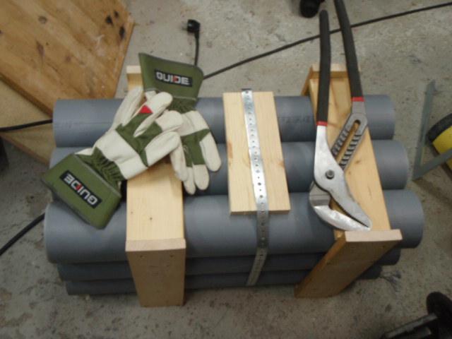

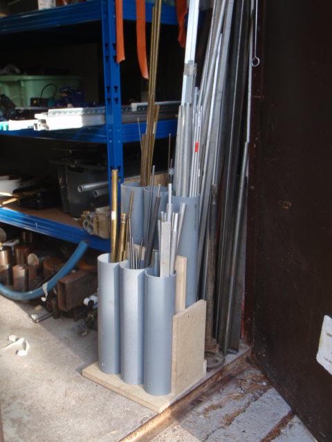

I just made this weekend some storage place.
1) Long rods are leaning up against the wall
2) 50 cm to 150 cm rods up in drain tubes bunched together (have to build more this type).
3) 70 cm and shorter vertical on drain tubes bunched together
*Picture update* I made them really simple. Used band saw to cut the 110 mm OD plastic drain pipe and simple frames of board lying around.
