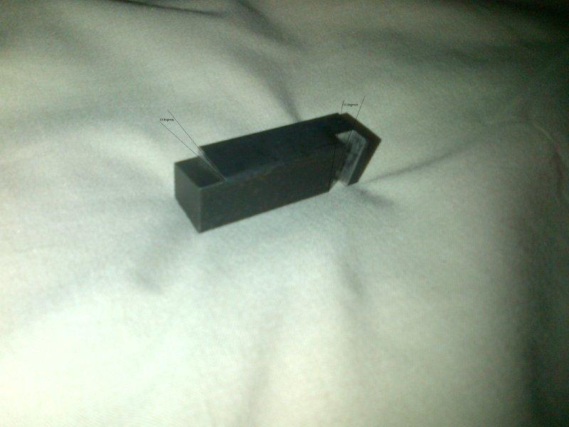

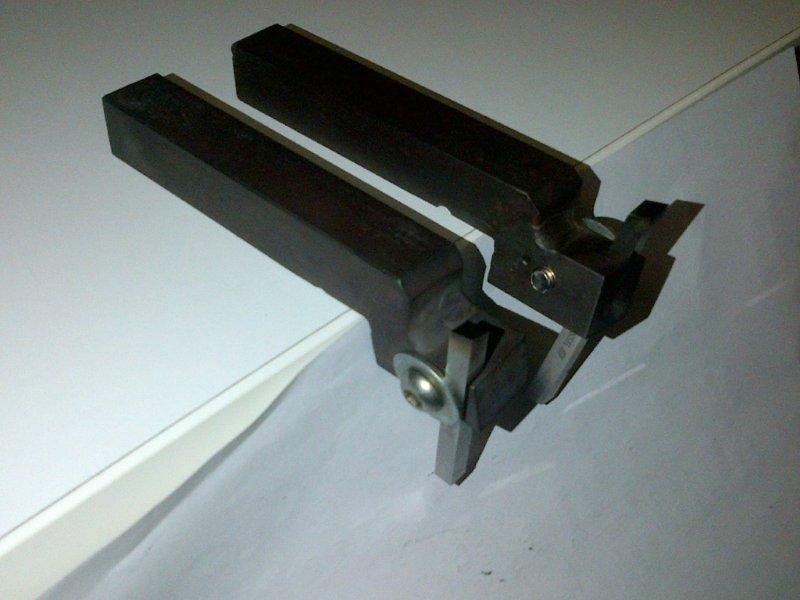

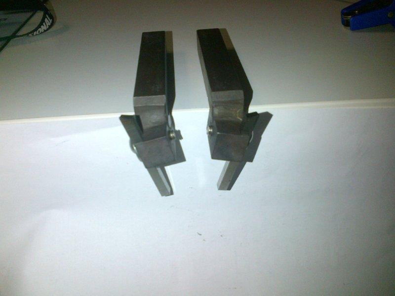

Hi Guys
I  want to share with you how I made my tangential tool holders. I tried to keep the construction as simple as possible without compromising on rigidity and thereby avoiding chatter. It may be crude but I am very impressed with the performance of these tools, this is definitely the best time/effort investment I made to upgrade my cutting tools for my lathe.
The tool holders were made up of two pieces of 16mm mild steel square bar, the part that the HSS tool is clamped onto, the tool block if I can call it that, has both the angles for cutting clearance machined on to it and when it is welded to the square bar shaft the cutting angles will automatically be correct..
As you can see from the photo below the groove that guides the HSS cutting tool is cut at 12 degrees from the vertical axis, leaning foreward. The side clearance angle is cut on the back top of the tool block   about 10mm long and when it is clamped to the shaft for welding it will tilt the axis of the tool block by 12 degrees. I hope you understand my explanation. :doh:

« Reply #1 on: September 06, 2013, 07:33:06 AM »
That's a nice solution to the two 12° angles problem!
Thanks, I'll use your idea, regards, Matthew

« Reply #2 on: September 06, 2013, 08:33:05 AM »
Buksie, thanks for opening this thread and showing your tool holders. I made a quick change version. Like yours, my tool bit is held by a screw and washer. Unfortunately it tends to slip on occasion -- particularly on an interrupted cut. Do you find that happens with yours?
