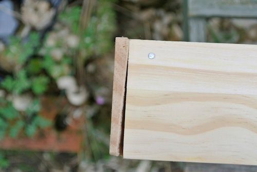

I also realised that the edges of the end wotsits weren’t square to the faces, leaving more room for expansion (and too much for adhesion);
http://i617.photobucket.com/albums/tt252/RossJarvis/Toolbox/no%201/_DSC3144.jpgHow not to make a Japanese style toolbox
Anyway, it surely can’t get any worse can it?

http://i617.photobucket.com/albums/tt252/RossJarvis/Toolbox/no%205/_DSC3209.jpgHow not to make a Japanese style toolbox
Hmmm, I believe that’s called “cupping”, just remember that if you’re thinking of buying pine shelving from B&Q!  This means I’ll have to nail it to the bottom of the side and ends of the tray.  This poses a problem, as the tray bits are just about the right size to fit under the lid and I had intended the base to be nailed “inside” them.  So for no particular reason (apart from not wanting to cut or plane the side/end bits any more) I thought I’d plane a rebate for the base to fit into.  So I nailed a bit of batten along the edge of the “side bits”;

Nextly I noticed the lid to the tool-box had wedged itself shut, The wood’ s been moving a fair bit and I think it’s sucked up a fair bit of humidity  (rain?) from the air.  Having gently removed the lid with a block of wood and a framing hammer, I bevelled the edges which seemed to resolve the problem;
http://i617.photobucket.com/albums/tt252/RossJarvis/Toolbox/no%206/_DSC3222.jpgHow not to make a Japanese style toolbox
You might see that not only has the wood got fatter, it also cupped despite the batten across it.  Following this, I ripped and trimmed some more board to make the base of the tray,cut the sides to length, glued and pinned them on and checked the ends for fit.  These needed side “rebates” so out with Mr 311 again;
http://i617.photobucket.com/albums/tt252/RossJarvis/Toolbox/no%206/_DSC3225.jpgHow not to make a Japanese style toolbox

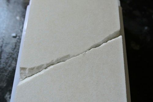

I think I've effected a permanent repair to the GBQ35 Whetstone, if you remember, it looked like this;
http://i617.photobucket.com/albums/tt252/RossJarvis/broken%20stone/_DSC3251.jpgHow not to make a Japanese style toolbox
Due to the crumbling on the edges, I thought I wouldn’t even be able to glue it back together;

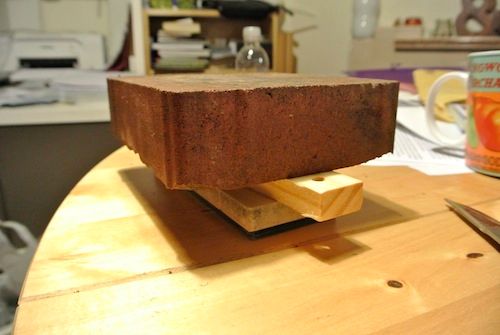

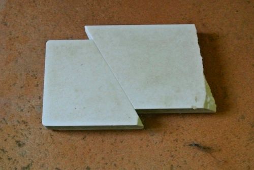

…many “boo hoo hoos” later and a bit of web-looking and following some great advice from a couple of guys on the UKWorkshop site, I thought I might be able to salvage it.  First thing to do was grind the broken edges, here I’m using a concrete paver, left over from the new path and a bit of 2x2 to hold it square;
http://i617.photobucket.com/albums/tt252/RossJarvis/broken%20stone/_DSC3253.jpgHow not to make a Japanese style toolbox
…to do the next bit I made a guide to hold the next piece at the reverse angle to the first bit;
http://i617.photobucket.com/albums/tt252/RossJarvis/broken%20stone/_DSC3255.jpgHow not to make a Japanese style toolbox
…and then I “lapped” the ground edges together for a good fit and to correct any angles between them, I was using a contoured tile I found in the garden, possibly a flat one or some glass would be better;
http://i617.photobucket.com/albums/tt252/RossJarvis/broken%20stone/_DSC3256.jpgHow not to make a Japanese style toolbox
http://i617.photobucket.com/albums/tt252/RossJarvis/broken%20stone/_DSC3257.jpgHow not to make a Japanese style toolbox
I wish I’d kept the sludge, as I could have mixed this with glue to fill some gaps!  I was left with three regular, non wobbly bits of whetstone;
http://i617.photobucket.com/albums/tt252/RossJarvis/broken%20stone/_DSC3258.jpgHow not to make a Japanese style toolbox
Not 100% straight but good enough for government work at least;
http://i617.photobucket.com/albums/tt252/RossJarvis/broken%20stone/_DSC3259.jpgHow not to make a Japanese style toolbox
I left these long enough to dry out and the next day I phoned the local glaziers, who had moved, so are no longer local and within 6 hrs I got delivered a cut to size, ground edged, piece of 6mm laminate glass.  This was a fiver so I recommend these guys;
http://i617.photobucket.com/albums/tt252/RossJarvis/_DSC3272.jpgHow not to make a Japanese style toolbox
I was so chuffed with the service I gave the driver a 2 pound note for his efforts.  I had intended to use a flat tile, but there weren't none in the garden.  We had some under the sink once, but since recently fitting new taps (again) I'm not going down there!
Next I got to the repairing bit.  1 packet Hobnobs, ¾ pint tea, two tubes of Araldite normal (found in spare room), some plastic card stuff, glass and the bits of stone.
http://i617.photobucket.com/albums/tt252/RossJarvis/broken%20stone/_DSC3273.jpgHow not to make a Japanese style toolbox
araldite was mixed, spread on the glass and on the lower sides of the joining edges;
http://i617.photobucket.com/albums/tt252/RossJarvis/broken%20stone/_DSC3274.jpgHow not to make a Japanese style toolbox
…all the bits were assembled;
http://i617.photobucket.com/albums/tt252/RossJarvis/broken%20stone/_DSC3275.jpgHow not to make a Japanese style toolbox
http://i617.photobucket.com/albums/tt252/RossJarvis/broken%20stone/_DSC3276.jpgHow not to make a Japanese style toolbox
and the flattening stone was re-deployed to weigh it all down;
http://i617.photobucket.com/albums/tt252/RossJarvis/broken%20stone/_DSC3278.jpgHow not to make a Japanese style toolbox
I found I couldn’t put pressure on the ends of the stone to hold the joints together.  Being wedge shaped, they just slid sideways.  I think something rigid on either side would be needed, but as I wasn’t sure if this was normal or rapid Araldite (it turned out to be normal), I didn’t want to hang around to work it out.  Come the morning, everything was looking okay;
http://i617.photobucket.com/albums/tt252/RossJarvis/broken%20stone/_DSC3279.jpgHow not to make a Japanese style toolbox
I could see the top surface was a little off true and a bit of glue had squirged out the gap;
http://i617.photobucket.com/albums/tt252/RossJarvis/broken%20stone/_DSC3280.jpgHow not to make a Japanese style toolbox
....so I took it outside to the “flattening station” and it all came right;
http://i617.photobucket.com/albums/tt252/RossJarvis/broken%20stone/_DSC3282.jpgHow not to make a Japanese style toolbox
It’s a wee bit shorter than it was, but still very much a usable size;
http://i617.photobucket.com/albums/tt252/RossJarvis/broken%20stone/_DSC3281.jpgHow not to make a Japanese style toolbox
To see if it was up to scratch I took an unfettled plane iron to it.
http://i617.photobucket.com/albums/tt252/RossJarvis/broken%20stone/_DSC3283.jpgHow not to make a Japanese style toolbox
…and I can safely say it works just as well as it did before I dropped it.  I am also very pleased that spending a fiver saved me having to get a new one.  If I wasn't afeared of the under-sink monsters it could have been free!

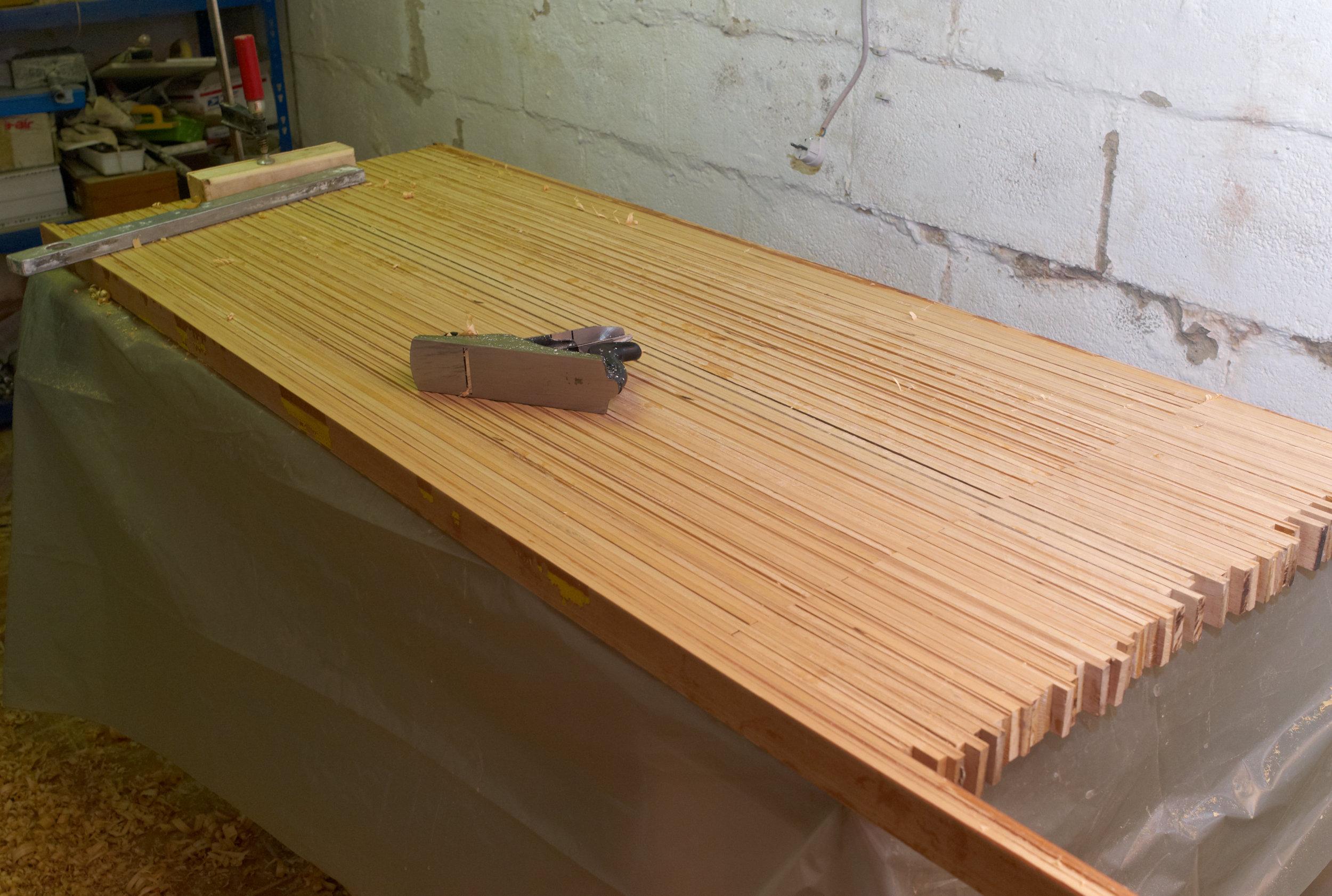

It is 170 x 72 x 4 cm. planning it was a good work out. It is an Anant plane I bought. Luckily I can't remember what a stanley is like, so I don't know how much better a plane can be :)
Pekka, you post motivated me to looking up "tuning up a  wood plane in Youtube". Thanks.
