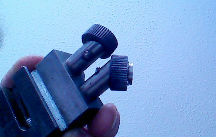

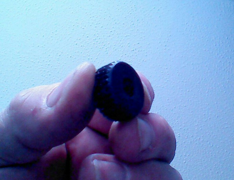

I think I may have a pair of these. I bought them cheap at a show. They are a pair of plain German made Knurls with no champer on the corners. Now, where did I put them ...
  • Posts: 1179
Re: "Cutting" knurling tool anyone ?
« Reply #32 on: October 05, 2013, 04:57:30 AM »
You can just grind off the chamfer of a cheap knurl wheel.
Offline Arbalist
  • Posts: 673
« Reply #33 on: October 05, 2013, 03:14:37 PM »
Excellent! Guess mine will work fine then.
« Reply #34 on: October 05, 2013, 03:17:23 PM »
How can you tell what wheel is a cut knurler vs as deforming knurler? I looked at the catalogue John linked to, found the right knurl wheels (I think), and they look exactly like every other knurl.... to my eyes anyway?
What am I missing?
« Reply #35 on: October 05, 2013, 04:10:40 PM »
The leading face is ground so that the exposed end of the knurl shape is sharp, whereas most squash type knurls have a bit of a bevel.

I can see the point of using these tools for long lengths, suppose it depends what your standards are and what its for, I wouldnt let that go.
Either its turned down after or the cut knurl has dimensionally gained like a conventional tool. I usually get a gain of 0.4 to 0.5mm on a coarse knurl, double that on round.
