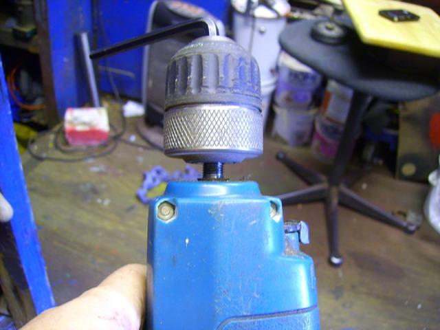

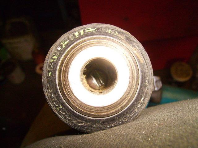

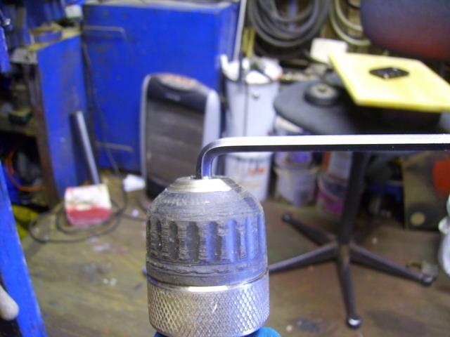

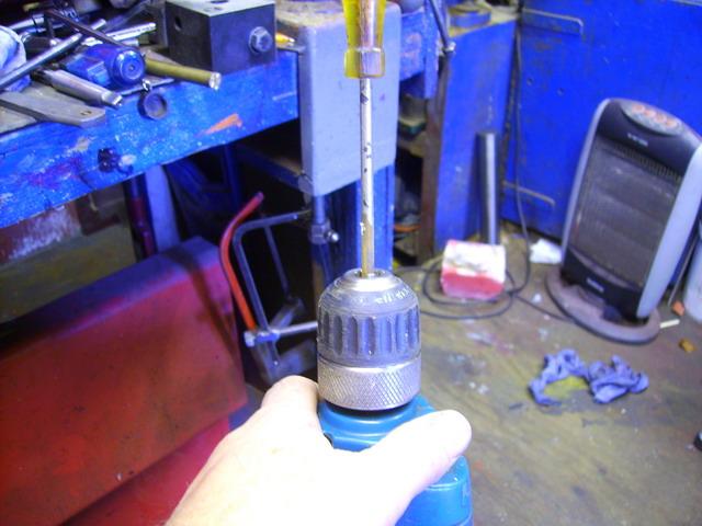

« Reply #14 on: September 26, 2013, 06:25:45 PM »
hi as promist sum pics of haw to  remove a drill cuchk from a battery drill  not all chucks on thes typs of drill are the same fitment ie sum scruw in to the chuck sum scruw in to the drill sum on the drill shaft have two flats for a spaner to fit and sum dont on the inside of the chuck wher the retaning scruw gows sum have a spline cut in sum have a hex cut in and sum don't and the type of retaning scruw can very too the type that is fited to this mack of drill is a slot heded scruw find a good fiting scruwdriver to fit the scruw then titen the drill chuck up not to tite just a litel to help suport the scruwdriver then un do the scruw left handed they are all left hande if the scrue is pruving to be stuben as they are fited with thred lock as standed i find this metherd works for me get a drift ie a punch that sits on the head of the scruw nice then give the drift a good smack with a hammer then have a nuther go once the scruw is out as menchend befor fit a alenkey in the chuck titen the chuck up on to the key then with the hammer smack the alenkey the chuck will then un scruw  right pics
