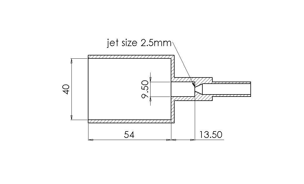

It is just a simple cylinder with a very large jet at the bottom of the cylinder. I do think that the jet size can be a lot smaller and a smaller cylinder can be used. Atmospheric propane burners are very limited in what they can do , so compressed air can force a lot more heat from a propane burner.
I will have to work out how I can post a cad drawing on mad modder.
I do have a atmospheric propane burner and it has a plate in the burner with lots of small holes drilled in it. I think they are called diffusers.

                       This is one I want to make. I use propane in my crucible furnace which has a burner  having a 1 mm jet size, and  normal air funneled in through a venturi.  What air pressure is required to suit the burner you are using?

It all depends on how much propane goes through the torch. 4 to 5 bar would be plenty, I had it up to 8 bar and it will blow out the flame if too much air is turned on.
Here ya go vtsteam I made a drawing of the burner.

Thank you Ironman! I will definitely try it.
