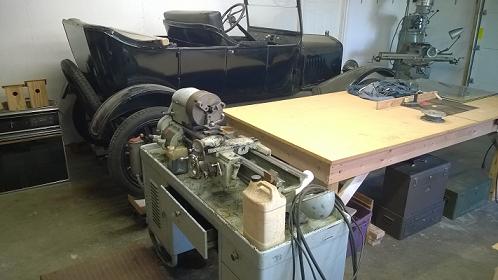

I went out to the shop tonight and snapped a quick pic. Sorry for the mess, it started raining last weekend while we were working outside so we quickly parked a bunch of stuff in the shed that normally wouldn't be there. Plus, some of it is for sale on Craigslist. The only big thing in the shed that I have to make room for is the model T, and I'm working through an idea on how to safely work around that...
This picture was taken through the smaller of the two rolling doors. The doorway into the second half of the building is visible on the right, next to the borrowed table saw that I need to return.
The first step will be to clean this up!

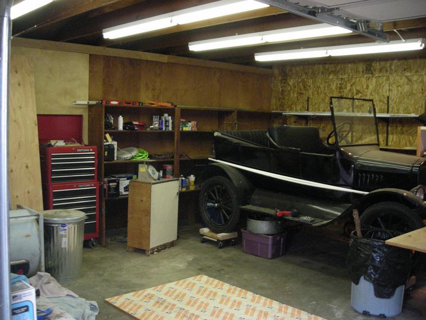

I'm back! It's been an exciting several weeks here. I took a job closer to home than my old one, and have been spending most of my time finishing up projects at the old job before my last day. I have this week off before I start the new job, and have been using the time to finish up the house's to-do list. That list is now history and I have time to work on the shop for a couple of days!
The lights are working! I've got four 8' fluorescent fixtures installed, and boy what a difference it makes! The bulbs are T12's and aren't as bright or efficient as the newer T8's, but they'll work just fine until I get new ones... and they were free. When I can get more of them, I'll install another bank of 8' fluorescent fixtures on the ceiling above the doors. They'll need to be on their own circuit because when the doors are up they block most of that half of the shop's ceiling. There's no sense having them on at all when the doors are up.
I've been accumulating wood and hardware when I find a good deal on a suitable piece, and have been clearing the junk out of the shop slowly. Thank goodness for Craigslist! :)
Tomorrow I'll finish the work table that I started today and will start tearing plywood off the walls so I can start running electrical wires.

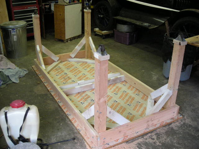

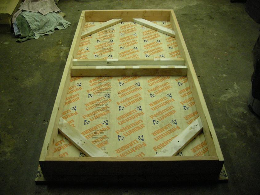

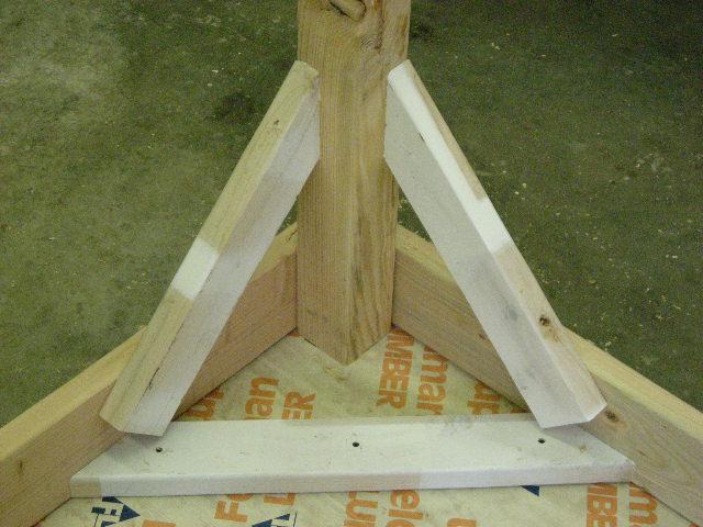

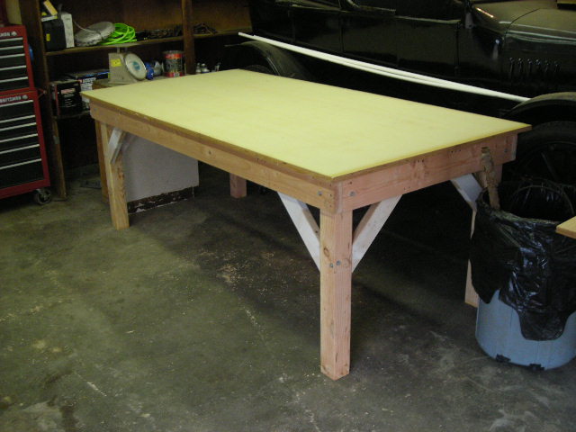

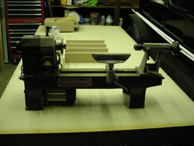

Well, I only got the table done today. It isn't a work of art, but round objects don't roll off of it of their own accord, and a good whack with a mallet doesn't immediately reduce it to kindling, so it's good enough for me! I put casters on it originally, but didn't like how high the table was with them, so I took them off. I don't want to just cut the legs shorter and put them back on, that's too easy. I'll figure out a way to incorporate them back in.
Today, I was also able to pick up my brother's wood lathe, he hasn't used it in years and is willing to lend it to me indefinitely.
Anything is possible when you forget what's impossible.

Now that's a good table! I guess 3/4" MDF for table top, 1x4 for the rails and 3x3 or 4x4 for the legs? Sure looks sturdy enought for a workshop.
Keep up the work, I'll follow this thread!
Kjelle
Offline rockknocker
  • Posts: 53
Re: 24' x 35' Workshop Project
« Reply #35 on: December 01, 2013, 09:09:21 PM »
Actually, the table is a bit larger than the pictures make it look. The top is a 4x8' sheet of 1" thick plywood. I found some that is normally used for concrete forms so one side is smooth and hard. The legs are 4x4's and the rest is 2x6 and 2x4 construction. The critical joints are both lag bolted and glued, the rest is just screwed together. The plywood surface can be removed from the frame (for flipping or replacement) by removing some screws. When the top gets rough from use I'm thinking of installing a sheet of white laminate countertop material.
The wall-mounted workbenches will be made similarly. I want to put most of my tabletop machines on the wall-mounted workbench, so it'll need to be sturdy.
If I end up using the table with electric tools a lot then I may add outlets to the table as well.

You'll need a forklift to move that table!!! :)
  • Posts: 537
« Reply #37 on: December 02, 2013, 05:44:33 AM »
Well that saves bolting it down!

Well, it's time for a long overdue update:
I've been using this shop for projects for quite some time now, even in it's partially-complete state. I have a decent workbench built along most of one wall and my tool storage has improved somewhat, but unfortunately not much progress on the shop itself has been made. Working on projects has been getting in the way of working on my project space...

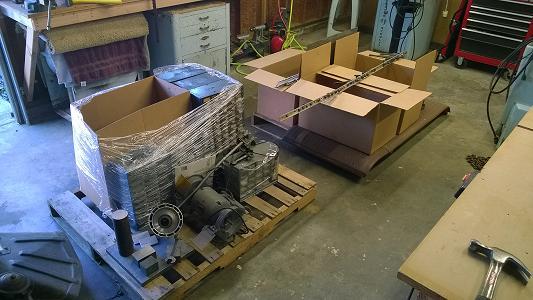

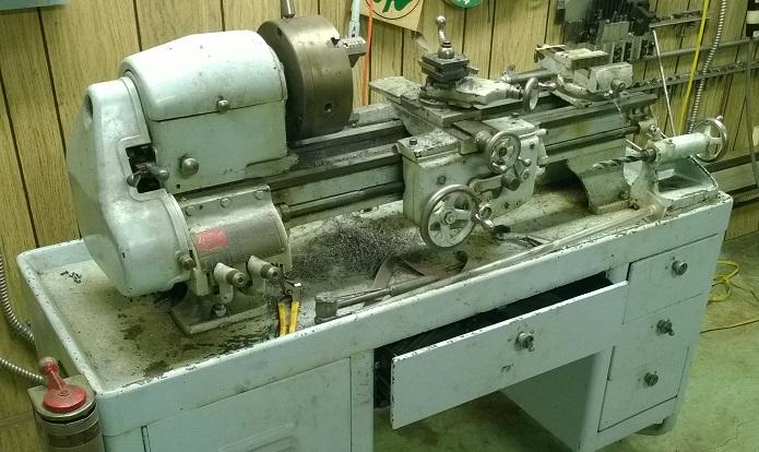

This is due to change. I recently posted in another thread that my brother is going to move some metalworking machinery into my shop for (at least) the next couple of years. Because of this, the shop is getting re-organized and the long-term plan for it is being modified some. My brother came over this last weekend and helped out for a few hours moving shelving around and preparing for next weekend, when we plan on moving the machinery in.
I've posted a picture of one corner of the shop, along with some pictures of the bigger tools that will be moving in. I'll try to get some more pictures up this week as I work on it after work.

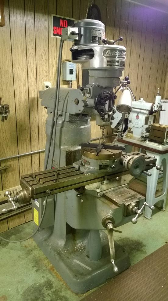

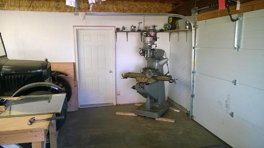

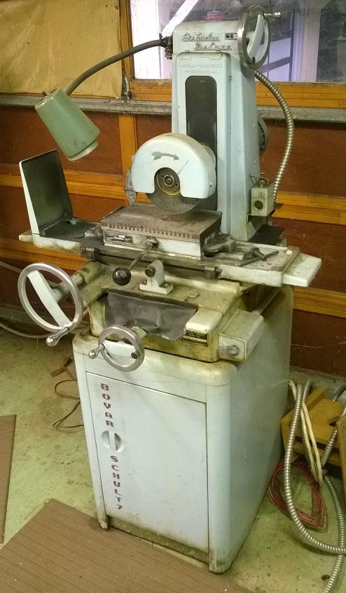

The mill is in its new home, and just needs to be taken off blocks and shimmed level. The lathe is also in and living in a temporary spot, once my garden shed is up some more space will free up and the lathe will end up along one wall.
The shaper, grinder, and horizontal mill are in the corner for the time being, I'm not sure what the plan is for those machines. I'm almost certain the horizontal mill is going to be sold. Anybody interested?
Regarding the floor, I did some research and skimmed through an old army manual on cement floors. There are many people working on thinner floors than mine with much heavier equipment with no issues. I'll risk it.

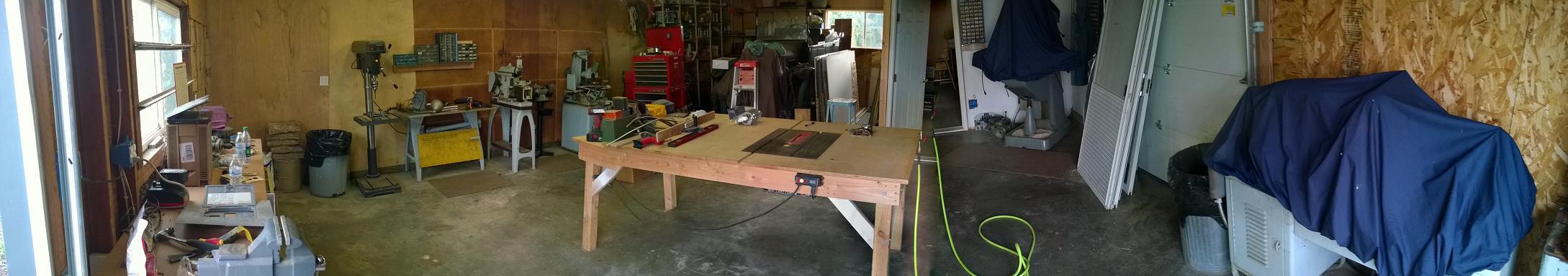

I haven't done a good job keeping this thread up-to-date... The shop has been finished (or nearly so) for about a month. With some help from my brother (who was anxious to start using his newly purchased machine tools), we ended up ripping out most of the wall dividing the two halves of the shop. We left some of the wall in place, but cut it short and turned it into a much smaller office. This allows me to move the model T and all other "storables" into the newly created space, massively increasing the amount of floor space available to work in!
With that done, we insulated all the walls, added 110V and 220V outlets to every wall, and buttoned everything back up. We also threw out or donated a lot of items that were taking up space, mainly "future projects" that I would likely never get to. The metalworking machines were all moved to their final resting places and wired in. There are a few small things to finish up (and there always will be), but for the most part everything is working!
I've attached a panoramic picture of the shop so you can see how it's turned out. Ignore the odd angles on everything, those are artifacts of the panoramic photo app on my phone.
