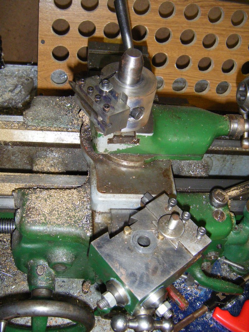

Hey Darren, I`ve viewed this topic many times over the last few weeks as I have been concentrating on my workshop and machines and getting everything running as I want it before I go any further with engine builds etc. I have decided to make a QCTP like this and just have a couple of questions. I`m going to be using a round bar of steel rather than a block like you did, only because that is the scrap I found and was given free from the scrap heap!
1. Can I ask about your off centre bore in the main body of the tool post, was this simply to give more clearence when the two sides where taken down to size? I guess if it had been central, once the centre spigot and cam were fitted it would have got near to the edge of the dovetails/sides right?
2. Also, most QCTP have two sides each dovetailed to accept a holder when needed for turning or facing, so a side on the left and a side on the front. I noticed that you have cut flats on two sides but only dovetailed one. Is there any reason you didn`t put a dovetail on the second side so as to gain to working faces?
3. The dovetails themselfs are 60deg or did you use 55deg because of your cutting tool - either way, I mentioned a 60deg dovetail in my latest thread here: http://madmodder.net/index.php?topic=1731.msg17115#new and Jonny gave a reason why it may be more suitable to use 45deg dovetails. I`ll be honest that I`m still not 100% sure why I would have to be more accurate cutting 60deg dovetails than 45deg dovetails but if this is the case, do you think the 45deg would be more suitable?
Anyway, hope you can help. I wasn`t a member on here when you posted this thread so just wanted to say nice job and hope mine turns out as well. I`d be chuffed if it did!

Re: A thing.....
« Reply #28 on: September 07, 2009, 04:54:13 AM »
Really....., well you don't seem to have understood it very well cos most of what you wrote is wrong......... :whip:
Most of the answers to your q's are in the posts, have another read, slowly this time, and come back with anything you are still unsure of and I'll only be too happy to help.. :thumbup:

Chris,
I think the following is right but somebody please correct me if I'm wrong!
On the accuracy thing, I think Jonny is right in that you would need to be more accurate machining the 60 deg dovetails. Pythag tells you that with a 60 deg dovetail, say if you make the dovetail 1mm too wide (exaggerated for purposes of explaination) that will allow the holder to move 1 x tan60 outwards, i.e. 1.73mm. With a 45 deg dovetail, 1mm deviation would allow the thing to move out 1mm, since tan45 = 1.
Also, Jonny mentioned repeatability. When you clamp the holder up with the 60 deg dovetail the variation on how far it pushes outwards is likely to be greater as a smaller component of the force is acting directly inwards. As he said, difficult to explain, will try to knock up a CAD sketch for you tonight if you are still struggling.
Although it never occurred to me before, 45 deg would be better.
Nick

« Reply #31 on: September 07, 2009, 08:23:35 AM »
Chris I am not unwilling at all, it's just that it seems you have not read the thread and it could answer most of your questions?
Here goes then...
I didn't use a block, I cut a section from a round pin
My round bar was not big enough for two dovetails (you don't need two anyway) and I gained more clearance for machining by offsetting the mounting hole
Explained above
I didn't use 55deg dovetails, I made 60deg ones....it's in the text.
Hope that help Chris.... :thumbup:

« Reply #32 on: September 07, 2009, 10:27:58 AM »
Chris,
I can't see the advantage of having 2 dovetails either, you can just swing it around the other way if you really need to and turn the tool round in its holder.
Nick

« Reply #35 on: September 08, 2009, 12:28:43 PM »
Hi all.  IIRC 60deg dovetails are preferred for mill tables and such because they have a larger bearing surface than 45deg, larger oil film, better wear, etc.  That being said I don't see why a 45deg wouldn't work fine in a toolholder.  I had a (homemade) 2 dovetail holder on my 9" SB and it was handy, but it was also bulky and a real PITA when working close to the chuck.  It has since been replaced with a single dovetail unit which works much better (and needs painted ::) )
Thanks

I think you will find that there is a reason for having two lock on faces for a modern toolpost.
As previously mentioned, the dovetails are usually 60 degree, that is to give more surface area for clamping and so aid rigidity.
Now to the two sides.
Having a single sided holder and swinging it about is harking back to the days of lantern toolposts and HSS or carbon ground up tooling. This is where the tool tip is swung about until the angles and height look correct and the tool is used like that.
The modern way of tooling use is the tipped variety, and they really do rely on being set at the correct angle to the job for them to cut efficiently. Thousands of design hours have gone into doing just that. So the toolpost is set to 90 degs for one face and  parallel to the workpiece on the other, then locked up solid. I find that using this criteria for ground tooling works just as well, and only requires the toolpost moving on very rare occasions, just to give me a bit of deep cutting clearance.
Look at almost any good tipped tooling set, and you will see they have shaped holders. When those are mounted into a squared toolpost, the tips of the tool are at the correct cutting angles to the job, and should be left that way.
Bogs
