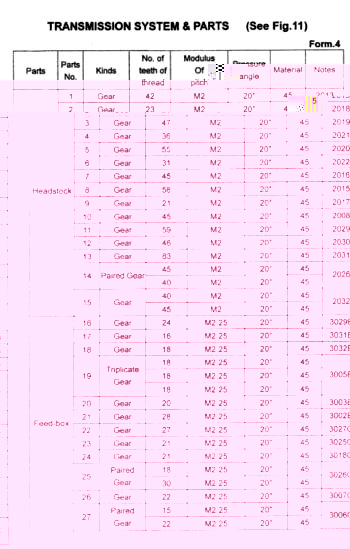

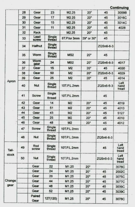

John, Mr Bagstandand Sir!  What size change gears do you have for your lathe?  I am ready to plug those into the program.
bogstandard
Re: Calculate thread pitch and feed rates...
« Reply #12 on: March 25, 2009, 06:16:36 AM »
Hi John,
These are my bits.
Paired gear - 127/120
Other gears - 22, 24, 26, 44, 48, 52
Leadscrew - 3mm pitch
It will be very interesting to see how things turn out.
I have also attached scans of my gear layouts for the lathe, to see if they match up with yours.
