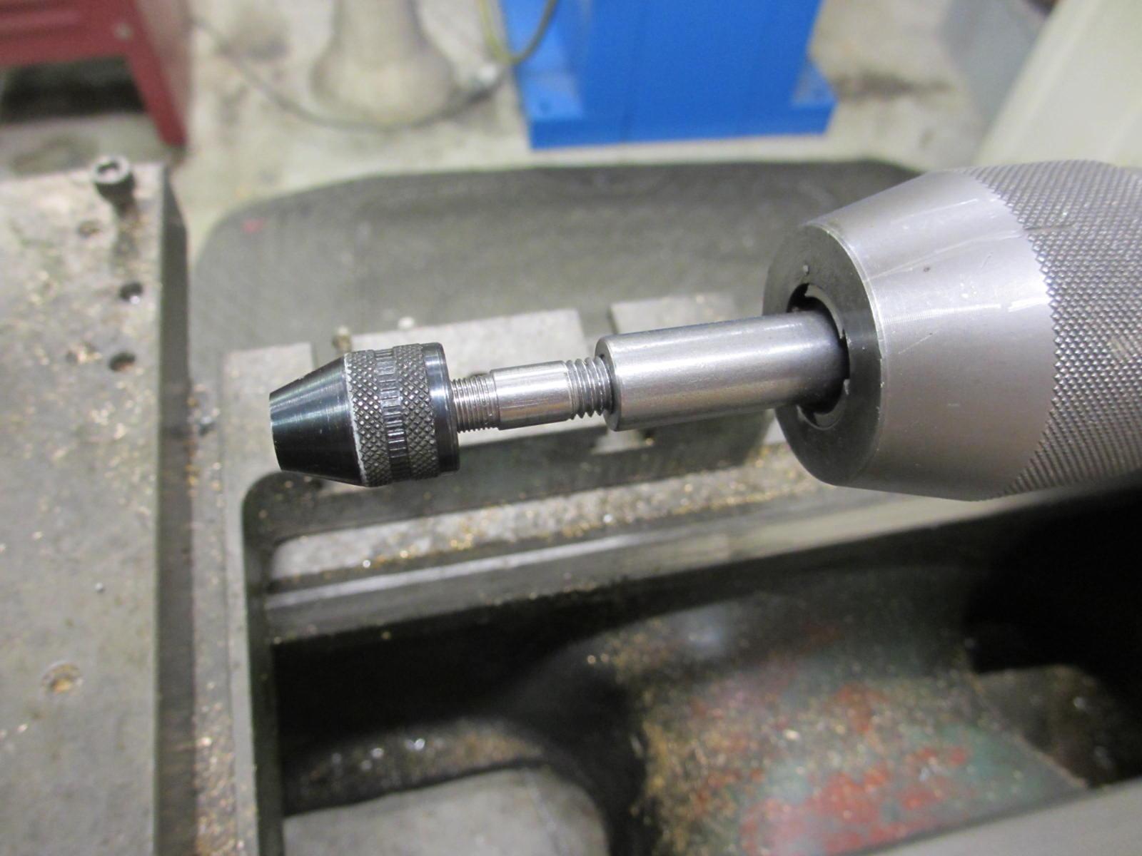

Not quite peck drilling but along the same lines.
I have one somewhere and I'll try to find it for pictures but it's that simple I can do this in DoC [ Describe O CAD ]
This is meant for very small drills that have a tendency to snap easily, I built mine for drilling tiny holes in 99.9% pure copper which is a bitch to drill as it very grabby and ANY slight play in a lever operated system will do just that.
First take the holder to fit into the tailstock, usually a MT blank, fit it into the headstock and drill it and tap it something like 1/2" x 20  two inch deep, nothing critical other than it needs to be dead square.
Then make up a piece to hold a small Jacobs chuck. This needs to be 2" long of 1/2" x 20 thread with a large diameter knurled ring at the end then a short taper for the chuck.
That's it......
In use screw the two pieces together and then unscrew a few threads, offer the drill to the work and advance the drill by turning the knurled ring gently.
If the drill tries to grab it will screw the chuck BACK into the holder and not into the work and so save the drill.

It's one of those questions: "what do you do when you have broken all your 1mm drills, can't finish the job and the shops are shut"?
Answer: make the drilling device that you have been intending to make for ages.
Obvious really. Who would make it BEFORE starting the job?
It took about an hour including the time taken to google the Dremel chuck thread size.
Jim

Since you're holding yours in a chuck, Jim, seems like that version will work in the drill press, as well.
Offline AussieJimG
  • Posts: 381
Re: Sensitive drilling
« Reply #9 on: September 15, 2013, 01:18:15 AM »
No, it won't work in a drill press because you advance it by turning the bit with the thread. This one only works in the lathe.
There is another type similar to the quill in a milling machine with a ball race for you to hold and move the chuck up and down. I was actually looking for that one when I came across this much simpler one the blew me away with the ingenuity.
If you find the other one, let me  know because it could be useful when small drills needing high speed are used.
Jim
