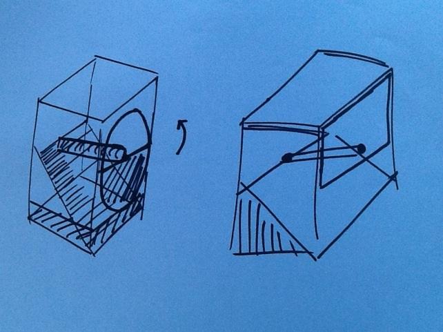

« Reply #6 on: September 16, 2013, 02:10:41 PM »
Your ideas inspired me into this... A rotating front. As mentioned, the slope causes cons to be pushed onto the front face, the front spins and when the cutout gets to the coins allows them to spil.
However, it is doomed to fail! Also, being Perspex I have to understand my limitations with playing and modelling the material. I'd fail cutting a circular front for a start. The square front wouldn't rotate well enough.

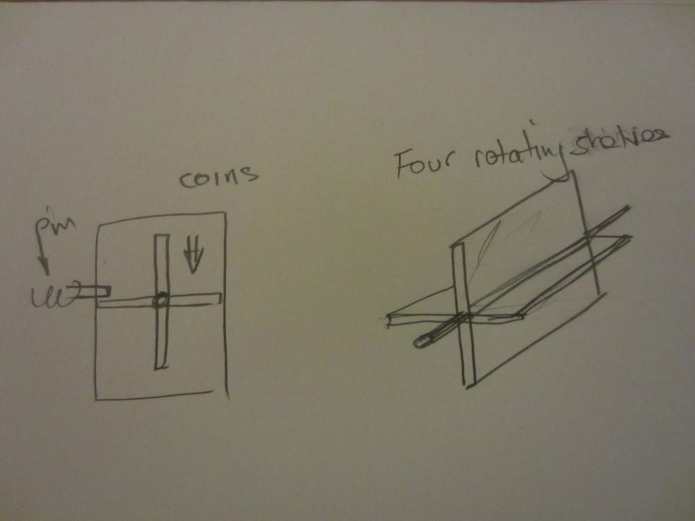

« Reply #7 on: September 16, 2013, 03:19:28 PM »
One way is to have rotating shelves - 4 is probably the easiest. The weight of the coins would cause to shelves to rotate. A "pin" operated by a solenoid can hold the shelves in place. By with-drawing the pin the  shelves will rotate and drop the coins. The pin when returned will stop the shelves from rotating.
Something like this.
DaveH

« Reply #8 on: September 16, 2013, 03:29:34 PM »
Dave, I like the idea for sure as it is easy to implement but there is an awful lot of dead space and consequently the compartments would have to be large to hold all 25-50 coins and with 3 of them empty at one time. Would it work in two halfs - issue would be ensuring there was an imbalance to one side to cause it to tip.

« Reply #9 on: September 16, 2013, 04:03:19 PM »
Hi Chris,
It could work with 'two halves' (I think). The main problem is getting back to the starting position. If one half was heavier (a small counter weight)  than the other half it would allow it to rotate back - a small stop will be required. One shelf could be much smaller than the other but one will need to be heavier to make it rotate back to the start.
Just needs a bit of thinking "outside the box"
