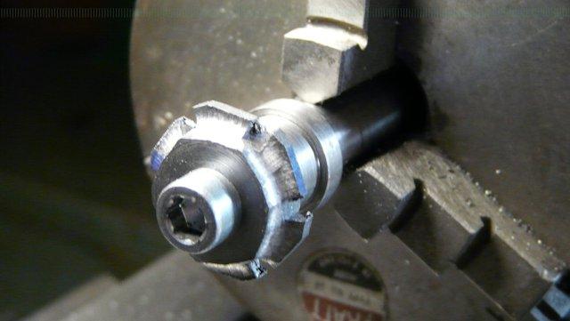

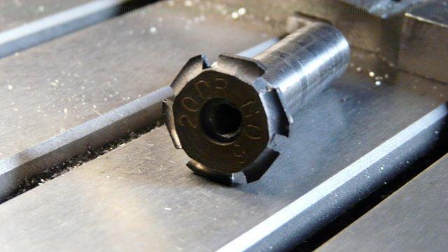

Some time ago I read an article about making gear cutters on a lathe , using two pins a set distance apart I found a program on Marv Klutz's  web site that works out the size and distances for the pins and the in feed , I made a couple and they worked , looking at them I thought that they could be made on a mill with a indexing head a lot easier using an end mill , the re-leaf angles are 15 degrees as I used a 24 hole dividing ring and they work just as well .

« Reply #6 on: September 15, 2013, 01:50:34 AM »
Sorry Marv I am dyslexic no sleight intended , the cutter sort of worked the re leaf angle needs to be greater , cut a mild steel gear and the cutter rubbed 15 degrees wasn't enough ,
