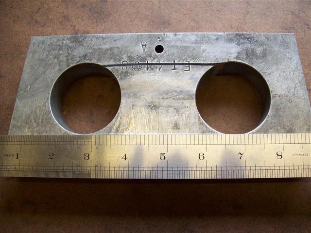

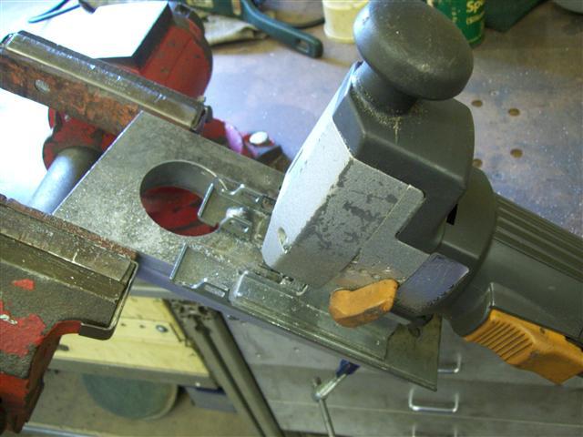

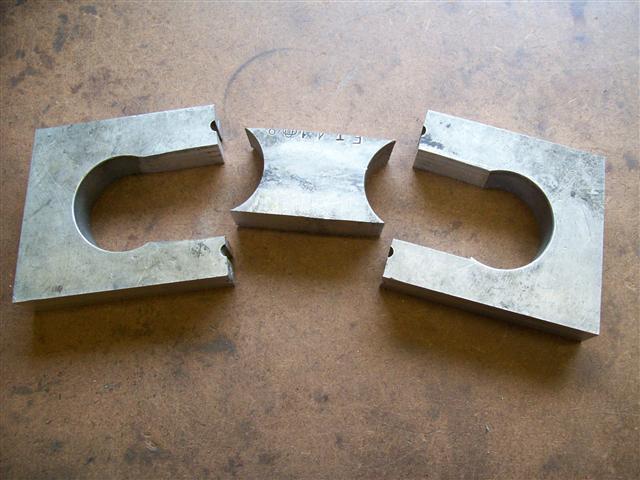

You probably have the design for a tramming aid in mind but if not you might find the one I made helpful. I made the three bolt mod first but still had trouble keeping the tram as I tightened the bolts. With the aid that is no longer a problem. I can now push that last half a thousandth and hold it there as I snug up the bolts. Here is the sketch.
And how it looks on the mill.
Don,
 The bad news is that the three bolt mod is an absolute must if you expect to hold tram. The good news is that there are two "Tee" bolts that come with the mill which are the exact size needed. (They could be a bit shorter though)
Joe

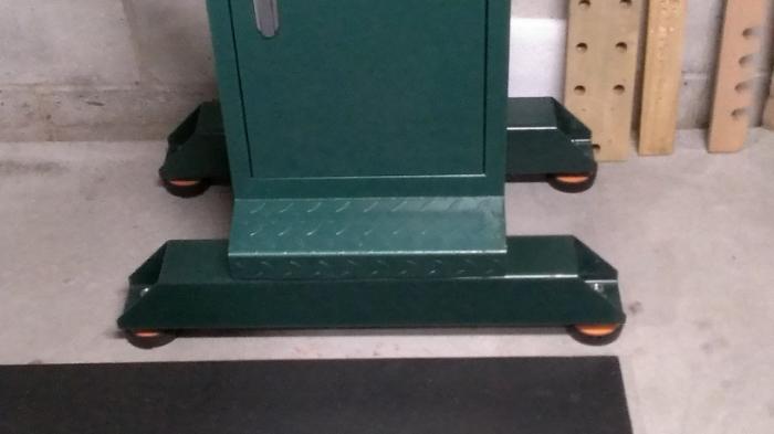

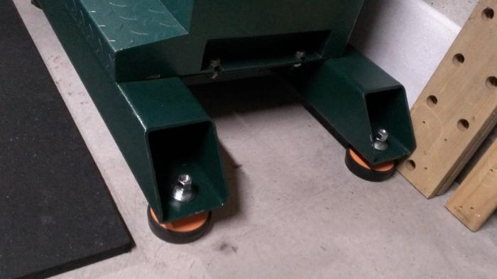

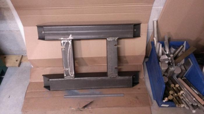

Older thread but wanted to show my mill base. Idea from 75 plus. Thanx Joe !!
 I used 4x4 tube steel 30" wide and 3' angle iron. My drawing is the word doc attatchment. Then put leveling pads on. By the way I'm 6'-2" and it fits great !!!
