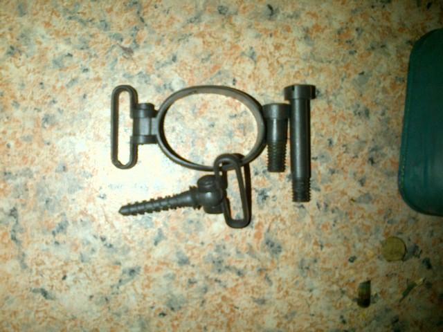

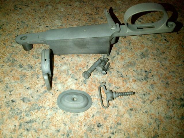

In the photos you can see that I sandblasted my mauser rifle parts before coating them, they came out really nice and then my tangential tool holders that was also coated.

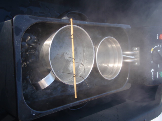

I used a cheap deep-frier, it had all the works I needed. Vat, thermostat, immersion heater. I used it as baine marie to bring it to a rolling boil and one vat of parkerizing solution was brough to 92C something....IR thermometer was not very reliable on these, but I found very cheap and good enough caramel thermometer from cookingware shop.

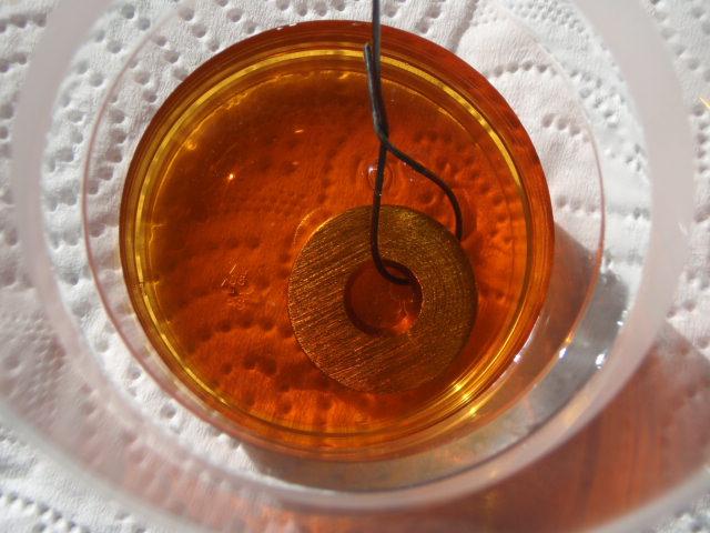

I etched the part 10 mins of "preblack solution" that consist raw liquid fertilizer and 3% of phosphoric acid at room temperature (about 20C). Then hot water rinse of 10 minutes before dunking into park solution.
The fertilizer was NPK 13-1-3
Sorry the choice of languages
http://www.nelsongarden.fi/prod/Giva-Grass-GTI-25l_374331/Kasviravinteet-Giva_47979/FIN/SEK#
Burlap tells that the Nitrate is 4%, ammonium nitrate 3% and urea 6% plus 1% P and 3% K. This was pretty much the only form of nitrates I could get.
I made some notes of using also 3% HCL 11 min. It did react, but had no apparent effect on end result with tempering steel.

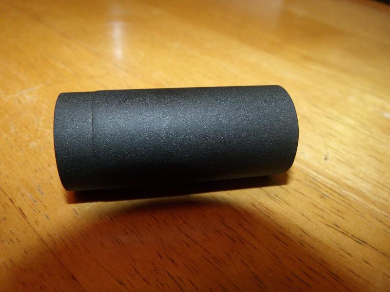

Cured classical way. Funny thing was that first 90C park did not produce very black, but next 92C experiment produced flocking mentioned often and made very nice jet black parts.

Park with deep frier
Several end products, the one on the top with fertilizer pre-black
The preblack solutio with example, as you see I used sanding not sand blasting (I don't have sand blasting equipment).

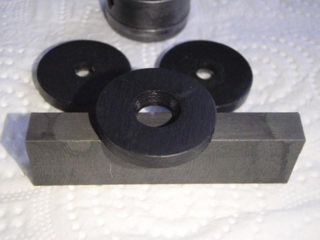

Here we go with the second attempt. Andrew put the idea in my head that I probably had used too much acid and had caused the surface
finish problems so I reduced the acid content to 60 : 1 ie. 50cc of acid in 3 litres of water. This was mixed over 5 tea spoons of manganese dioxide and a piece of steel wool about 100mm x 25mm x 20mm. (not very scientific I know but it will do for now).
After a bit of internet reading I decided to let the acid dissolve the steel wool before heating the mixture, after a few mins. fizzing all the steel wool had vanished and the mixture was heated to a simmering/boil.
The parts were dropped in and 20 mins. later were removed and rinsed in hot water.
Result, A lot blacker than last time but still a change to the original surface finish, this time the finish was about equivalent to 600 wet and dry using the thumb nail test.
So at this stage I am thinking less acid in the mixture will have less of an etching effect and may help to preserve the original surface finish.

Your and mine experiments conform few things:
* Too much accid etches. If you look old recepies final accid contents is pretty small and much spent on aging. There seems to be benefit of adding up clean water to replace evaporated water.
* Some sources claim that the water quality is important and copper/zink ions?? chlorins, carbonates or something should be avoided. I have used battery water, but read a lot of pro/con, looks like local water and it's treatment are very differet from place to place.
* Surface preparation and cleanless is very important. Some instructions go pretty deep with sand blasting, even down to sand and air quality.
* I noticed that faster you can process from surface prep, better it is.
Then one variable is this "aging" with homebrewn park. I noticed that that I get better results if the park is brought to boiling point and kind of flaky things start to circulate (Flocking). Then I preheat the piece on "rinse" and then bring it into park to "boil". Can't remember exactly, but I made some experiment with the same metal/park/time ,only changing the temperature a little bit and least on my thermometer under 90C it did not work, and worked between 92-96C.
Industrial parkerizing solutions seems different breed.
