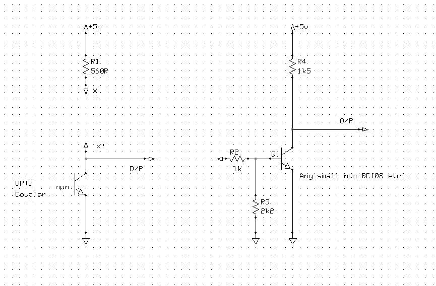

Well the hopper arrived and I've just had time to play with it for the last hour. Took me most of that time to source a suitable connection to try it out at midnight!
Anyway, hooked the 12v line and ground up to my power supply and sure enough it started spitting out 10p coins at a good rate!  :D
So as far as I can see, although the socket is 9 pin, there are only 3 pins I'm interested in. 12v, gnd and optical sense output. The other pins are 24v (which I pretty sure from what I've read is just to give to the option of powering at 24v since that is the source in some machines), two pins for low coin sensing and three redundant pins - all of which can be ignored.
Again from the Internet I have realised that it is the job of the "controller" to count the optical output and therefore how many coins have been dispensed and shut off the 12v supply.
So the big question for me now is how do I read the output of the optical sensor? Will it be a digital 5v pulse and more specifically, if I am using an arduino, what would the code commands be?

1.5 Coin counting
Coin counting speed is 6 to 7 coins per second. All paid out coins pass by the optical sensor indirectly. The coin exit output changes from high impedance to low impedance status.
This output stays high as long as the hopper is in the “Off” status (power disconnected).
When a coin appears at the counter pawl under the exit bridge the PCB controls the coin verification and releases a logic signal. The opto-coupler and the counter pawl detect paid-out coins.
Payout signal: open collector NPN - active low, maximum sink of 25mA at 35Volt maximum. Minimum time obstructs optics 30ms - minimum.
Time between coins: ±100ms
Re: Turn on 12v DC with logic PIC output.
« Reply #14 on: August 11, 2013, 04:12:21 AM »
Hi Chris
What you seem to have is the lower left ..
The collector is open, so you need to put a load resistor in there connected to +5v.
That is R1. Connected from X to X'. Top left.
This will give you 0V to 5V pulses from the O/P.
560R will allow some 9mA or so current. Well within the 25mA max.
As I read it, the O/P is 0v when a coin is present ???
If you want a positive level, it needs to be inverted, so the basic single transistor inverter as per right will do the job.
Any small signal npn transistor will be OK. Nothing critical about that.
Doesn't matter if you input it to a PIC of course, code will take care of that, just poked it in anyway...
NB ... the emitter of the opto-isolator may not be connected to 0V if it is truly DC  isolated, so the 0V I have shown connected to it may not actually be connected to 0V in the coin mechanism, so the emitter must be connected to 0V on whatever logic doins you nail to it. Otherwise you will have no 0V reference and the O/P will be heaving and thrashing about all over the shop.

Hi Dave - many thanks for your effort but I am going to go down the microcontroller route since there are a few others uses of the arduino that are going to be in the machine.
I tested the output of the optical line output tonight with my logic probe. I know this is what I was expecting to see, but it was still pleasing to see this happening!!
