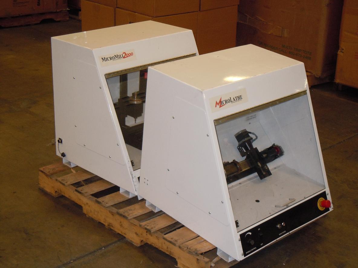

So I'm in the market for a CNC mill and ran into a deal I couldn't pass up.  It's a sherline CNC lathe and milling macine that I picked up on E-Bay for $149.00 for BOTH machines.  I still have to work out shipping, but hopefully I can have them shipped for under $300.  I'm not sure what I'm going to do with them yet as I already have a nice CNC lathe and the mill is smaller than I want.  I might retrofit them to work with Mach 3 and then sell them locally or keep them to play around with.  Guess I could use the lathe as a second operation lathe and play around with the mill until I can find something larger.   I could get the Y axis extension kit from A2Z CNC which would give me 11" of travel and then the mill would work out for my projects.
Here is the link to the auction.  Let me know what you think.
http://www.ebay.com/itm/130963721355?ssPageName=STRK:MEWNX:IT&_trksid=p3984.m1439.l2649
Dale P.
Here is a picture of the machines.  I wish I had some pictures that showed the inside as I really want to know what it has inside for stepper drives.  Hopefully they are good enough where I can just add a new breakout board and get them running with Mach.

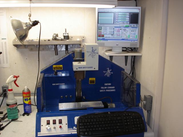

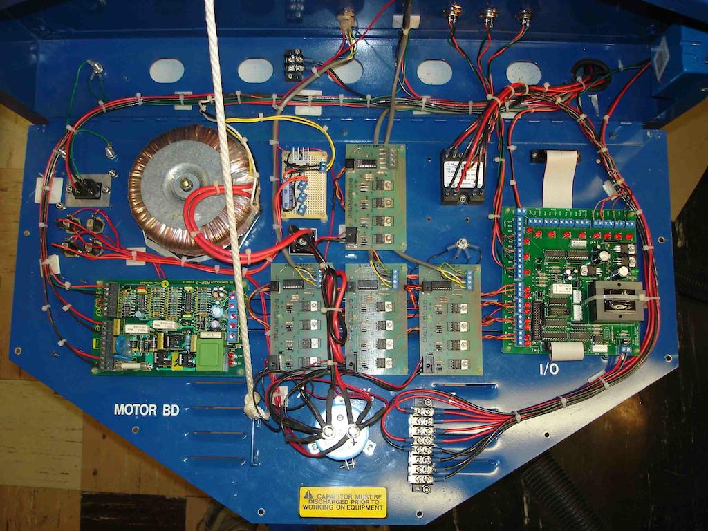

Yeah I had a D&M mill in the past which is pretty much the same machine as this new mill.  I retrofitted it to work with Mach 3 and was disappointed with the performance so I sold it.  The largest problem was the Y axis only had 3" of travel. I also re used the D&M motors and drives and they were really weak so it was easy to loose steps which was really annoying.  This new machine has 5" of Y travel which makes it more usable.  Hopefully the drives and motors are a bit stronger than the D&M machine.
I'm still not sure what I will do with the machines.  I'm pretty sure the lathe will get a cheap breakout board installed so I can run it with Mach and then post it on Craig's list.  I will keep the mill for a while until I can get a larger one.  Perhaps I will even keep it just for engraving and such.
I would love to see some pictures showing the electronics for your denford mill if you have any to send.  Not a big deal if you don't have any.
Here is a picture of my old D&M mill.
Dale P.

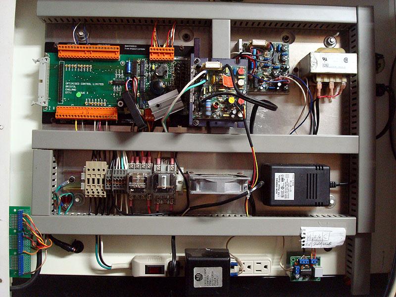

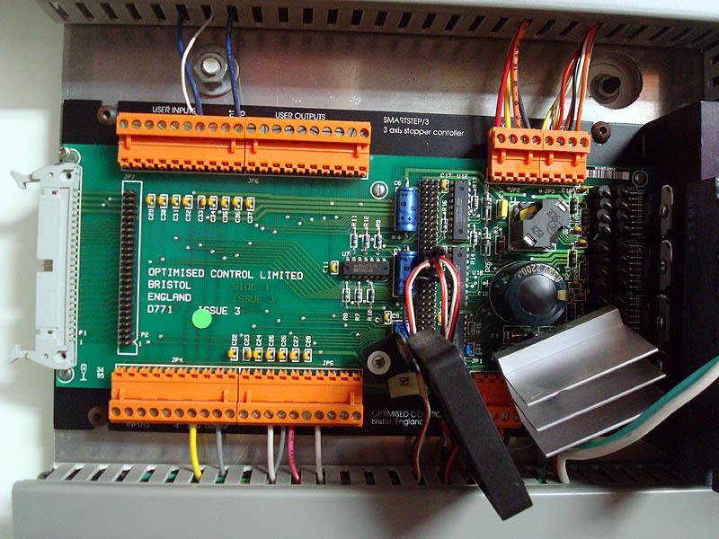

Here's a couple pics of the elec. stuff Dale.
Bottom left: cheapy non-opto isol B.O.B. - Center bottom: power strip - Bottom right: CNC4PC C3 Spindle Index Card - Top left: SmartStep3 stepper controller (see other pic) Top center: extra KBIC-120 speed control (ran a homemade add-on ER32 lathe spindle w/treadmill motor - Top right: 24VAC transformer (supplies powder to S/Step3)
The bridge rectifier on the board burned out so I replaced it & added a heatsink & extra fan to make it last.  The red/white/black wires in the center of the board are Futaba r/c servo connectors that go from the 96 pin header over to the B.O.B.  The proprietary serial board used to go in the open area on the left side of the board.  The stepper output wires are on the right.
I think yours will have a similar but later version controller

Thanks for the pictures.  I thought the machines were going to look more like my old D&M mill, but I see the stepper drives are a lot different.  I hope they are a lot stronger than the D&M drives as it was really easy to make the mill miss steps.

Dale I wouldn't waste any money on new electronics as the Sherline hardware is the weak link.  The supplied steppers & driver will be great if they are working OK.  Shouldn't have any missed steps problem unless you try to make it go too fast or make heavy cuts.
I nosed around a bit and I think yours will have a "Denstep" controller (similar to my SmartStep3) which should work with step/dir input once you've ditched the serial sub-board.  It will have at least 2A @ 40V output, maybe more since the pics I found show a much larger power transformer.

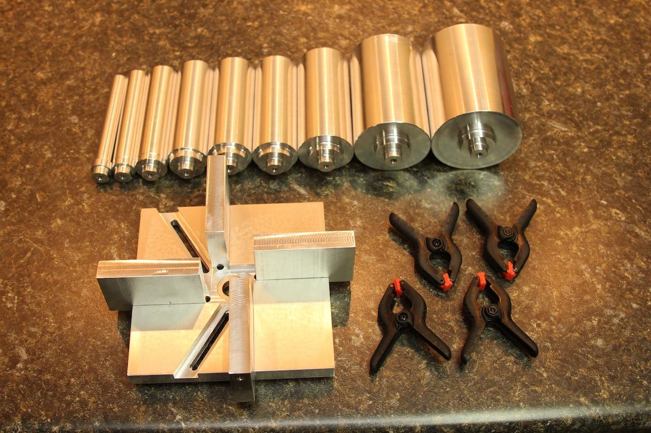

What I need is a mill to make up these base plates, but i'm sure the sherline mill is too small to cut something this large.  The slot is 1/2" wide and 1/4" deep.  I would love to make the base plate out of machinable plastic, but I tried looking at different types of plastics and have no clue about what would work best as there are dozens of different types of plastics on the market.
Dale P.

That's a lot of material to remove for a Sherline.  A one-off with a willingness to invest much patience & time maybe but production...no way.
Acetal/Delrin plastic machines beautifully but is more expensive than aluminum.  PVC plastic machines very nice and is not too expensive.  Here's a cheap piece you could try out: http://www.ebay.com/sch/i.html?_odkw=pvc+rectangle+stock&_osacat=0&_from=R40&_trksid=p2045573.m570.l1313.TR11.TRC1.A0.Xpvc+sheet&_nkw=pvc+sheet&_sacat=0

Yeah I know the parts too big for the sherline, that's the problem.  I keep looking for a good machine that fits my budget but so far nothing works out.  What do you know about Dynamite 2400 mills?  There are two of them for sale in a government auction but to me they look to small too.
I spent a whole night looking at machinable plastic and couldn't believe the prices!  I thought they would be cheaper than aluminum.  The PVC prices are good, but isn't PVC bad for your health?  I would worry about the chips and dust flying around in the house.
