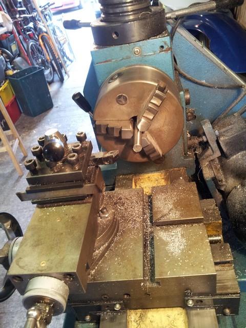

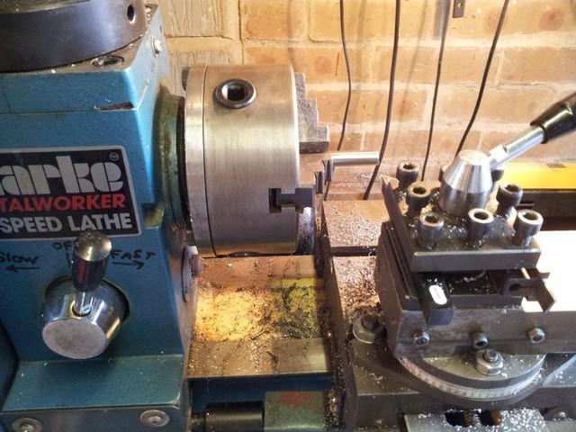

Hi i wonder if some one could advise me on an issue I'm  having regarding my lathe and the quality of the cuts.
I’ve tried cutting Stainless steel, Brass and alloy rods and the quality of the cut appears to be very rough.
I pretty sure the fault is me and the way I'm setting the machine up or possible using incorrect cutting tools.
Any help would be greatly appreciated.
Thanks
Kev

Pictures of tool-carbide,hss, cobalt, material finish, tool set up, part setup and held in chuck, speeds and feed information, depth of cut...
If carbide...nose radius of carbide...

The lathe is a Smithy mill/ drill lathe CB-1220-XL
At the moment I'm trying to make Drip tips out of 10mm SS and Brass rod, pretty much able to achieve the aim but the quality of the finishes is poor and requires lots of sanding.
The tools are very similar to these.
http://www.ebay.co.uk/itm/360423893257?ssPageName=STRK:MEWAX:IT&_trksid=p3984.m1423.l2648
Speed, sorry for my ignorance I don't really know.

I'm a relative beginner also, but from my limited experience I would say there is a good chance it could be the tools. When I got my mini-lathe about eighteen months ago I had similar problems with the finish, even on free cutting MS. I wasn't confident with grinding my own tools but after lots of encouragement on another forum I had a go and was amazed that my first attempt gave a better finish that the purchased ones. Since then I've ground all the tools I've needed apart from a small diameter boring bar which I couldn't get right so bought an insert-tipped one.

You have a set of brazed carbide tools or so I assume. At some point, they would be sharp but the question is how sharp are they now- which is what really matters. You have been using stainless steel which is a quick way to blunt whatever tooling you possess. Somehow, I doubt that you have facilities to recondition them as you will need diamond wheels and possibly finish the last bit of the work using diamond laps. So where do you go from there?
Frankly, if it was me, I'd either change my material or change my tooling. I'd probably do both but if you are stuck with stainless, I'd head off to buy the correct carbide inserts and tools and swop them when they got blunt.
Me, I'm a mean old Sassenach-  and use almost entirely high speed steel tooling  on ordinary steel or cast iron.

I worked for q well known UK importer who insisted those.brazed carbide tools were Just What A Novice Needs ( high profit margin...), they are in fact the machining equivalent of the Chocolate Fireguard...
Straight from the box, the edge geometry is unlike any tool I've known, they need sharpening and honing before use, once ready and used the edges crumble and.shatter in no time.... Decent (non-Chinese) indexable tooling is.worth the money, the Chinese stuff is really one-use disposable, in my humble opinion - great for taking the skin off an iron casting, but swap to HSS for finish /  accurate cuts.

Amongst all the invaluable advice offered I notice that no one has mentioned the importance of setting the height of the tool tip.
One of the simplest methods is trapping a thin ruler between the tool tip and the work (apply just enough pressure to hold up the ruler). If the tip is too high the top of the ruler will lean away from you and if it is too low it will lean towards you. When it is spot on the ruler will be vertical.
Alternatively line the tip up with the tail stock centre.
There are other methods that require equipment that is very simple but I guess that at this stage you do not possess. As you gain your experience you will come across a method that takes your fancy and that's the way you'll go.
Always set the tool height before you start turning. If you have a quick change tool they have built in height adjustment. Failing that have a selection of packing pieces to put under the tool. Funnily, when I first started out my "bits and pieces" box never seemed to yield the right packing pieces but it did not take long to accumulate a good collection. The arrival of a quick change tool post solved that .:thumbup:
Good sharp tool at the correct angles are essential but the cutting angle is only true when the tool point is exactly on the centre height of the lathe.
