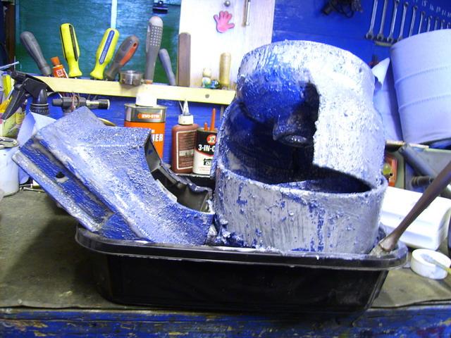

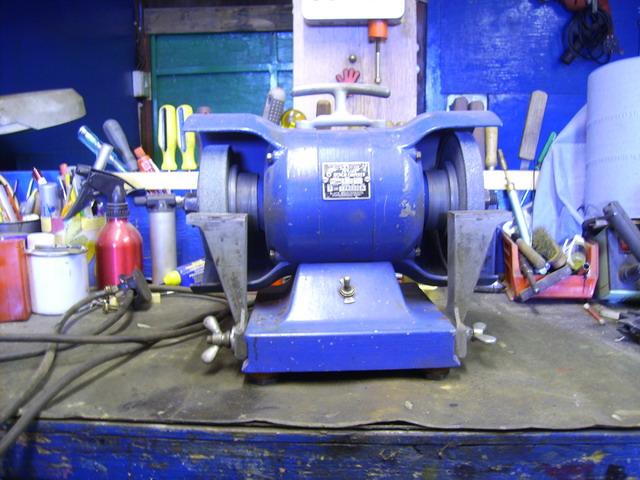

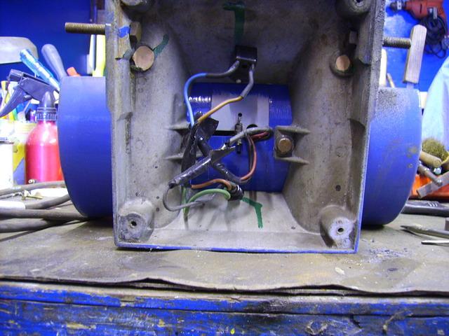

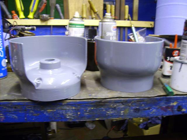

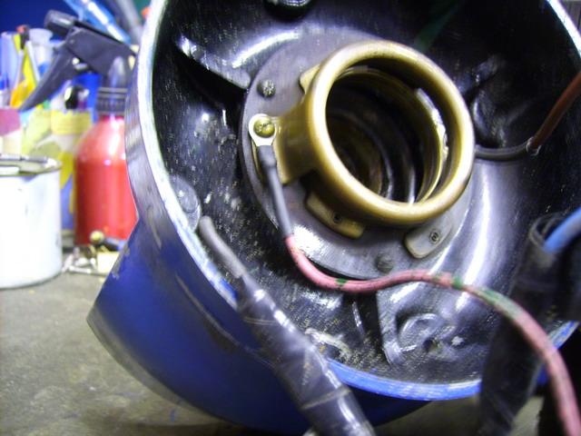

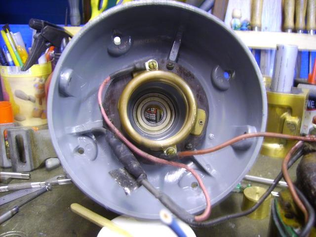

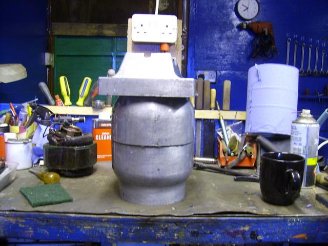

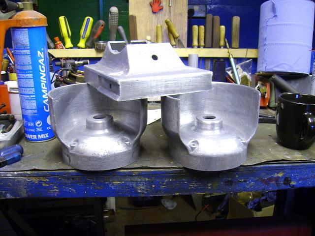

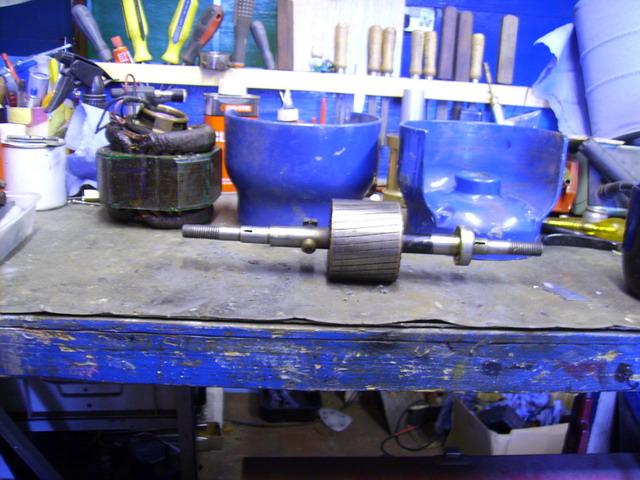

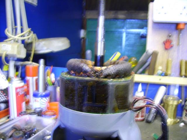

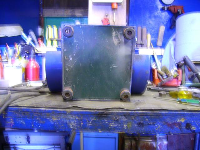

hi all well me bench grinder has bin making a strange a sort of sound when you first switch it on a hi pitched squeak then it wood go off at first i thought it may be one of the wheels out of balance but i put two new wheels on and still the same then yesterday the noise staid on time to have a dig in side the grinder is as old as me its a black and Decker 6 " well riped it a part all i can find was one of the Bering's had bin spinning in the housing so I'm go wing to replace the Bering's may as well wile its in bits and give it a repent went daft with the pant stripier all back to the aluminum my tips on panting aluminum well its more zinc than ally sum will say you need to use a etching primer i wood agree if it was proper aluminum but in this Case and any other smiler type of castings just give it a good sanding with 80 grit sand paper to leev the surface well ruff something for the pant to key on to and the next tip is where rubber gloves to keep your finger prints off and the next tip is wame the parts to be panted not hot just wame the pant will flow beater right pics

Very nicely done/ explained, Bob!  :clap: :clap:
It's ready for another lifetime of service now........  :thumbup:

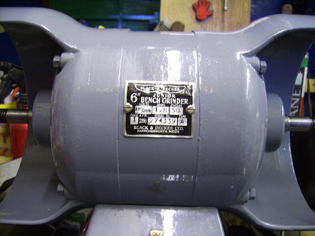

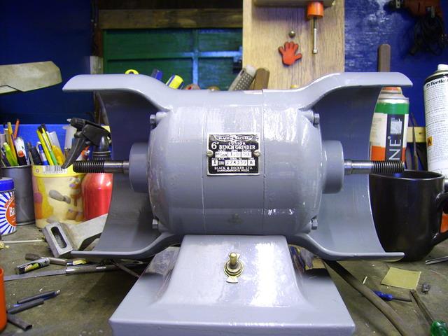

hi all last bit i got sum new bearings and put it back to gather and she is running brill pics
Re: bench grinder refit
« Reply #5 on: September 03, 2013, 02:17:59 AM »
Just like new!

ther is no dark art in panting if you wont a shoroom shine then her is the trade secret varnish pant as normel the longer you leev the pant to harden the beter put any wher betwhen 3 to 8 cots of pant it all depends on haw thick the pant is leev for a munth or two then sand back with fine scoch brite pad ones all the runs and brush marks are out get top qolity varnish and thin it dawn say 70 % varnish to 30% thiner and with a top qolity brush pant the varnish on you will not have a brush stroke in site and no runs and it will shine like new ther is no pont in puting the varnish on the pant with out it bin rubed dawn it will not mack it any more shiner but if you have wamd the parts up like i sed befor you will get a nice finish all inamel pants have a leveling agent mixt in to the pant  the thing that most  get rong is keep gowing over the bit they have just panted to get rid of brush marks or runs if you is geting runs you is puting to much pant on and by gowing over the same bit braces dawn the leveling agent so the pant ends up with brush marks hope this helps sum of you
