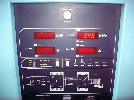

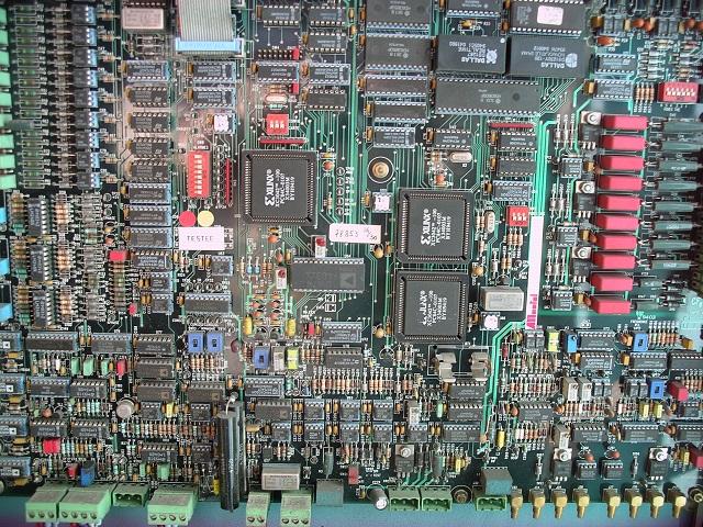

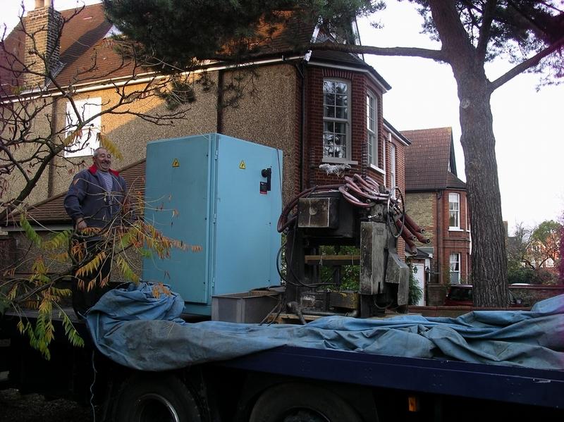

« Reply #7 on: August 19, 2013, 04:46:31 PM »
Mine runs at about 3 kHz. The electronics 'pings' the tuned circuit that comprises the coil round the crucible and the bank of capacitors in the drive unit to ensure that it's within it's limits, then sets itself up to resonate at the measured frequency by chopping the power electronics at the right rate. It then adapts to whatever charge is loaded into it.
Quite a bit of logic electronics as well as the power stuff. I have a 15kW water chiller to cool the water that circulates through the electronic unit and the coils round the crucible. Even so I have to be careful as it overheats quite readily. The capacitor bank is huge, with manually alterable links to bring various different inductance furnace bodies into its range.
Have a few pictures all dating from when I was at my last place. First picture is of it being delivered to me. Delevery chap could believe it was going to a private house !!!!!:

« Reply #8 on: August 19, 2013, 07:03:58 PM »
That is really nice I'd be happy with one that could fit in a suitcase!

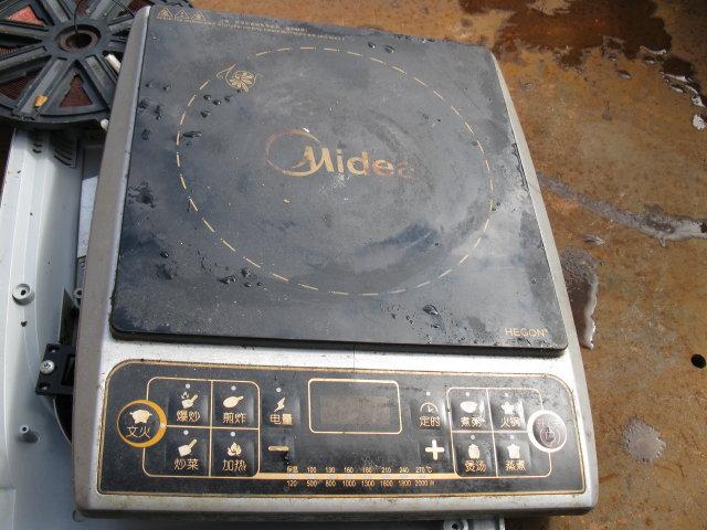

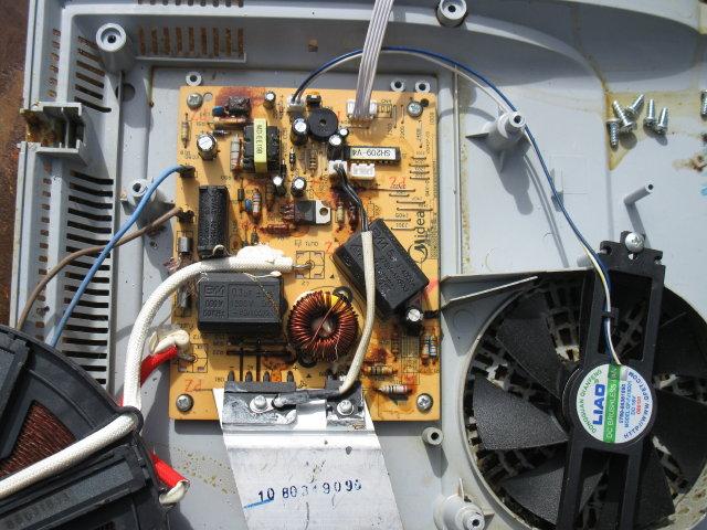

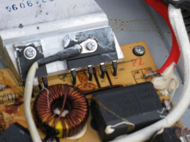

« Reply #9 on: August 23, 2013, 02:46:50 AM »
Here ya go Tom this will fit in your briefcase.
I did the rounds in my area on rubbish collection day and found an induction cooktop. It operates on 220 volts and input power is 2000 watts. I think this would make a nice little induction heater. Have a look at the photos of it.

« Reply #10 on: August 23, 2013, 12:52:37 PM »
Morning Ironman well that does look like it would be interesting to play around with I don't see a lot of capacitors there but it would be interesting to see what a different coil would do or if they could be added. The flash can't be anyworse than getting my pic taken!!   :D  :zap:

« Reply #11 on: August 25, 2013, 08:57:51 PM »
Tom have a look at the photo  pcb+ fan. There are two large caps with a filter coil in between.
