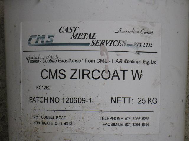

It looks like it will melt very fast. When you melt aluminuim be careful because kaowool heats up so fast you will over heat aluminuim so easy.
I can see the furnace shell getting hot between the lid and body, you will need to have a kaowool gasket to sit in between them.  Don't let hot gases get behind the kaowool and the metal shell otherwise the kaowool will fail very quickly.
Wow your prices are way more expensive than in Australia.
Zircon paint is sold in 25kg pails which is about 20 pints. It cost $96
Kaowool is sold in a box and the blanket is 25mm thick (1"), 7.6 m long (25ft) 600 mm wide (2ft)  $100 a box.
I photo'd the label of the zircon paint.
Hmmm class of 68 eh , I was in grade 8 in 1968.

Well I belive it was grade 8 for me as well Mr Dixon's class. Your price for the paint is way better, I should have tryed shopping around but I just wanted to get it done I will definetly see if I can source it out better. Mine came from a ceramic store about 3 miles from me as well as the bentonite and fireclay. I will fix the hotspot's  for sure there are two the worse one shown the other is just a couple if inches that is with the furnace running flat out with no regulator just a size 19 brass orfice in the tube.  I belive that the hotspot was from cutting the wool  pulling it out to silicone it but not putting it back in the same spot I should have used a reference point or mark. I also have a dimmer switch hooked up to the blower so I can control the heat better.
