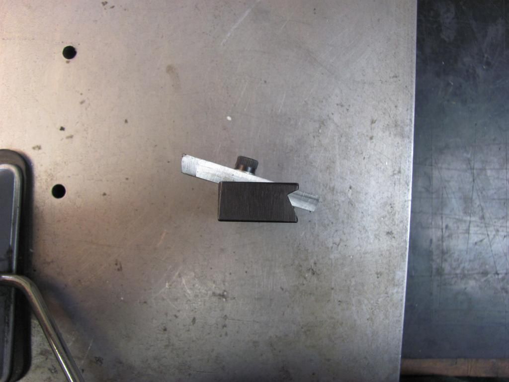

Offline ieezitin
  • Posts: 662
Re: QCTP tangential tool holder
« Reply #4 on: August 18, 2013, 10:39:28 AM »

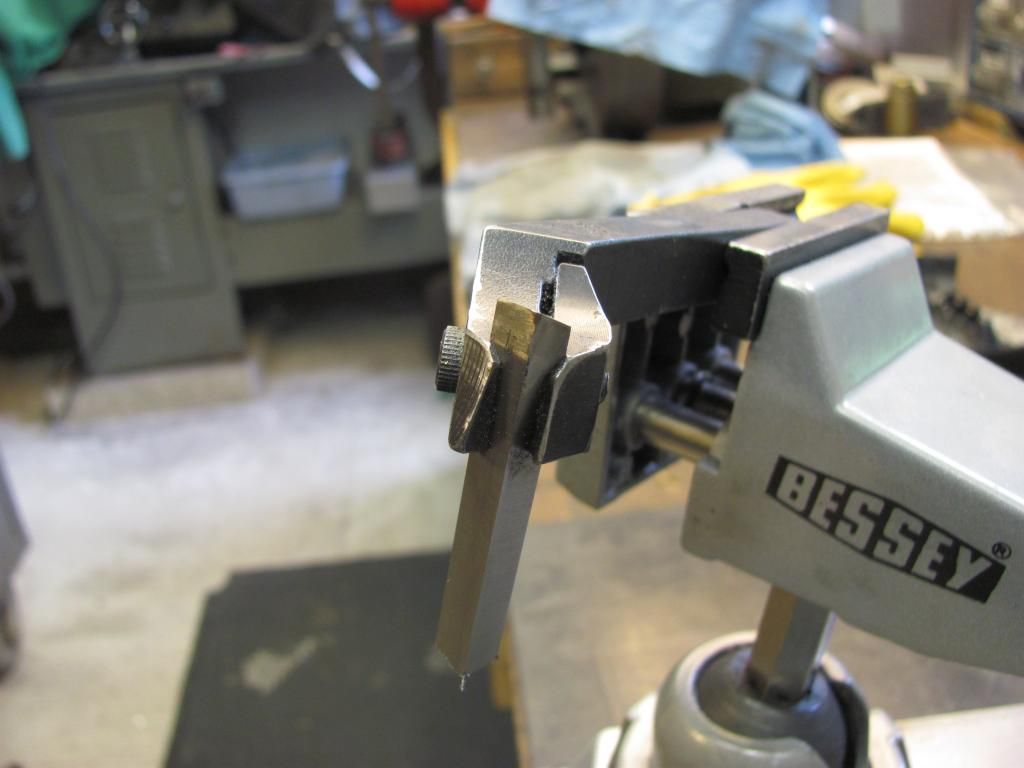

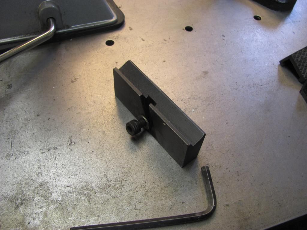

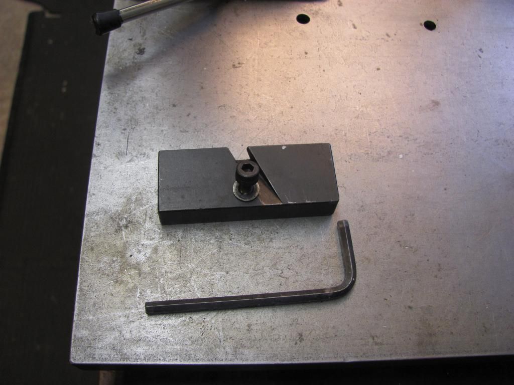

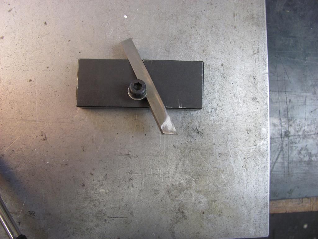

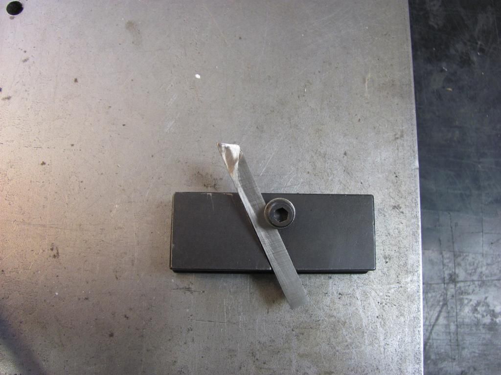

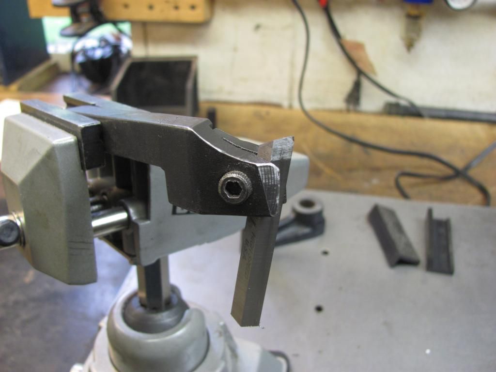

Chuck
here are some piccies of my tool.  You know i never really paid attention to the fact it is a Left hand tool   :bugeye:.Thinking about it more now there would be an advantage to making a right hand tool.
Here shown also is the little jig it come with to sharpen it on the grinder, it holds it at the correct angle in both axis's to give a flawless grind.
Like i said before its hit and miss on the surface finish i find, i own a Logan 820 and an Atlas 12" and the results are the same on both lathes, maybe larger lathes with a little more rigidity would help with the finishes, I have tried it a little high and low on centers with not really any good results. Don't get me wrong it does a good job more times than not i just change to another tool when i go to final size, or I emery-cloth the finish in.
It really takes allot of the hassle out of tool grinding....
Enjoy.......
Hope this helps.......   Anthony..

Hi  :wave:
I have one of these too & I use it for 95% of machining I do, what I do is once the top face is sharpened I stone a small radius onto the front corner, this gives a slightly better finish as you have more cutting surface in contact with the material you are machining & not a pinpoint corner which will exaggerate the record groove of the cut. By the way I think you have a slight error in your description of the tool.. it cuts from right to left.. toward the chuck.. hence right handed, conversely the other way is left handed... away from the chuck, check on Eccentric Engineering website you will see the description as such.
Regards
George  :headbang:.
