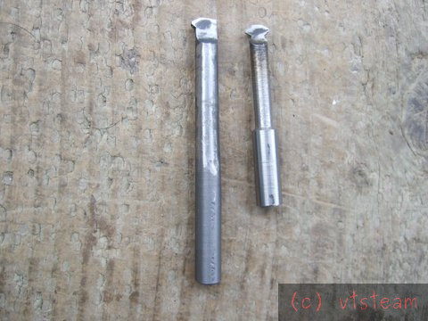

Re: A boring table for a Craftsman 12" lathe
« Reply #52 on: September 07, 2013, 06:35:28 PM »
Those are both really great tips. Thanks Guys! :nrocks:
I suppose I could make the acme rod to then make the tap.

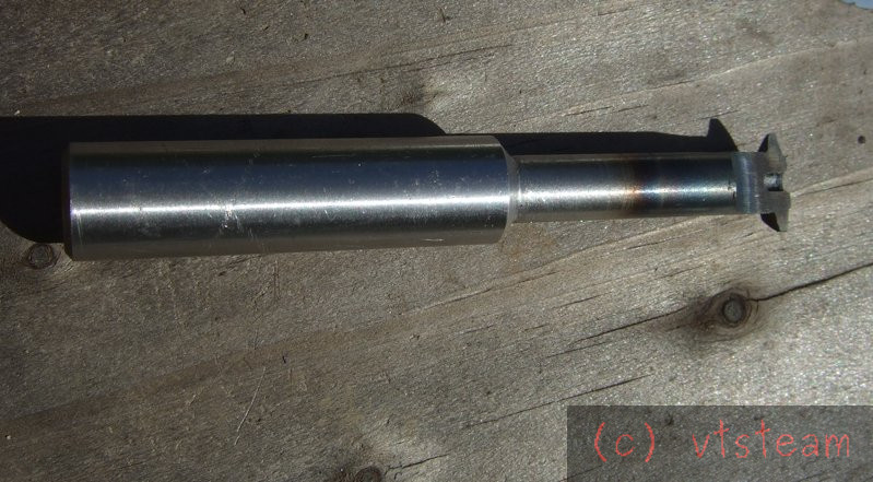

Before I read the above today though, I already made up a second internal threading tool and set up the lathe for thread cutting. I haven't cut anything yet and will try some test pieces tomorrow. I guess I'll see that through, one way or another. But now have a plan B with the tap tips.
Also, I should admit, Andrew, I have an unused can of Kasenit sitting on a shelf.    :palm:
Here's today's and yesterday's cutters compared. I had to grind down the shank of the new one by hand because I had hardened the cutter already and found I didn't quite have enough clearance in the bored hole size -- .420" -- even though the shank was .375. The tooth pushes that out, of course  :doh:  :
« Last Edit: January 07, 2018, 10:40:25 PM by vtsteam »

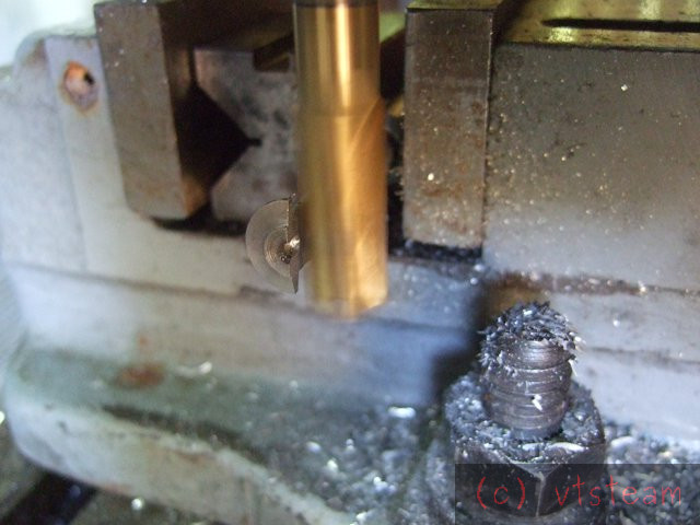

« Reply #59 on: September 08, 2013, 07:05:08 PM »
Now that you have all those out of the way you can get down to some serious work tomorrow. It happens to all of us occasionally if we are honest enough to admit it.  :D :D
« Reply #60 on: September 09, 2013, 02:46:02 AM »
Did you cut from the chuck out of from the back of the blank inwards , I only ask because I have not cut a left hand thread yet ?

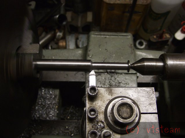

Don, thanks for the encouragement!  I'm ready to cut serious metal today!!  Or as serious as I ever get.    :)  :beer:
Chipenter, no, I cut from the tailstock end into the piece, right to left.

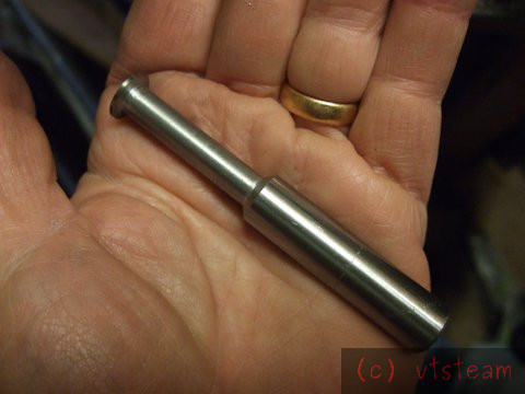

This time I decided to reduce a portion of the shank to .315, while leaving the bulk at .5. I realized it would fit my boring tool holder, and didn't need to fit the .375 slot in my regular lathe tool holders. The 5/16" section seemed to be the maximum diameter possible to provide clearance for backing out of the groove and returning the tool to start while threading, based on my other tools.
« Last Edit: January 07, 2018, 10:43:38 PM by vtsteam »

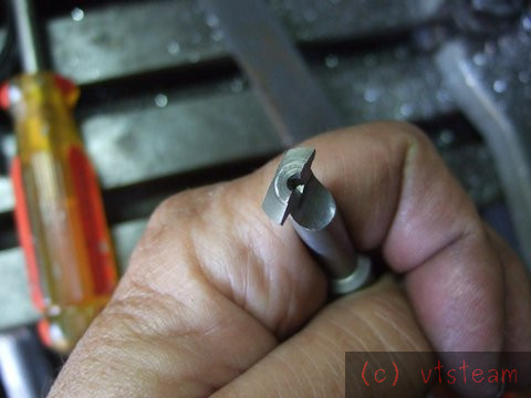

  • Posts: 6856
« Reply #64 on: September 09, 2013, 07:48:51 PM »

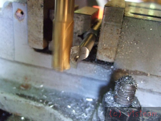

Fluting the cutter. This time I milled to the center, and decided I would add more relief later, rather than milling below center.
« Last Edit: January 07, 2018, 10:44:28 PM by vtsteam »
  • Posts: 6856
« Reply #65 on: September 09, 2013, 07:52:24 PM »
I also milled off some of the excess at the back side of the cutter:
« Last Edit: January 07, 2018, 10:45:18 PM by vtsteam »

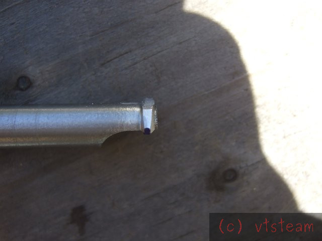

I blued the cutter edge and gradually filed it away, watching the blue mark:
« Last Edit: January 07, 2018, 10:46:45 PM by vtsteam »

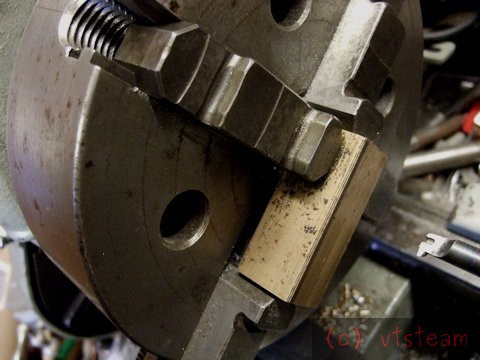

  • Posts: 6856
« Reply #68 on: September 09, 2013, 08:47:52 PM »
When I got close to no more blue, I switched to a bench stone and took the last of it off. Then it was time to harden the cutter. This went without a hitch with REAL drill rod, and a file couldn't scratch it. I left it full hard, as none of my earlier trials yielded a broken cutter -- screw cutting happens at slow speed with light cuts and they aren't interrupted. Maintaining the keenest possible edge is important, so that was my choice.
I left cutting edges at both sides of the tool for the time being, since I though I'd try cutting a tap with the outside facing lip. After that I planned to grind it off so the cutter could fit the bore when internal threading.
Cutting a tap proved impractical with this tool. The boring tool holder was in the way of either the chuck or the tailstock since this is a tool designed to be aligned parallel with the bed.  1/2" tap stock had too long an overhang to be solid enough on my lathe without support by the tail center.
Low speed chatter was the result when trying to thread drill rod. It left a horrible finish. Much better would be a conventional lathe tool, ground to do a 29 degree thread. You would have a shorter tool extension, plus support by lathe centers. So after fooling around for an hour or so I finally gave up and ground off the extra lip.
I did a practice piece in both aluminum and brass, left hand internal threads, and finally chucked up in the 4 jaw the stock I intend to use for the actual leadscrew nut. A old scrap block of either brass or bronze, I'm not sure yet what it is. I'm thinking bronze -- need to clean it up more to see the true color. It's acting like bronze -- maybe even aluminum bronze as it was quite tough to drill.
I figure I've got two chances with this block -- the hole I drilled is near one end. If I screw up screwing, I could try again at the other end -- it's long enough to cut off the mistake and try again.
By the time I had the first hole drilled it was supper time -- time flies. I'll have to bore to  ,420" tomorrow, and then cross fingers it'll thread right this time.....
The cutter after hardening:
Ready for tomorrow:
« Last Edit: January 07, 2018, 10:47:54 PM by vtsteam »

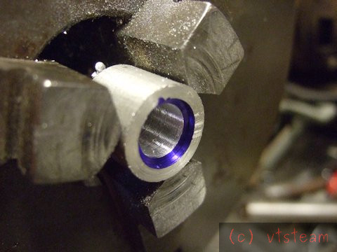

I decided to try one more scrap piece of aluminum, and this time not only cut a register in it, but also blued it so I could see for sure when the cutter touched the outer bore. This one took a lot longer to thread -- which was a hint that the others were indeed too shallow.
When it was done I also measured the inner bore -- I had bored .420, but when measured after threading, it was .410. I think the aluminum burred outwards -- I used a round file to bring it back to .420.
When I tried it, the scrap piece threaded on the acme screw -- finally! Well, most of the way. I think the thread was still a little shallow at one end. So I realized I probably needed to make a few more spring passes to clean up the end of the thread. Small holes like these necessitate slender boring tools, with a fair amount of spring. The fit was quite good otherwise -- no apparent backlash when wiggled. So I think I have the problems all  figured out.

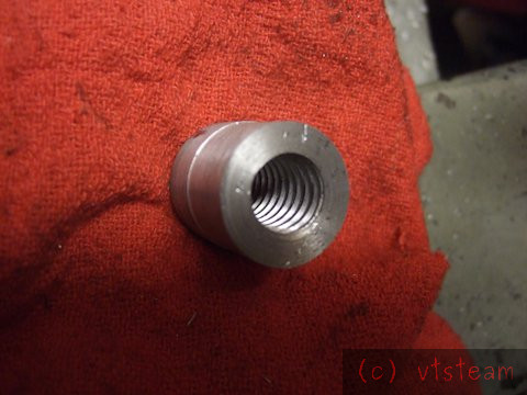

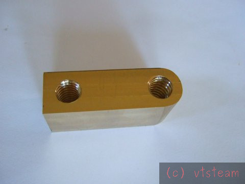

  • Posts: 6856
« Reply #71 on: September 11, 2013, 09:18:56 AM »
Before starting this morning, I thought I'd give myself some extra insurance by calculating what the compound slide should read when the thread is fully cut. Well, in an ideal world anyway.
Because I'm cutting this thread using the compound set at 14.5 degrees, rather than the straight in method, each division on the compound does not equal the actual distance cut straight in.
To calculate the difference, I figured it would be the inverse of the cosine of 14.5 degrees times the tooth depth I want to cut.
The inverse cosine of 14.5 degrees is 1.033 and the tooth depth is .05" so 1.033 x .05 = .0516". Round that to the nearest thousandth and it's .052" So as a check on the depth of cut, I should be turning the compound slide in a total of .052" on its scale. If I've done that, and I'm also starting to cut my register on the part, I should be at full depth of cut.
Fingers crossed!
  • Posts: 6856
« Reply #72 on: September 11, 2013, 04:31:22 PM »
Finally!
It took one messed up hole when I got out of sync threading, but there was enough stock to make two. I'll cut the mistake end -- the square one -- off and fit the other to the boring table.
Man that was a lot of work for one nut!     :Doh:  Well at least I learned a lot....   :coffee:
I may try again to make a tap, as long as I have the lathe set up for threading.
« Last Edit: January 07, 2018, 10:52:15 PM by vtsteam »
