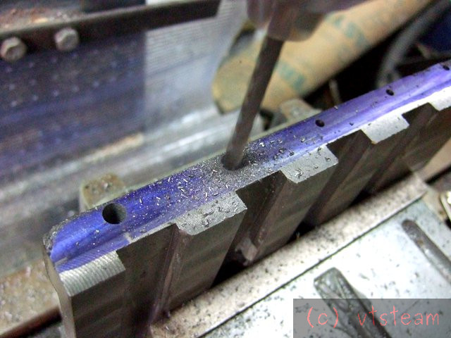

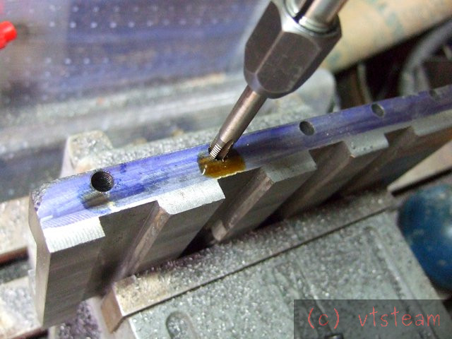

Spent a little while today adjusting the gib -- had to mill a small amount off because even though the table fit on the saddle and the proper surfaces were in bearing, the gib was slightly cocked. It was just a couple thou too wide. So without gib screws it leaned, which allowed the table to set down on the ways and look right, but not be right.
Anyway, clocked the gib in the vise on the mill and skimmed it 5 thou. After that everything fit well and it was time to drill for gib screws.
I wanted 4 but I didn't want them to end up where they would interfere with the table surface hold down screws (yet to be added). So they needed to be located roughly where the present channels are milled into the table. This meant 3 screws or 5 screws, and thinking 3 were too widely spaced, I went with 5. Kind of overkill but, well, it certainly doesn't hurt anything.
Drilling:

« Reply #26 on: September 03, 2013, 10:27:10 PM »
I checked the original cross slide gib screws and found they were 1/4"-28 -- fine thread. Pretty tight clearance to the bottom of the slide -- not a lot of meat there -- the dovetail is 5/16. But enough I guess, so I followed suit.
Picked up the little trick from DoubleBoost's videos of running the mill with the tap in it, switching off and lowering the quill into the hole to start the thread. Worked great. Thanks John!  :thumbup:

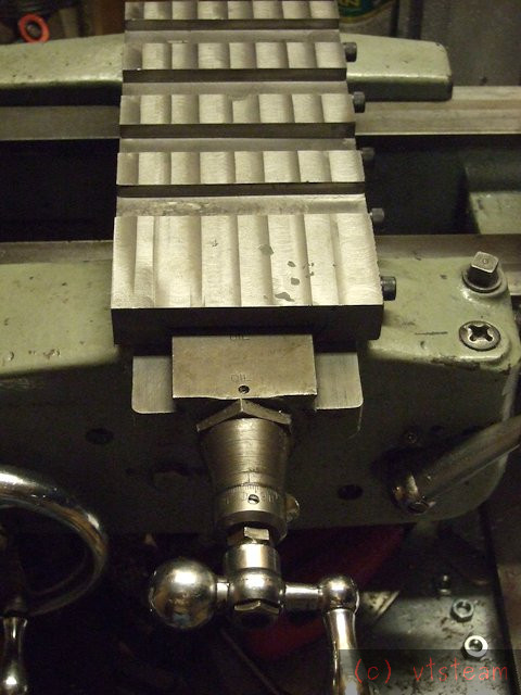

And finally today, added screws, set the table on the apron, tightened for light contact, and proceeded to slide, then yank at the table. Sliding went smoothly, no movement when I tried to force it to the side, not a click. Nice solid fit.
The screws are a little short for adding lock nuts and taking up wear in the future, so I'll have to head back to town tomorrow to pick up longer, ones. But all in all, well pleased today.

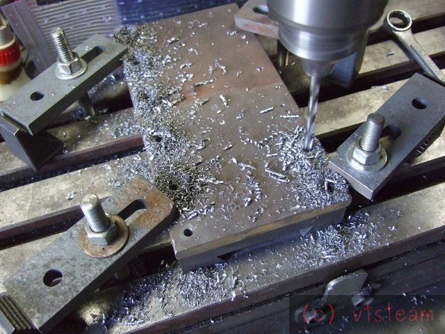

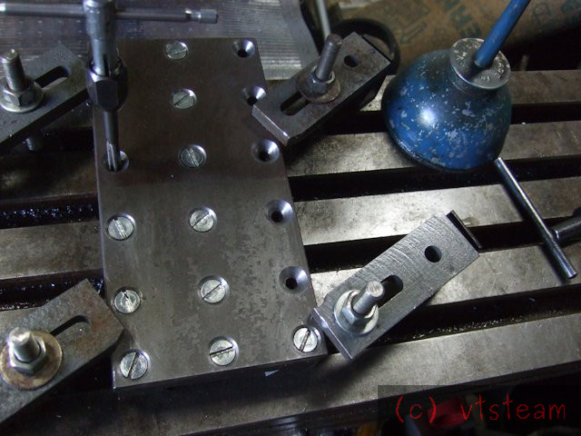

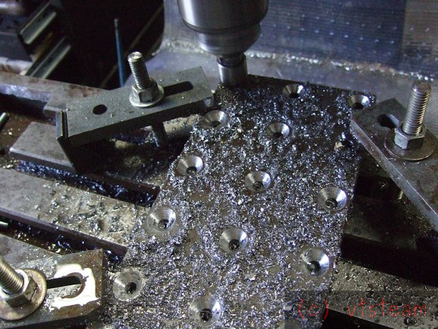

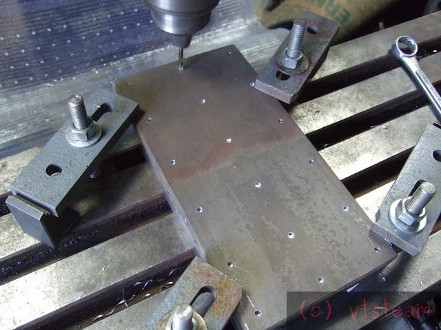

Today was hole day. Whole lotta holes.
I took the scale off of a 3/8" thick piece of steel plate which will cover the casting and will eventually be milled for the top groove of the t slots. I lined it and the casting up on the mill and spotted screw locations:

« Reply #31 on: September 04, 2013, 06:25:29 PM »

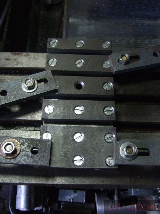

Then started drilling tap size:
« Last Edit: January 07, 2018, 10:29:38 PM by vtsteam »
  • Posts: 6941
Re: A boring table for a Craftsman 12" lathe

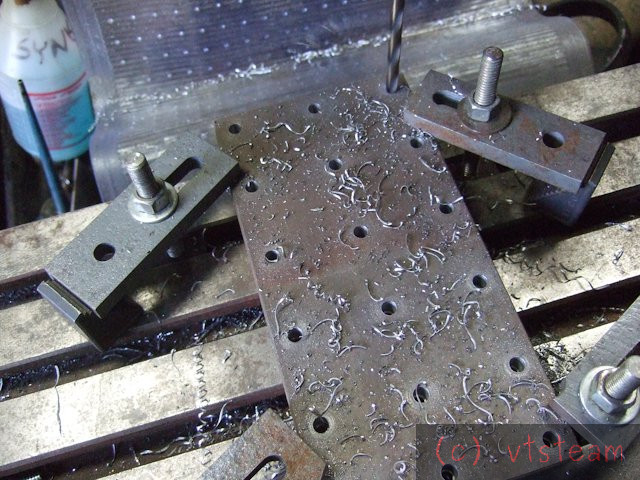

« Reply #32 on: September 04, 2013, 07:12:27 PM »
Then drilled the clearance holes:

Then the countersinks:
« Last Edit: January 07, 2018, 10:31:15 PM by vtsteam »

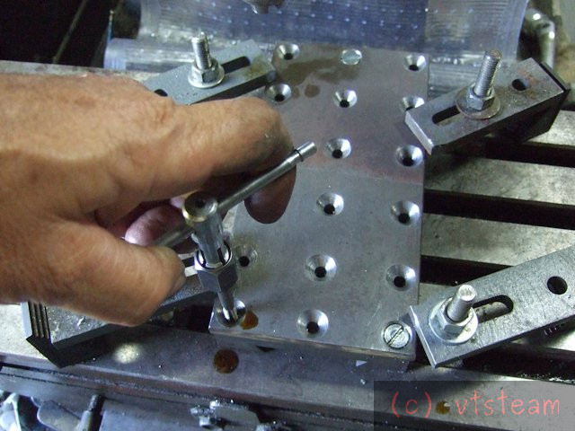

« Reply #34 on: September 04, 2013, 07:20:23 PM »
Then began tapping holes:
« Last Edit: January 07, 2018, 10:31:53 PM by vtsteam »
  • Posts: 6941

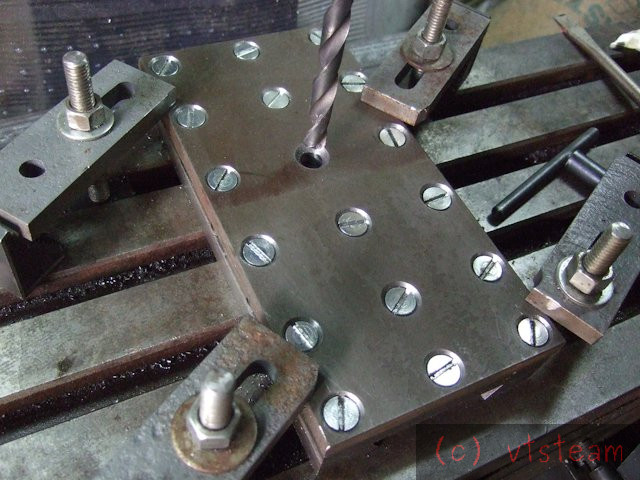

« Reply #35 on: September 04, 2013, 07:23:51 PM »
And this is where I left it by supper time. Ten down, eight to go:

Today's attack on metal object:
Holes all tapped, in fact one too many -- that central one needed to be drilled out to 3/8 to fit the lead nut:

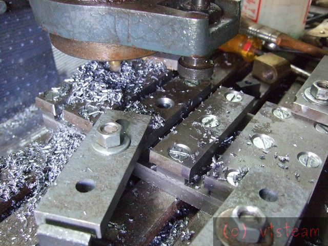

Then it was time to start milling the slots:

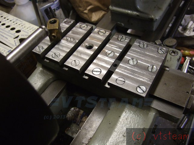

Slots all done:

« Reply #44 on: September 05, 2013, 05:55:48 PM »
Skimmed it all with the homemade carbide fly mill, and set it up on the lathe to see how it all looked. The nut I have to duplicate (from the lathe's cross slide) with a little modification to suit the height of the boring table is sitting on the back. You can also see a T-nut being tried in one of the slots. It fits really nicely. Another good day.

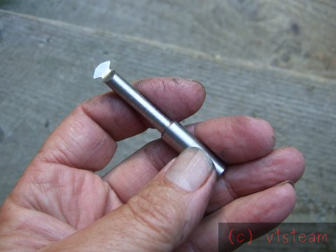

To make the nut I need an acme 10 TPI internal threading tool. I found elsewhere on the forum instructions for making threading tools on the lathe, so I thought I'd try it.
Here's my first effort:

Tom, Chipenter, thanks -- always looking to try new things (to me). And this site is a great resource for that. Hope I'm contributing something in return. :nrocks:
Chipenter, a tap would have been my first choice, especially since I'm sure I could use it again in the future. But a quick check of the usual machinery resources here in the U.S. showed acme taps of this size (1/2"-10) were approximately $100  :bugeye:
I wonder if they are made of platinum?
I'd seen a youtube vid of a roughly made acme tap, but I don't have acme threaded rod on hand, so would have to order that. Also it can't be hardened, though in this case I'm not cutting steel.
I'm very curious about the tooth shape boring bar turning method -- it's fun and I have drill rod on hand.
Missed the link last post, here it is:
http://madmodder.net/index.php?topic=3523.0
I can see several improvements I could do to my technique after this first one -- mainly to increase stiffness:
1.) the bar should be as wide as possible -- to fit the internal starting diameter of the nut.
2.) the bar should be as short as possible with just enough clearance to pass through the nut and a little bit more to stop the carriage in time.
3.) the cutting profile should be as short as possible, with just enough clearance to clear the cut.
4.) although I have tempered to appropriate colors in the past for boring bars, I believe this one should be made like the OP suggested, dead hard, to maintain the highest sharpness through the cut.

Thinking about the above, for a 1/2" x 10 TPI thread, I think I'll try this:
1.) start out with stock equal to the nominal diameter -- in this case 1/2".
2.) turn the end button and shank to a depth of 3/8"- which yields about 125% tooth depth
3.) after making the flute flat, grind off the outside turning tooth profile for clearance.
I think that will make a much heavier shank.
