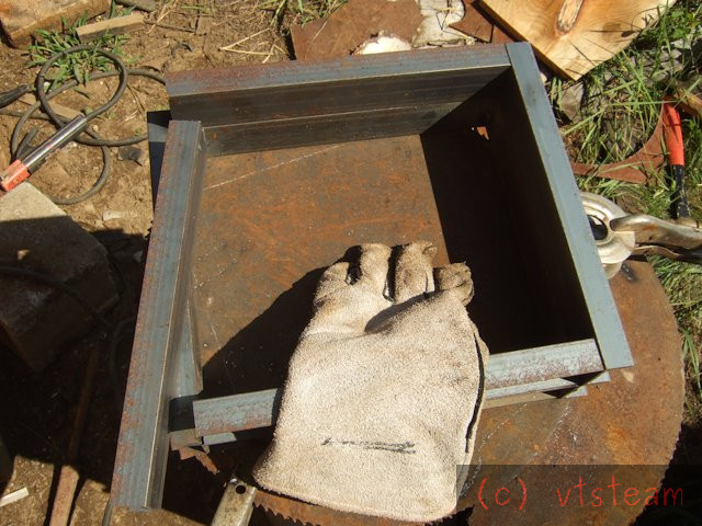

Laid out the first one, tacked it together, checked it for square, then started building the others clamped on top of that one as a pattern.

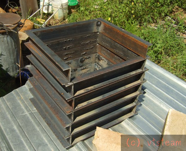

I wanted to roughen up the inside surfaces to keep sand from breaking out of the flasks -- they were waaay too smooth so I just used up some old welding rod stubs I'd been saving on the insides.
« Last Edit: January 13, 2018, 05:24:26 PM by vtsteam »

That rascal Lester only gave me 23 pieces of channel instead of 24! Hence the top C shaped flask.
Oh well, we both should have counted. Guess we're getting old. I'll go down town for more Lester stories Monday.
« Last Edit: January 13, 2018, 05:24:59 PM by vtsteam »

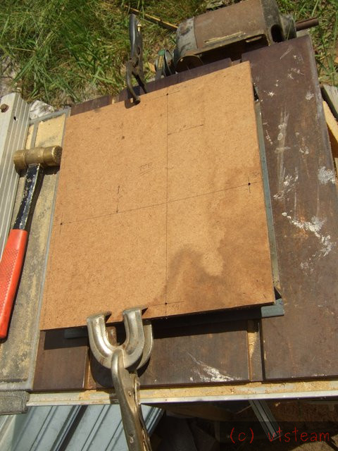

I made a pattern out of Masonite to drill  pilot holes.
« Last Edit: January 13, 2018, 05:25:42 PM by vtsteam »

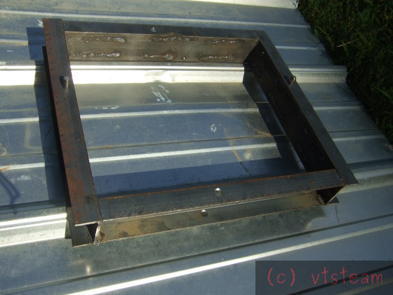

After opening the holes to 3/8" I turned six 3/8" inch tapered pins on the lathe and welded them in place in the copes.
« Last Edit: January 13, 2018, 05:26:18 PM by vtsteam »

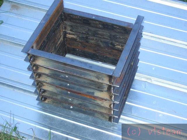

Almost done -- just need that last piece of channel.

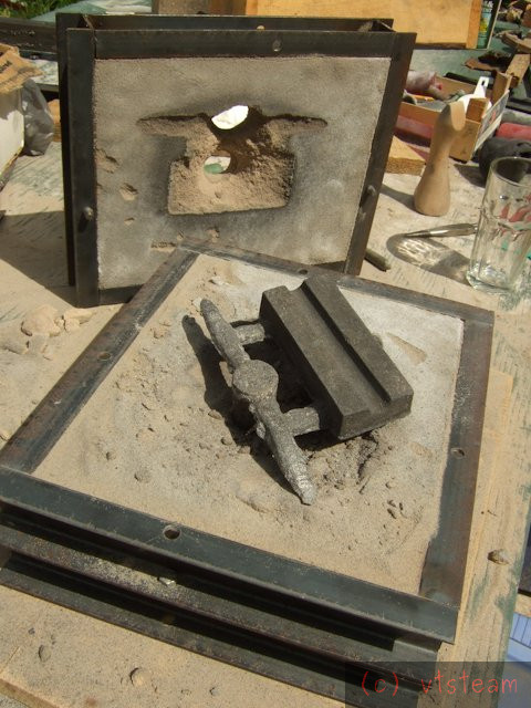

Well, they work very well. Very happy with them! Bolted the bottom two together to form a deeper drag for this piece.
