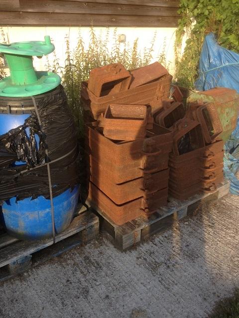

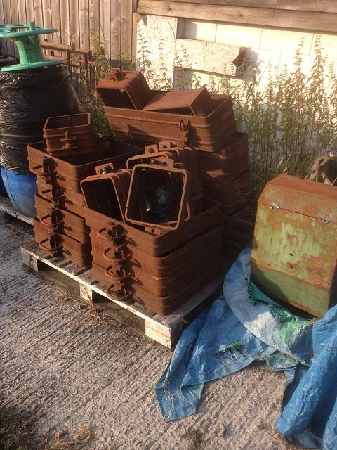

Here you are Steve, don't bother making flasks, borrow some of these (I bought the contents of a foundry that went to the wall some years back):
Re: Casting AL molding box
« Reply #19 on: August 08, 2013, 02:09:45 PM »
I'm going to have to build a boat to get em!  Nice, though.
