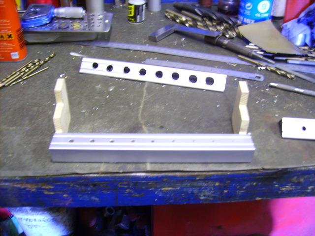

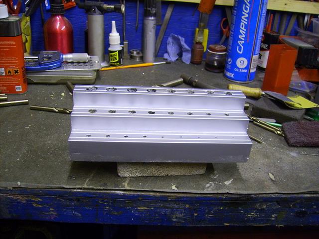

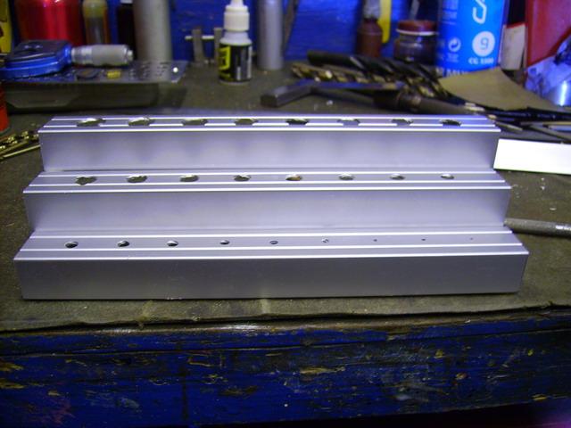

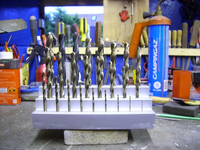

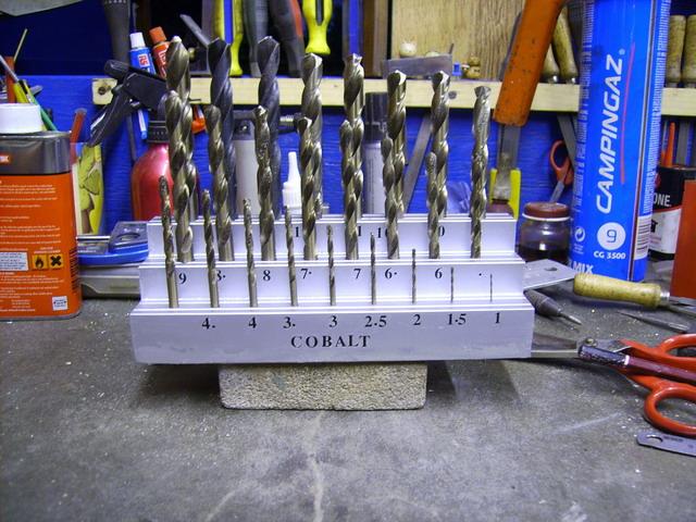

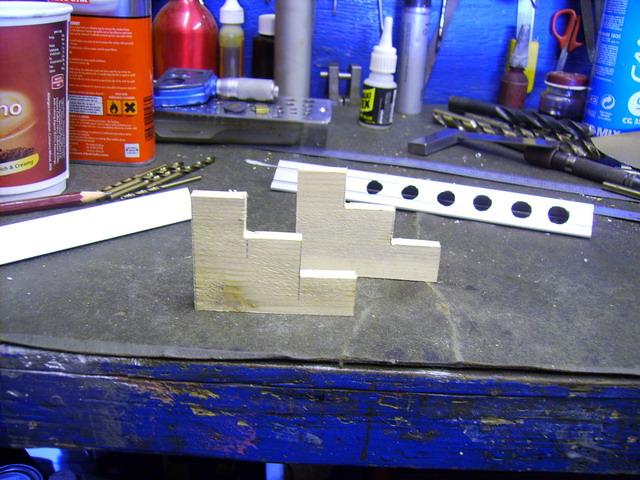

hi all well i have a set of cobalt drills that go up in .5mm steps to 11.5 so rather than them laying in a tub i made this up today i have gone all the way up to 13mm don.t no where i got the aluminum angel from i cut 3 lengths of it 200mm long i then made two side panels divided the lengths up for the center of etch drill stuck it all together then started to No the drills IE 1 then 1.5 and so on but i run out of No 5s so i just cared on will go to wh smiths in the morning to get sum more right pics

Bob, how did you put the numbers on the ally?
Nice job anyways...

I guess your numbers are self adhesive backed from Smiths or Hobby craft sheets (no connection)?

hi all thancs for the coments the letering is from smiths as mechman48 sed ther dry transfer type you just rub them on but to mack them permanent you need to varnish over the top of them the key in useing them is prep i whent over the face with a cloth with thiners on to remove any oil and muck
