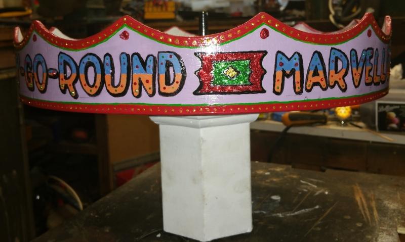

« Reply #50 on: September 11, 2016, 03:36:18 PM »
Thanks Matthew I still have things to do but I have to be careful of getting carried away and spoiling it with too much decoration.
Actually the pic is a little dark will have to retake it with the flash on.

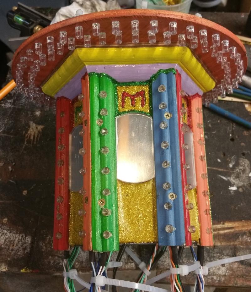

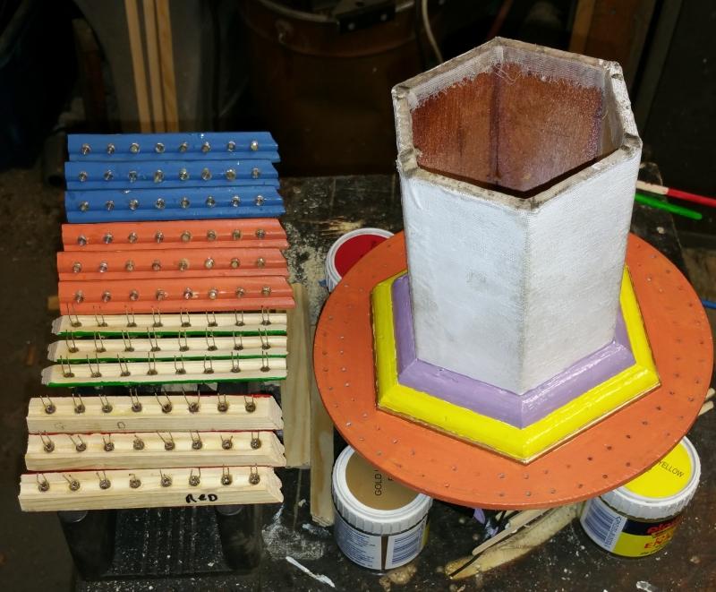

« Reply #51 on: September 22, 2016, 05:00:20 PM »
ok so I am pretty happy with my work on the top of the carousel and I have put it to one side to start on the body now. I drilled 96 holes in the top for the leds to go into or rather the leads of the leds will go through leaving the leds totally proud and made some trim pieces to go on each of the corners. I have drilled 8 holes in each and glued leds into those as well. in total it will have 192 leds by the time I have finished.
I have decided to use a arduino mega to control the carousel as it allows me to have 48 outputs for the lights leaving me with a couple to control speed and maybe music too. The main thing I cant decide is if I should have 48 sets of 4 lights which will allow me to control all the way around the carousel but limit the effects possible a little or 48 set of 2 lights and just have the lights on 3 of the sides mimic the lights on the controlled side which will allow for better lighting effects  :coffee: all assuming I can hack together enough code to do all I want to do.

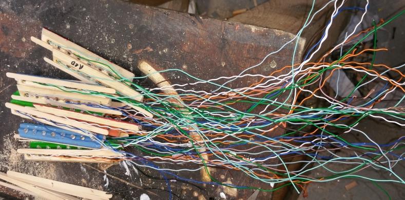

Wires lots and lots of wires  :bang:
found a better way to control them with the arduino (dont even need the mega) shift registers 6 of them to be precise all just using 3 pins on the arduino.  :ddb:
so currently in the process of converting binary and noting down lots of numbers to feed the arduino hopefully from a file on a sd card.

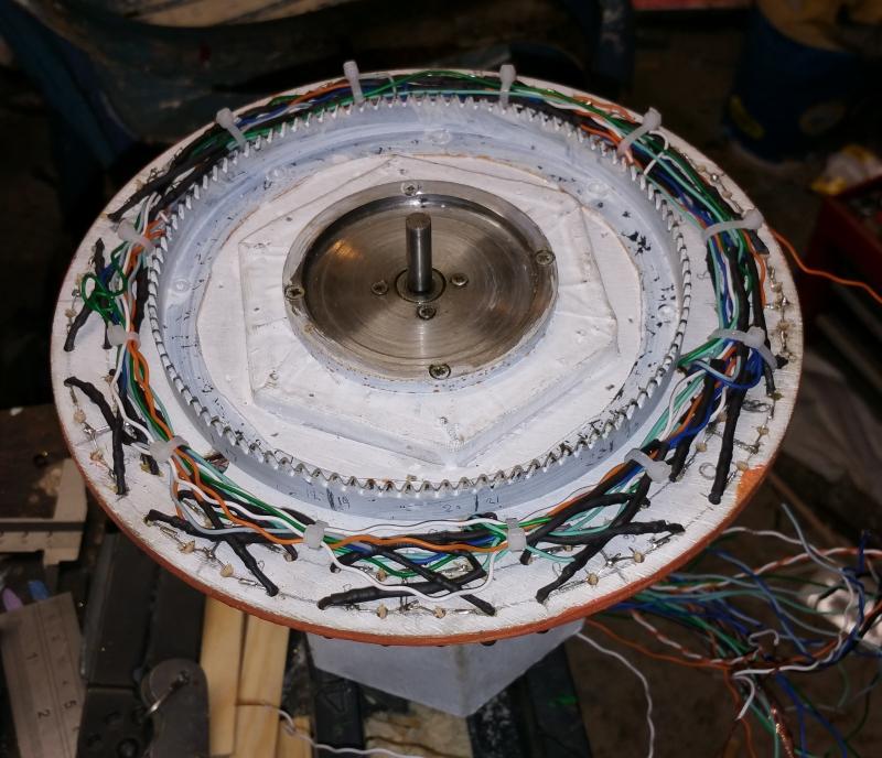

Re: carousel
« Reply #54 on: October 05, 2016, 05:41:06 PM »
All 192 led's now have wires the top most ones have resisters in line under the heat shrink sleeving. If I had planned ahead I could have got the wires quite a bit neater but they will hopefully remain hidden for the life of the carousel so they will do, its a lesson learned for next time.
I really should sit down and learn the code needed for the arduino but every time I intend to give it some time I seem to think of something else I need to be doing  :doh:

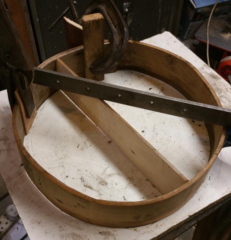

Well a little more progress today I got another strip of wood bent into a circle for the base where all the electonics will be housed, just need to let it dry overnight and I can scarf it together tomorrow.
Also got the platform attached to the top of the carousel I can get a better idea of how long the bars for the horses have to be now.

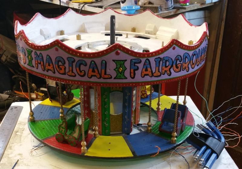

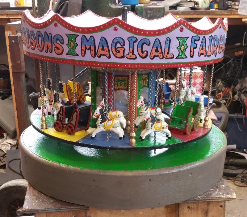

« Reply #66 on: November 06, 2016, 11:22:42 AM »
More progress to report.
I finished (apart from the decorating) the base and got the center column fixed to it and then started on the hangers for the horses, to start with I put the hooks opposit to each other with the intention of making them a bit like a bayonet fitting it wasnt until I started to put the horses on that I realised by the time they where glued on I wouldn't be able to turn them far enough  :Doh:
So remade the hanger bars with the hooks the same way this time and glued the horses to them just need to paint them gold now and will be ready to crimp them so they cant come off or move sideways and foul up.

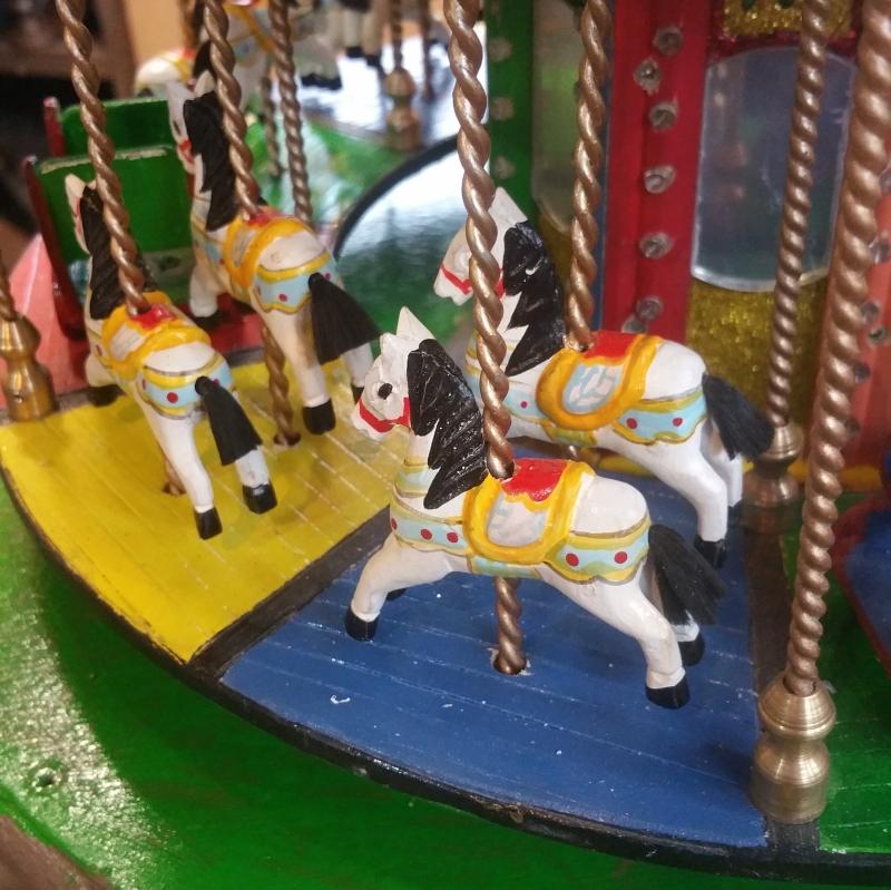

Re: carousel
« Reply #74 on: November 14, 2016, 04:11:23 PM »
The horses now have their tails.
Shoe laces cut to size and brushed out with a tiny wire brush, the ferrule (I think its called that) was cut down then glued into the back end.
