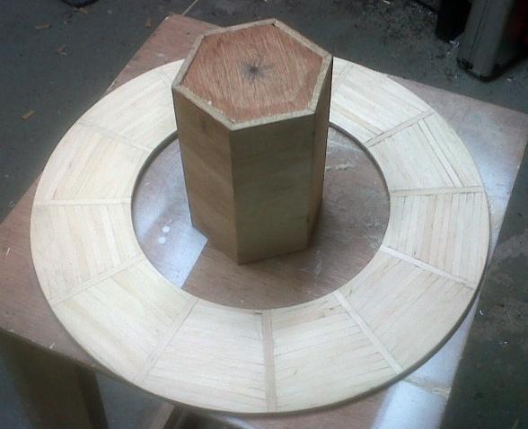

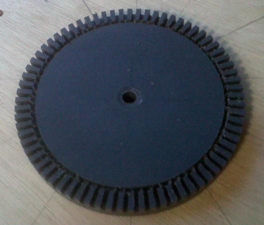

I decided to make a model carousel for my grandaughter and feel confident now that I will at least be able to make it even if I dont have one with all the lights like I asked about in the "how to" section.

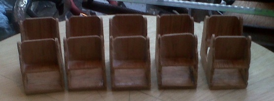

I started off by making a mistake pic1 the first carriages i made where much too big so I made 5 smaller ones (only need 4 but one is just in case).

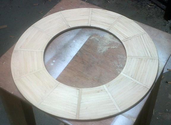

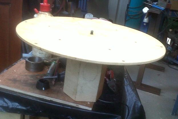

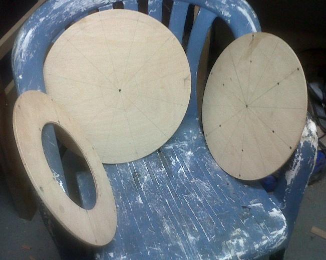

Next I cut the playwood circles and ring will will make the base, top and deck of the carousel and glued many coffee stirrers to simulate planks onto the deck. The coffee stirrers are good for the scale but I need to make sure they show through the paint I will put on it.
that will do for now I will not rush to put all the pics up as I still have a very long way to go to complete it.

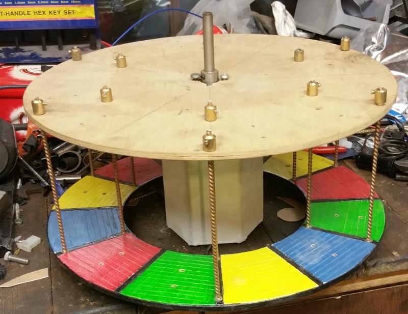

I made the centre section for the carousel, this needs to be hollow to house the motor and gearing and most probably the electronics or whatever I decide for the lights and music.
Some simple wire twisted with the drill soldered into some brass holders to keep the deck in place all painted gold, looks very impressive I think.

I think most people will be. Not everyone makes a comment though. Post away... it isn't in vain.
Re: carousel
« Reply #4 on: August 01, 2013, 01:12:33 PM »
I would like to see how you did the wire twisting.
The decking looks nice. Is it just glued?

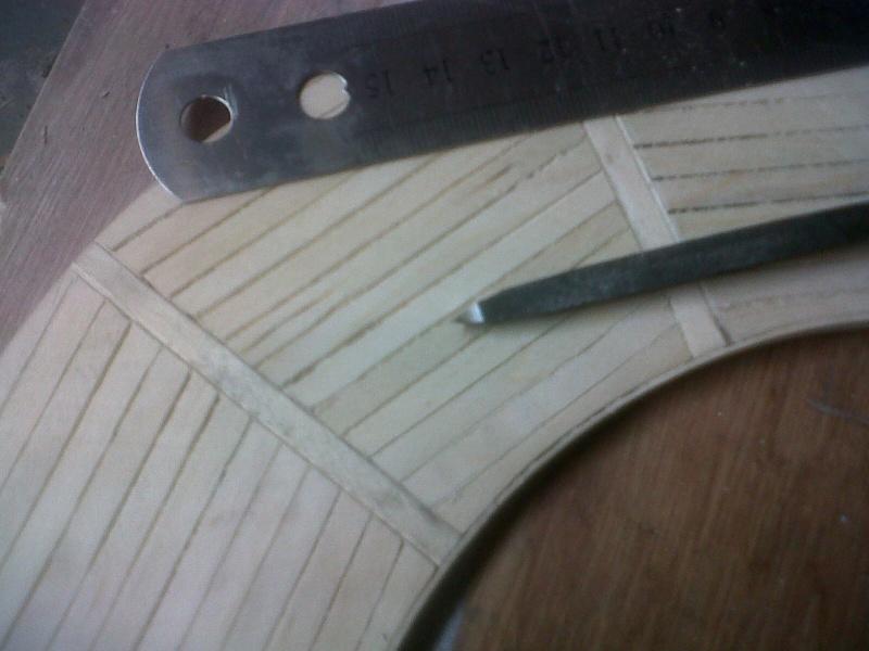

It's too late now since you've got the decking complete, but if you would have put a small chamfer on the edges of the coffee stirrers before you glued them down it would have helped make sure they show through the paint.  That would highlight the joint which is what I think you were hoping to do.  Another option is just do a clear finish on the deck and let the wood show through.
I build wooden models of construction equipment and I have yet to use anything to finish them other than clear or amber shellac with a polyurethane varnish top coat.

the wire twisting was quite simple I had a fitting (from a gazeebo i think) lying around so just drilled a few holes either side of it then bent the ends of the wire fed them through the holes, put a nail in the vice and let the drill turn it until i was happy with the finish. I then just wound the rest to closely match the first one.
ddmckee54 I sorted that problem out by grinding the end of a small file to a sharp point and scoring between the stirrers using a ruler to avoid going off (second pic). As for not painting I did think about that but dont think it would be in keeping with a proper carousel. I think they are meant to be painted bright and cheerful colours.

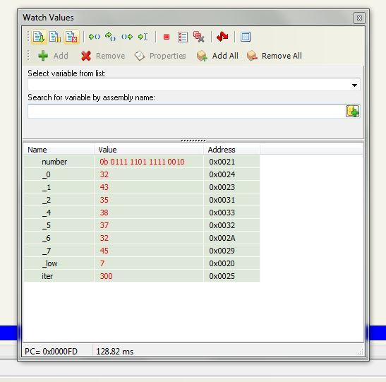

Are you still looking for a random generator wotsit for your lighting?? No way could I find the wretched circuit I prattled on about but I now have a much better method. Well MikroC does anyway. They have a RAND function that does it for PIC code in their compiler.
Ridiculously easy ... wanna see ?? If you want I could post the code.

Shipto
I assumed you would want 8 individual outputs, could be others, no trouble.
This is all it is.
Code: [Select]
int number;
int iter;
unsigned char _low;
unsigned char _0;
unsigned char _1;
unsigned char _2;
unsigned char _3;
unsigned char _4;
unsigned char _5;
unsigned char _6;
unsigned char _7;
void main()
    for ( iter = 1; iter <= 299; iter ++ )
    number = rand ();
    _low = number >> 12;
        switch (_low)
        case 0: _0 ++; break;
        case 1: _1 ++; break;
        case 2: _2 ++; break;
        case 3: _3 ++; break;
        case 4: _4 ++; break;
        case 5: _5 ++; break;
        case 6: _6 ++; break;
        case 7: _7 ++; break;
The rand() function produces a number 0-32768 ie 15 bits
The only two lines that do anything useful are
number = rand ();            // generates the number
_low = number >> 12;     // Shift right 12 positions
Most of that code is to vaguely determine just how random it is when it's squashed down from 15 to 3 bits. Not too bad. Although it does occasionally chuck out the same value in succession but it would be no big thing to stop that if required.
Anyway, sent it around for 300 laps and got this:

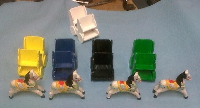

Anyway a few more pics I painted the carriages in liberal amounts of primer to start with then in bright colours (apart from the black one) as a base also shown in this pic is a few of the horses I am going to use. The horses are not made by me but brought on ebay, I did not even want to try making 16 horses or more if you count discards. you will notice they are missing their tails so I will need to sort this out.

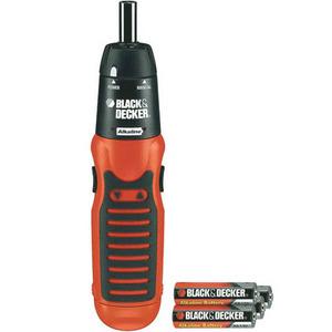

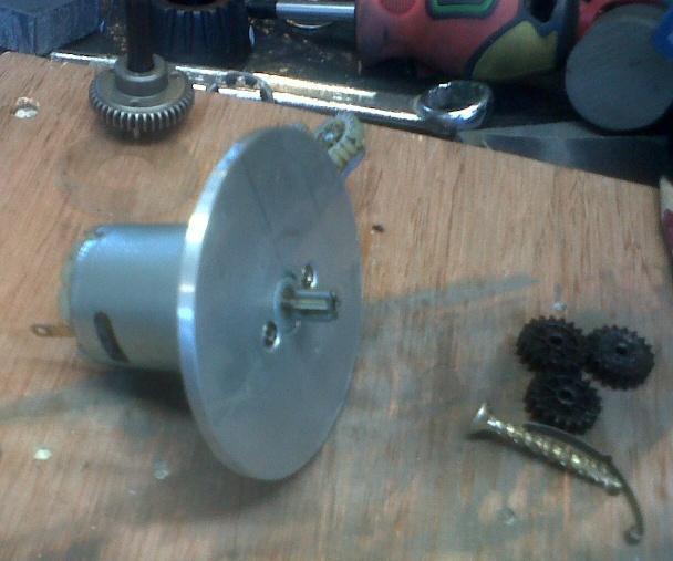

Not too much to report but I managed to scrounge a black and decker power screwdriver from a guy at work. It has a 6volt motor and a 2 stage planetry gearbox and is perfect for the drive  :D

Stripped the screwdriver down and mounted the motor on a ally disc.

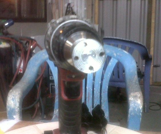

Been working on the drive today, after stripping down the screwdriver I turned the outer part out so it was straight and bored a new housing to press it into reassembled the gears and bolted the motor housing to it, after that I bolted half of the pan washer bearing? to the top and the whole lot is fixed to the carousel centre.
It turns a little fast (scaled up I think it would throw kids off no problem  :lol:) so the pwm is definatly needed.

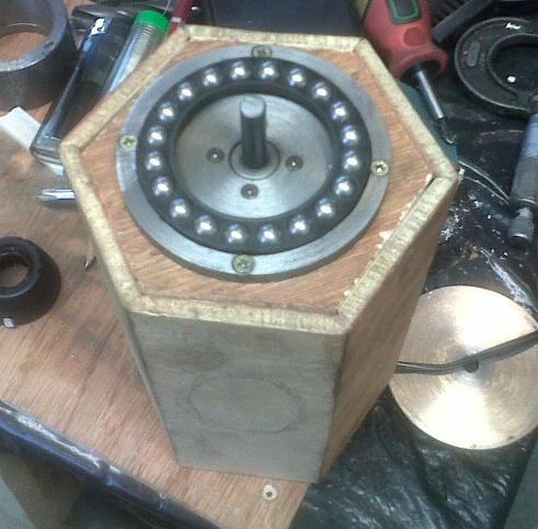

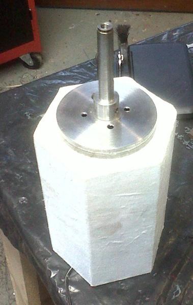

Had a accident with the center column for the carousel and had to remake it but to avoid it breaking should the same thing happen I covered it with cloth and drenched the whole lot in glue.
Also made a start on the gearing to make the horses go up and down.

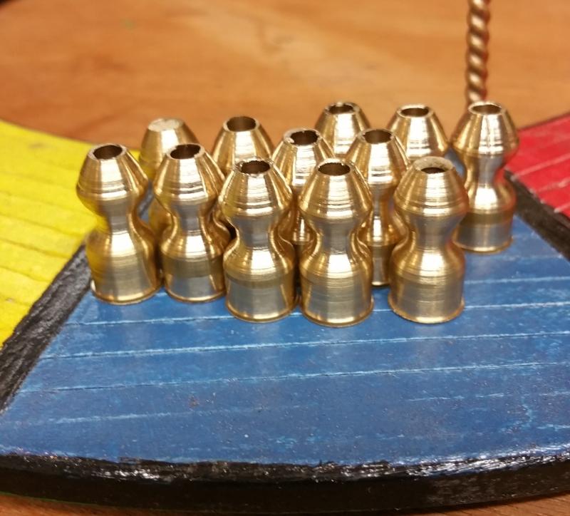

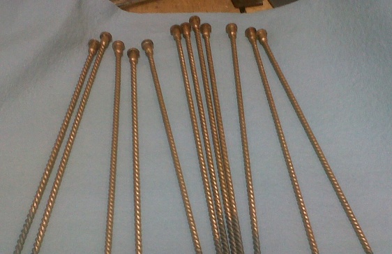

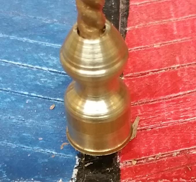

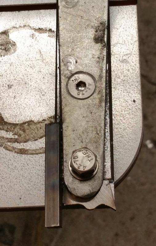

Managed to spend a bit of time on this project at last. Made a tool from a old bit of parting tool and some flat stock.
Made some fixings for the bottom of the twisted bars which will fit on as in pic 3, still need to put a rebate in the bottom of them so they can sit flush on the wood and put some m3 grub screws in to hold everything in place before they are polished up.
I have also located the gearing for moving the horses up and down, already brought a large meccano crown gear and will order the small gears once the funds are available.
