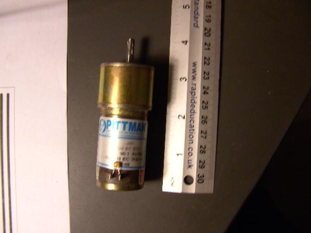

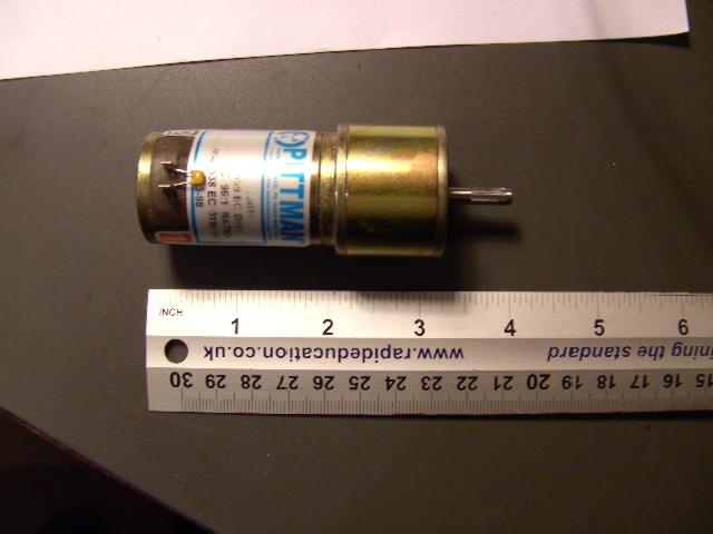

I have some similar to this:
http://cpc.farnell.com/mfa/940d1001/motor-gear-4-5-15v-100-1/dp/HK00908
Built on g/box, 12V IIRC ( dunno about the output revs ..can check tomorrow re: volts/o/p revs if you like ).
Ripped out of scrapped machines when I was at work  on someone's payroll.
Dave BC
EDIT  Done it ...  :thumbup:
Found one
PITTMAN with  96:1 G/box
13V   about 70mA    26 and a few scratty bits  RPM
