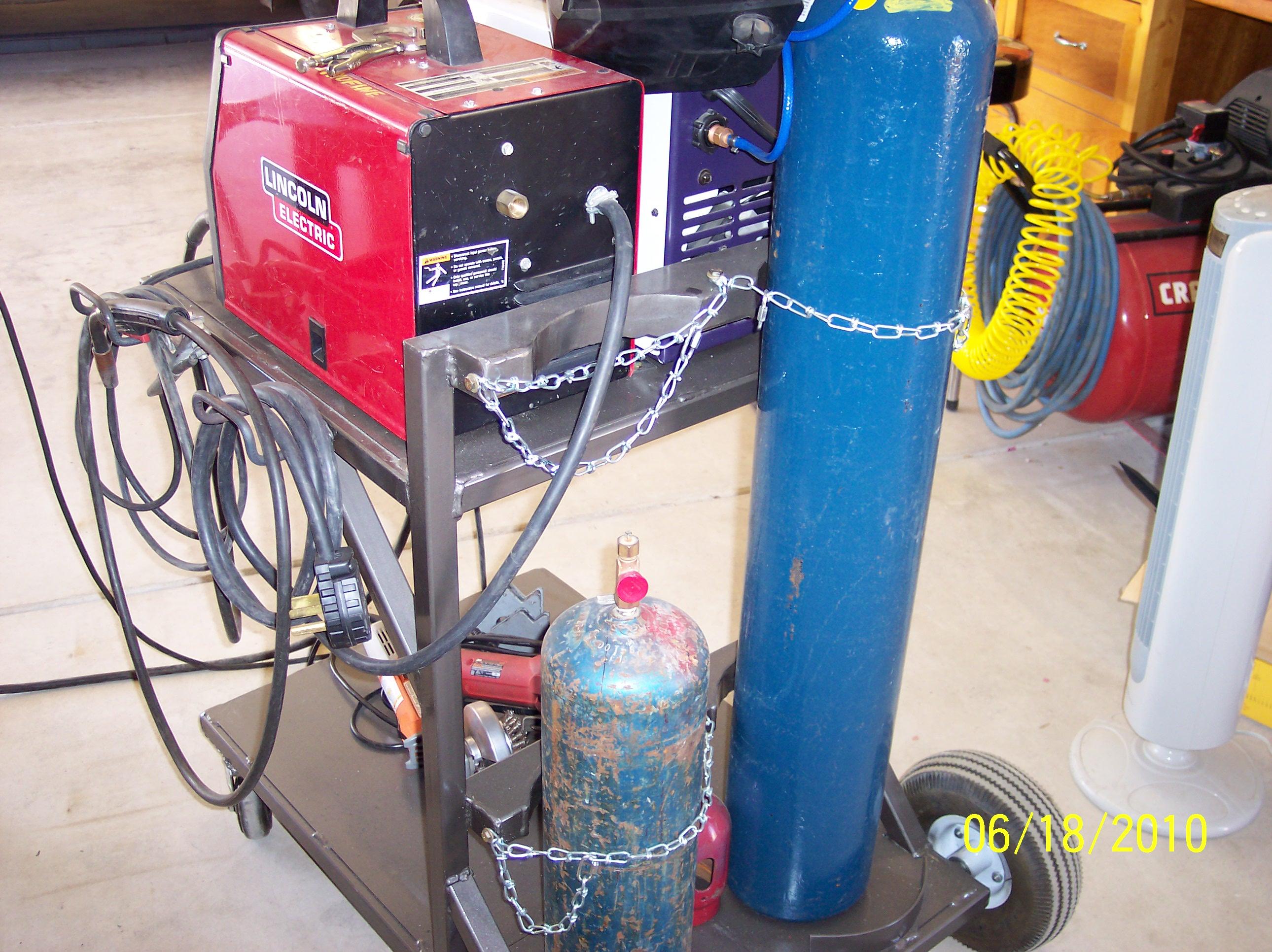

Hi there!
   Just willing to peek at other people's welder cart, i'll start by showing off mine first.  :clap:  It's a way to share interesting ideas.
   Built from a hand truck, a cheapo welder cart that could store only a diminutive gas bottle, a pair of 6' long 1 1/2" angle stock, some bolts and welding wire :)
   It can be opened by removing 2 bolts on the left side, 2 bolts w/lock-nuts on the right side act as hinges, to install the gas bottle in place.
    Yes, the extensions are home-made :)

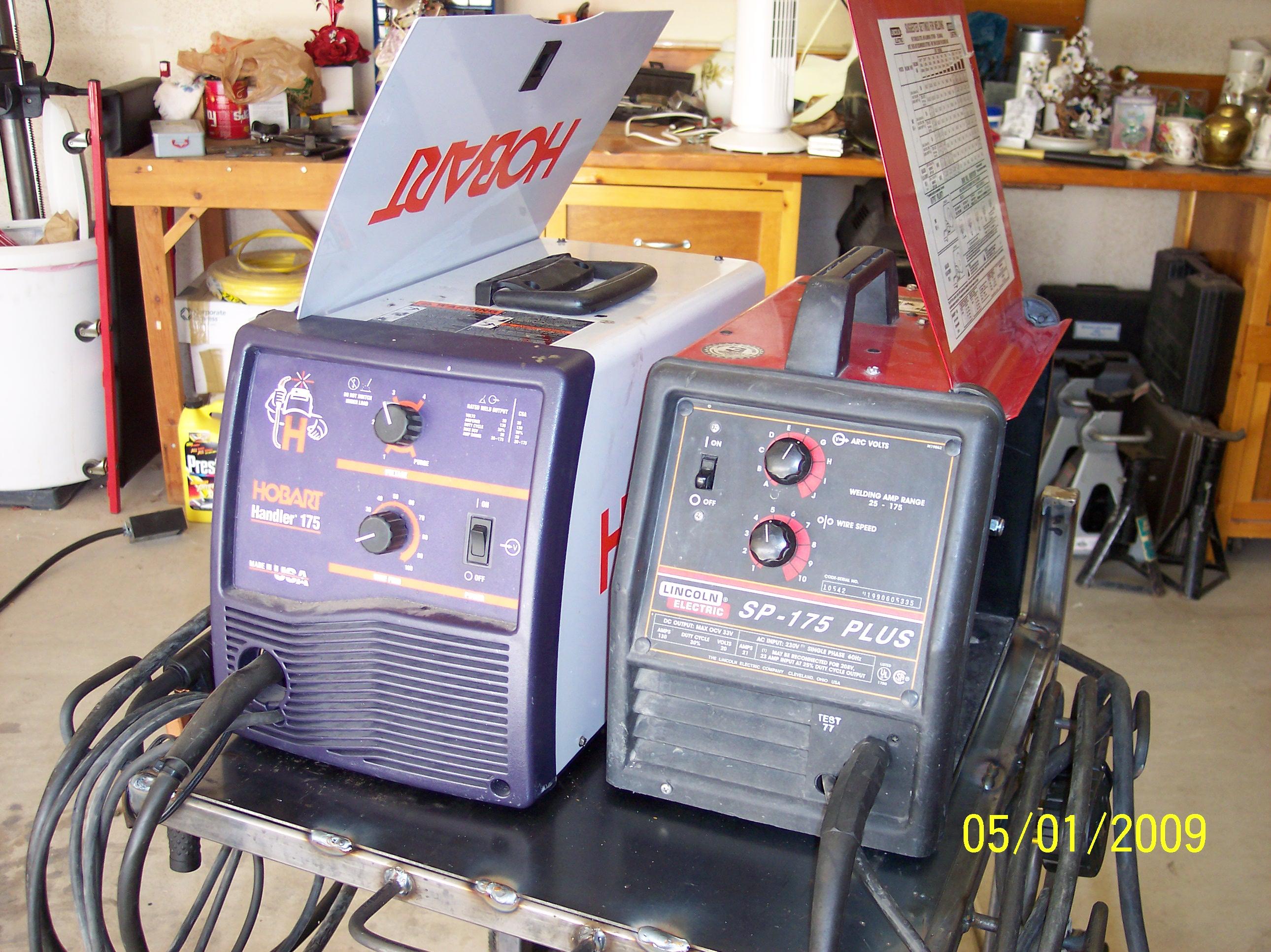

Kinda full................
I haven't always been a nurse..................

Nice stuff here markball  :thumbup:
Why 2 wire welders?  I noted there's one hooked to the big gas bottle and the other is not hooked to any bottle at all, you keep one ready for FCAW and the other one for GMAW?
It's nice that the hobart and the lincoln opens on opposite sides  :clap:

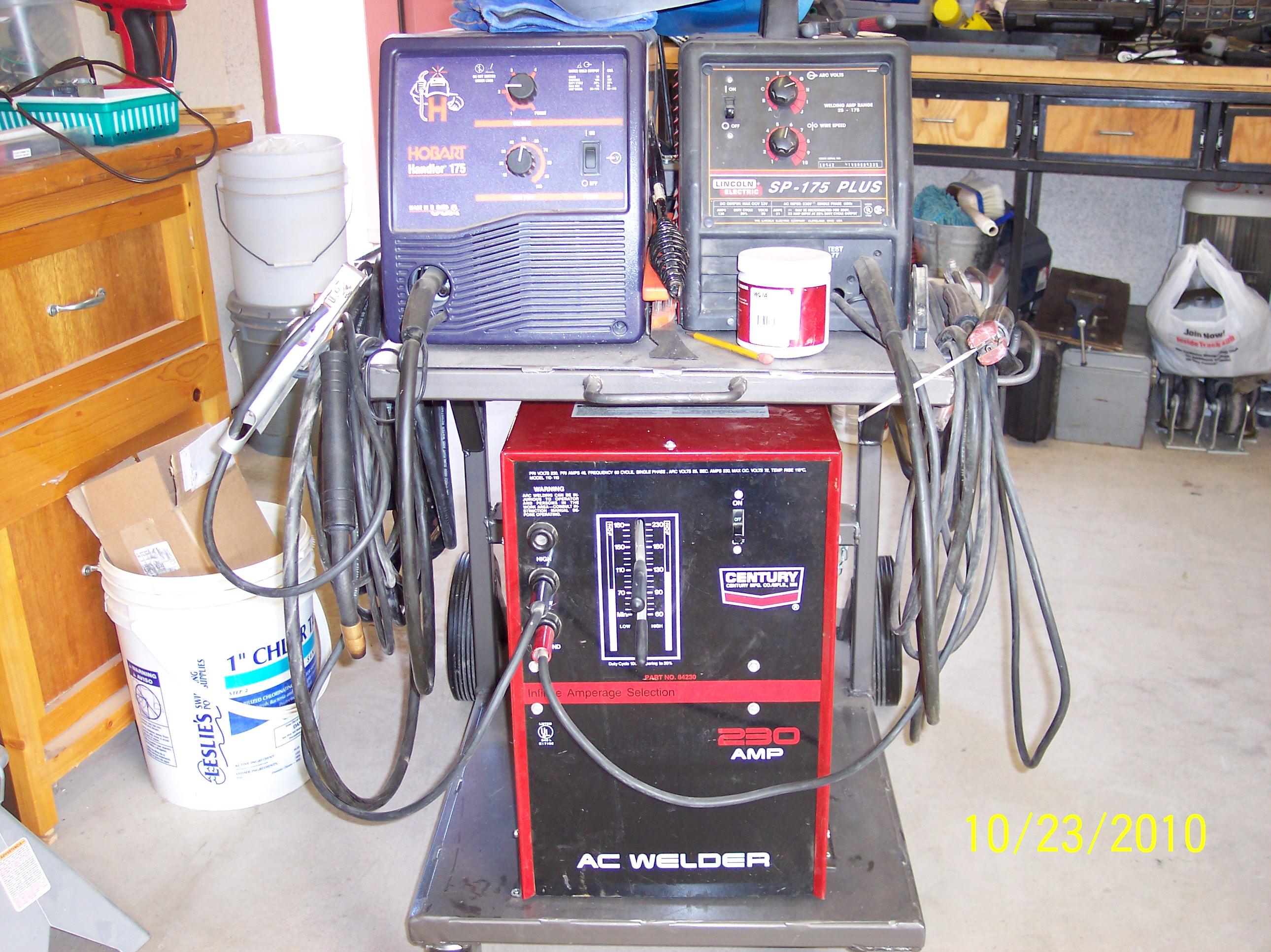

« Reply #6 on: June 01, 2013, 09:31:59 AM »
The Lincoln was a project I couldn't pass up.  Got it for $75, had to put a new liner & a few other small repairs, but it ran great.  I used it to weld some stainless with Tri-Mix, kept the Hobart with steel.  Both are rated at 175A.  Anything heavier that I needed more amps, the stick welder below will handle that.
I've since sold the Lincoln, picked up a Chicago Electric TIG welder & I'm adding a foot pedal to it.  It's rated at 165A.  Now I have 3 bottles on the cart - 75/25 Ar/CO2, 100% Argon & Acetylene B tank.  The Tri-mix is standing in the corner waiting to be uses.  I'll probably swap it for an Oxygen bottle so I can use my cutting torch.
It's a heavy beast, but rolls pretty well once it gets rolling.

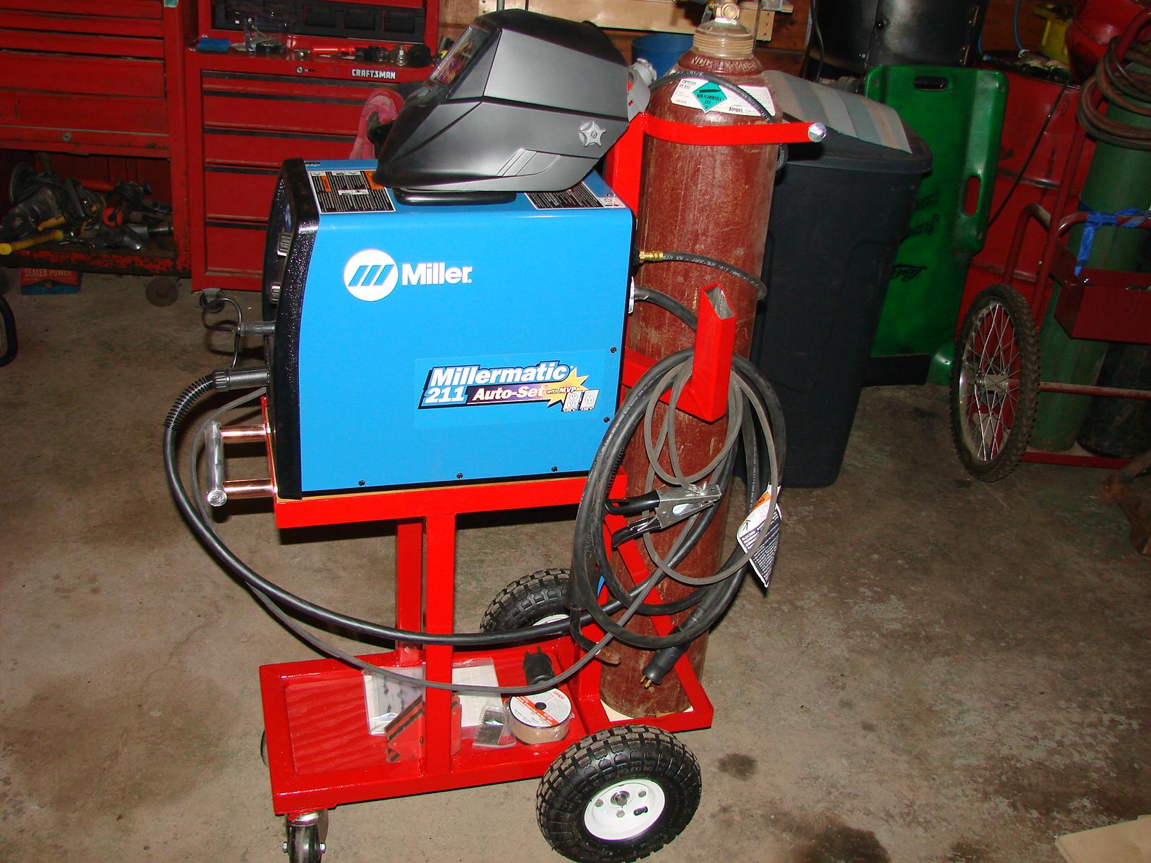

« Reply #7 on: June 12, 2013, 10:34:10 PM »
I just finished making it this morning. The welder was a little too heavy to lug around so this was my solution. Nothing fancy.
