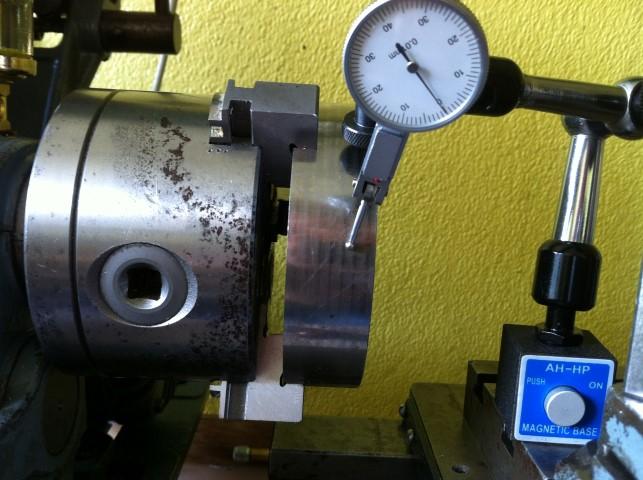

As with most things, I'm impatient and have started to get some of the bits underway (With minimal dimentions)

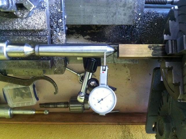

It requires a 4" flywheel. I put an inch thick round slab in my 3 Jaw and it was .2 mm or so out.
Out came the 4 jaw and the centre of one side is well under way to being hollowed out. (More Details in the Tools Thread)

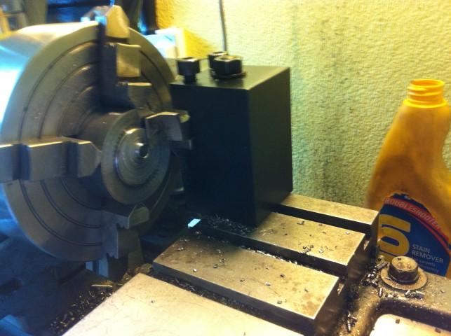

Last week a couple of sheets of Perspex arrived. I decided they would be good to make the Base.
8 bits, 9 1/2"X 2 1/2" were cut and superglued together to make it 1" thick.
I have trimmed it down to the correct(ish) size on the mill.
This looks like it'll be a fun engine and maybe i'll stand a chance of getting it to work...

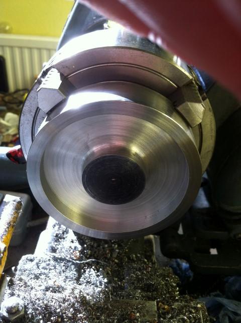

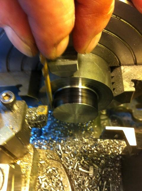

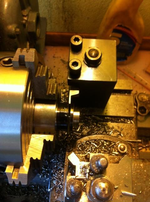

Ok: Both sides of the Flywheel are made.
Centre is reamed to 8mm and fits like a glove on my Stainless steel shafts.
Just need to chuck it up again to skim the outside edge.
I do however have concerns gripping a 9mm deep shoulder / 20 mm dia (I still have a mm to remove if need be) and turning the edge off something 100mm dia.
Are my concerns unfounded ?
Suggestions welcome as always.
Then it's off to the Mill and rotary Table to make nice holes in it.
Never used the table (Bootfair find) It's the same size as the fly wheel (100mm) so clamping clues welcome.
Re: "A Beginners Engine" From Model Engineer.
« Reply #11 on: July 31, 2013, 05:20:32 PM »
That's how I do it, should be fine, just don't run the lathe fast or it will chase you round the shed if it comes off  :D and take small cuts.

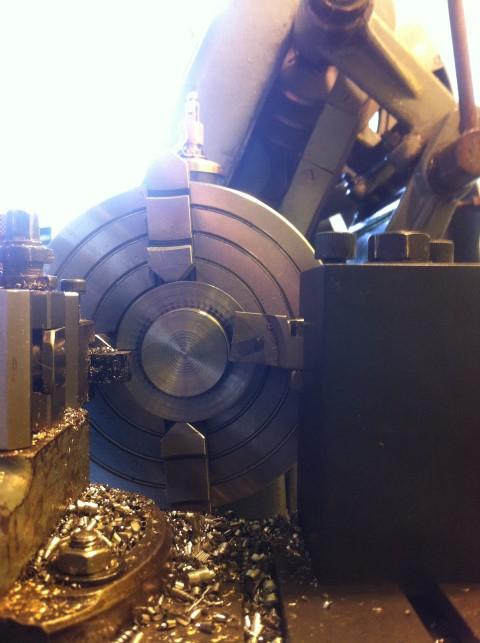

« Reply #12 on: August 05, 2013, 04:09:01 AM »
Hi Guys.
Flywheel is now complete.
It's on centre, and looks like it's going to be ok.

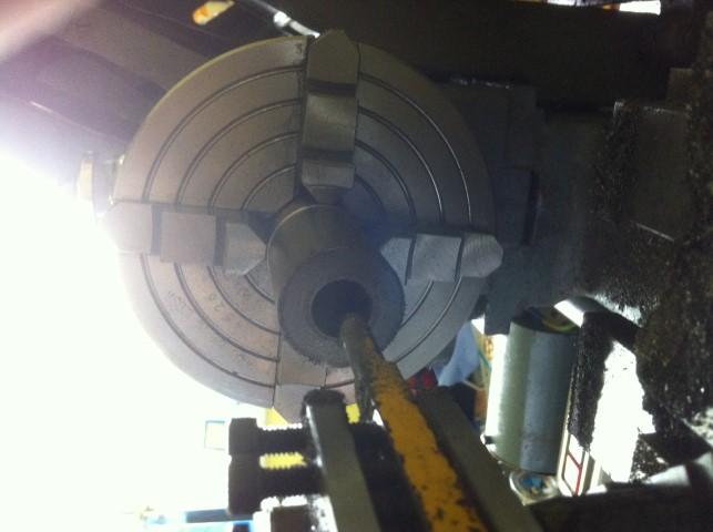

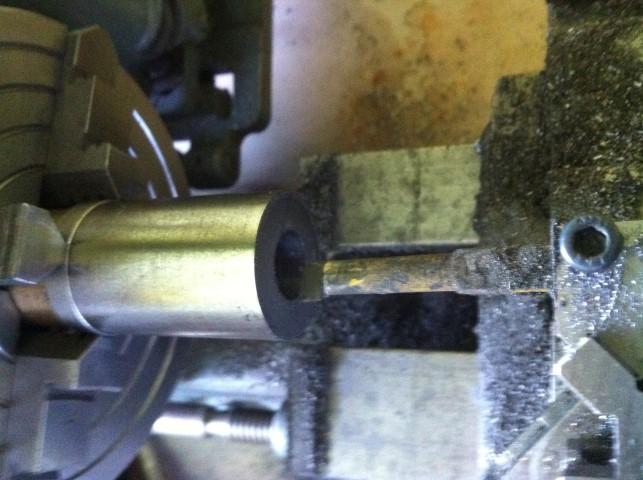

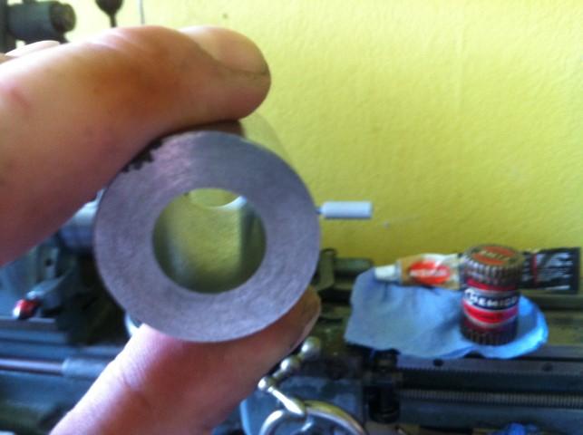

Started on the Cylinder yesterday, I'm making it from Cast Iron (Sash Weight) cos I have some of a suitable size.
You know it's getting hot (Drilling it to 12mm) when your squirt of coolant boils as it touches the work !
I'll complete the bore today.
My Boring tool is rather small but it seems to cut the Iron nicely.
Offline NickG
  • Posts: 1890
« Reply #13 on: August 05, 2013, 05:42:02 AM »
Cast iron will be good, i am using cast gunmetal for mine as have a bit the right size. Is your drill blunt or were you running it too fast? Slow cutting speed for cast iron and it doesn't usually get hot in my experience.
Offline ParCan
  • Posts: 154
« Reply #14 on: August 05, 2013, 06:08:39 AM »

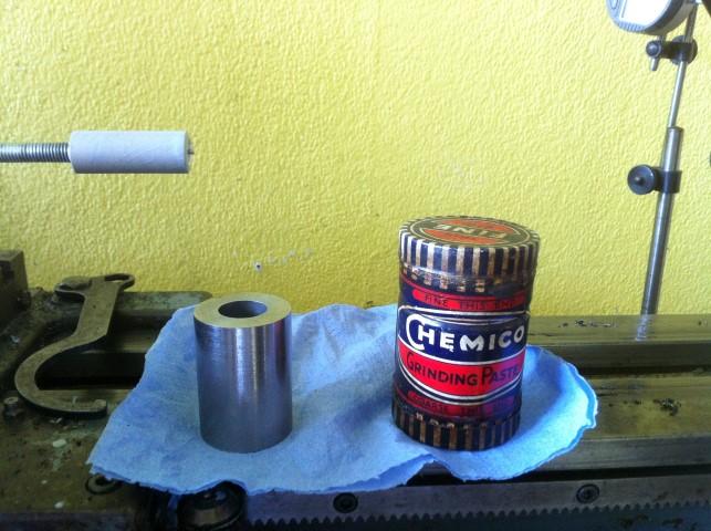

Hi.
Apologies for the Picture size in my last post....
The drill was brand new when I started. It's now somewhat 'used'
Cutting speeds were slow (slowest on an ML7 without the back gear) and I believe appropriate.
Cylinder is bored to 16mm (tight fit on a 16mm Milling tool shank)
Made a Hone out of some Plastic, Probably Nylon, 50mm long X 16mm dia to make it a sliding fit. Tapped one end blind M8.
Starting with Course grinding paste, then fine, I ran the bore up an down the hone for around 10 mins.
Clean down with White Spirit between each paste.
A Quick final with Solvo Autosol (Very Fine) I now have a smooth bore with a fine crisscross of light scratches.
Now it's time for a thorough clean down of the lathe. (to get rid of both the Cast Iron and the Grinding paste)

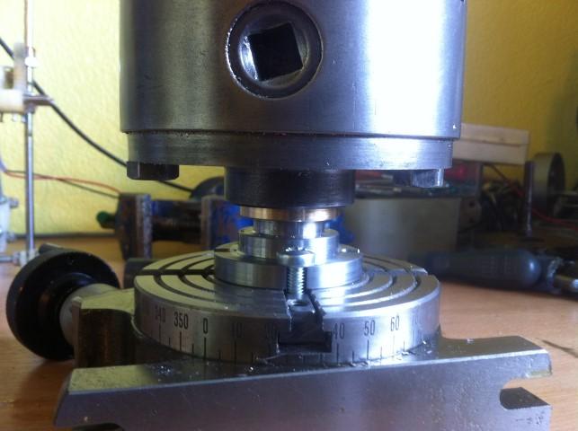

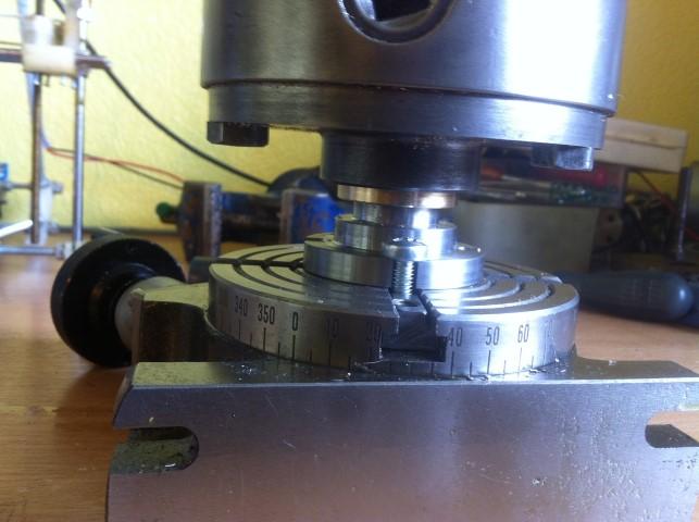

« Reply #16 on: August 05, 2013, 09:01:36 AM »

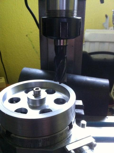

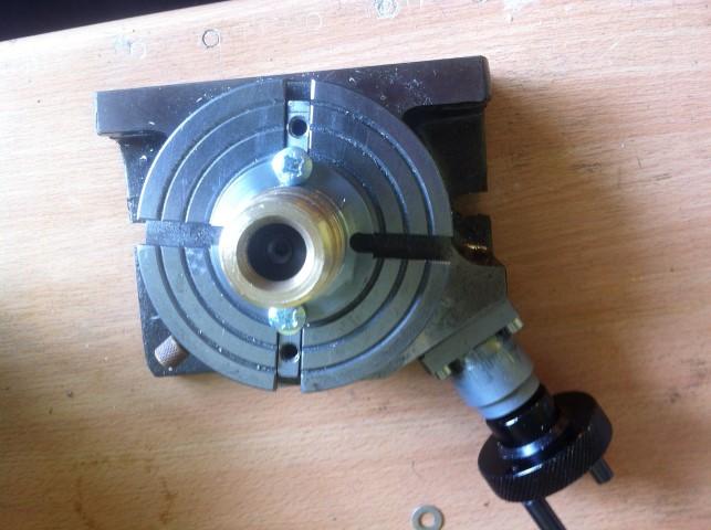

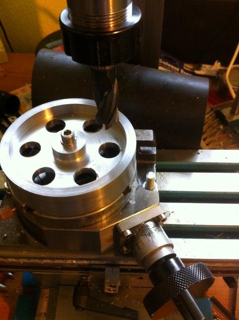

I now have a flywheel with 6 decorative holes in it.
Rotary Table is, er , well - um: not good
Put a Centre into the Mill (had to take the Draw Bar out)
Centred the table and bolted it down.
Checked the runout on the edge - looks good to me.....
Dropped the same centre into the flywheel.
Bolted the flywheel through the centre hole, Checked the runout - 3rd time I got lucky !
Then you encounter the lash. About 1/4 turn of the handle each way.
Centre drilled 6 places (60 deg apart), then 5mm and 13mm drill. (The largest I have)
That all went well.
The only thing I have 16mm is an end mill. That would have to make said 16mm holes.
The lash coupled with a VERY poor clamp screw has confirmed which side is the outside !
Anyway, 6 X 16mm holes in the flywheel sorta 60 deg apart....
« Reply #17 on: August 05, 2013, 10:42:48 AM »
Fly wheel and cylinder looks good  :thumbup:
I drilled with four 22mm holes but it made my old drill sweat a bit, so drew it up with 6*16mm ish holes near enough is good enough for position I just marked mine out and went for it  :D
I know of three engines being made out there  :whip:

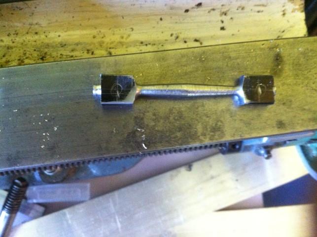

Oh - and where do I get a Wobbler Bar (used to center the Piston Valve ). Does it have another name ?
« Reply #20 on: August 05, 2013, 01:57:33 PM »
Hi Alex
I'm not sure if it has another name I think its one of those things that people sort of call it different things I've just always known it as a wobble bar.
Where you get them from:-
You can make one all you need is a length of 10mm ish diameter silver steel clock it up in the lathe so that its running as true as you can get it, you may get away with the three jaw if its a good un, if not use the independent four jaw, then put a female centre in the end with a centre drill, swap it round and clock the other end true then slew the compound over 30 deg and turn a cone on the end, you can use it as it is or you can harden the pointed end by heating it up to cherry and quenching.
Or:- you can use a solid morse taperd centre, check that it has a female centre in the end.
Her's a picture.
Hope this helps

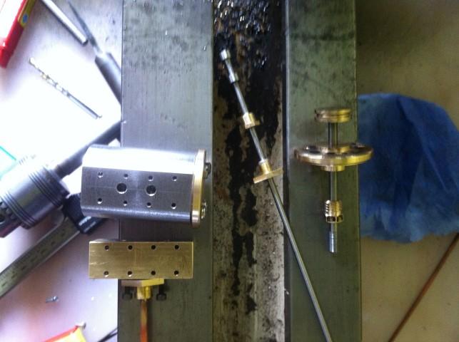

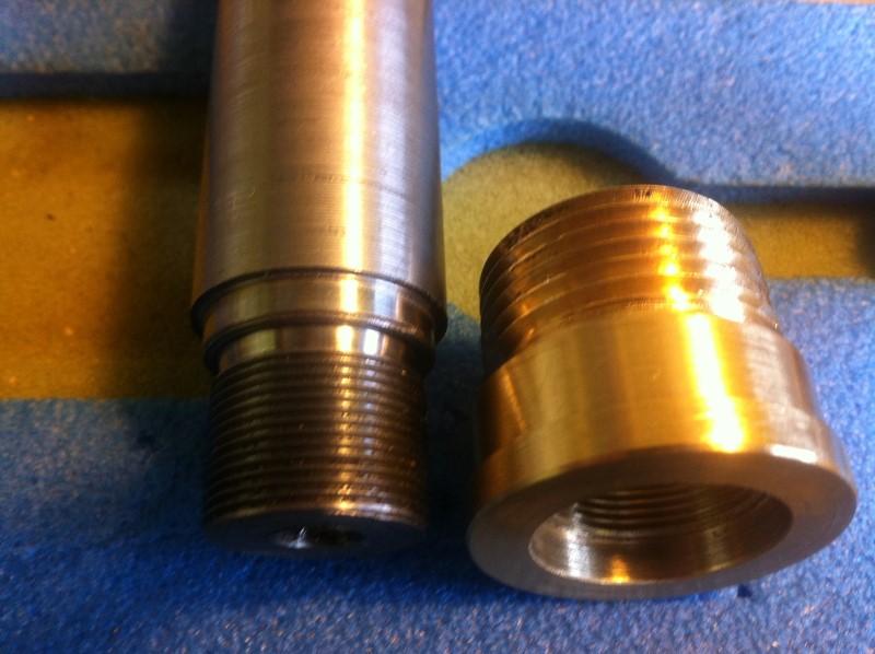

« Reply #21 on: August 06, 2013, 09:07:36 AM »

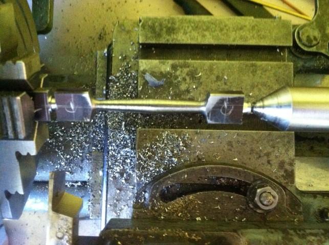

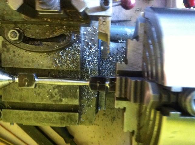

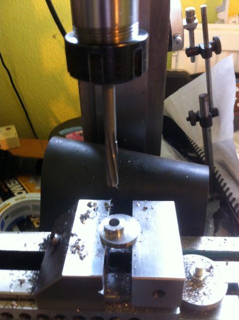

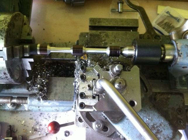

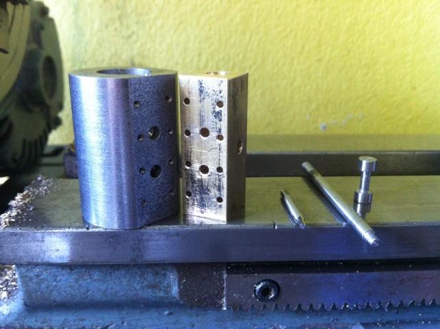

More progress today.
Valve and Piston made. Body was easy enough, piston not so. Got it on the 3rd attempt.
Then I decided it was time for Small holes in Cast Iron time.
Centre punch did sweet nothing so I used a centre drill in the mill to mark each hole before drilling.
Drilled the Ports and used a small milling cutter for the Bore cutout.
Drilled the holes for the Valve. They both wondered a little so opened em out to 4mm.
The 8 X 1.6 mm holes were not fun, neither was the Tapping of said holes.
Just to note, I didn't have a suitable clamp, I Super Glued the Body to the Cylinder then spotted through with 2 mm and drilled 1.6 before removing the valve body and tapping the holes.
I'll leave you to guess where the rest of that tap is !
Piston rod is also done. I may do the piston later.
« Last Edit: August 06, 2013, 12:09:29 PM by ParCan »
Offline ParCan
  • Posts: 154

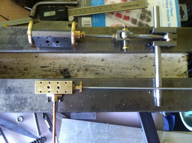

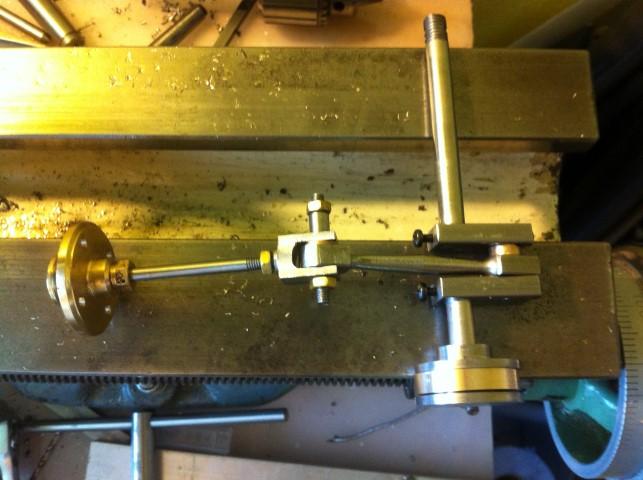

« Reply #22 on: August 06, 2013, 01:32:49 PM »

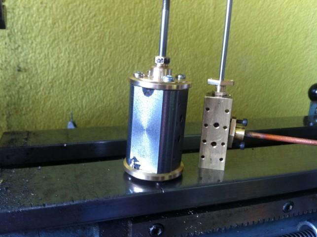

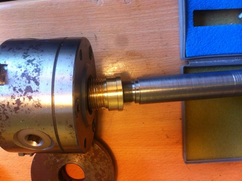

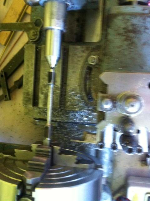

And more progress.

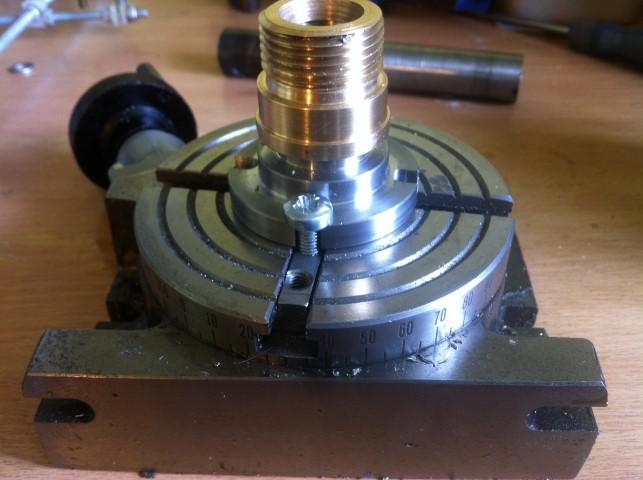

Brass Piston is made and attached to the piston rod. I turned the last bit with the piston mounted on the rod.
Lump of 35mm dia Brass arrived today so made the end caps. Still need to drill them for the mounting holes.
Piston almost runs freely in the bore. I'll knock a tiny bit off the locating 16mm dia.
I'm trying to work out the lesser of the evils for fixing the end caps.
I either drill 3mm all the way through the Cast Iron and mount the caps with studs.
OR I can drill and Tap M3 as per the drawings.
This lump of iron is darn hard in places.....  Comments and ideas welcome.

After another day in the workshop, the assembled list now includes.
1 X Cylinder : Complete
2 X Cylinder end caps : Complete
1 X Piston Valve : Complete
4 X crosshead rails : Complete
I need to do cleaning and filing bits to make thing look nice.
A blow in the requisite hole moved the piston appropriately.
I decided to Drill & Tap the cylinder holes as per the standard method.
8 holes tapped with no breakage though some are rather shallow. I can't get 10mm long screws in at the moment.
I have nice screws for the final build but it's all gone together.
I Super Glued the End caps to the Cylinder and used the Mill to position the holes.
(8.5mm each way from centre seemed to be close enough to work)
I then centre drilled the end cap, Drilled 2.5mm for M3 then knocked the end cap off.
Turn it over and repeat for the other side.
I then drilled the end caps 1/8 " (3.2 mm) on the pillar drill.
I'm rather pleased with the outcome so far.
(edit) Um - I have just seen a problem in the photo's.
1 Brownie point to anyone else who can spot the mistake......
« Reply #25 on: August 07, 2013, 12:01:22 PM »
Looking good Alex.
NickG is building his from the other end and he came across a couple of mistakes on the drawings so her they are:-
Part MP39 crank shaft spacer the hole is 6mm diameter
Part MP30 crank shaft better to make it 100mm long
Part MP33 Main Bearing it should be 10mm wide
I've added V2 of the drawings

Hi Nick
I have a rotary table but no method of fixing a chuck to it.
My Table is also rather cheap n nasty with heaps of lash in it.
I centred the Cylinder with the end cap glued in place.
Chuck up a bit of 4mm rod (that fits in the gland hole) Use that to centre it.
There is a vertical V in my vice. Used that to locate the cylinder in the vice for when I turned it over.

Another productive day.
Crankshaft, Con Rod and Crosshead completed.
I Started 3 Crank Webs just in case. All 3 came out pretty much perfic.
Crankshaft was all rather loose so I decided to Pin it. Broke a drill in 1 web so that became the spare by default.
I decided to use screws as the pins. Easy to get out. Final will have Grub Screws in it I hope.
The Con Rod I decided to make as 1 bit.
I didn't have any steel the correct width which would make attaching the Big End bearing a bit of a nightmare.
I also don't have any 1/4 square Brass. (I plan to mill the cross head slides from what I have)
I did the crosshead on the Mill. It's a tiny bit shorter than the drawing.
Also note. The M3 Thread for the Piston Rod should be M4.
Big and Small end bearings are Oilite Bushings I had in stock.

Eccentrics today have not gone well.
I decided to make a steel inner and Brass strap.
The only suitable steel I had started out at 2" dia. A few passes of a roughing tool sorted that ...
I turned the 20 mm X6 deep shoulder.
Out came the Parting tool which really struggled in the std tool post.
Decided to try the rear parting post for the first time and I have to say it worked a treat on the 1st bit.
And I parted it off all the way.
Moved 1 jaw of the 4 jaw 3.5 mm measured with a drill.
Pushed the work across, Double checked the 3.5 mm offset and centre drilled it.
Then I looked at the first part which was missing said 8mm hole  :doh:
Turned the 2nd bit and then tried to part that off.
Tool post was hitting the chuck so took that off.
Then the jaws were hitting the Saddle (by quite a margin.)
Had to move the tool post as far as I dare off the side off the cross slide.
Carried on and hacked my way around the missing hole issue....
I superglued the 2 bits together back to back. Centred them on the mill. Centre drilled the 2nd part, then reamed them both to 8mm.
As I have some tiny M2.5 grub screws I decided to grub screw both bits.
The Eccentric strap was a simple turning and boring job and has come out really nicely.
« Reply #33 on: August 09, 2013, 07:19:23 AM »
When parting off Alex don't be afraid to resort to the Mk1 parting tool:--- the good old hacksaw:- we all resort to it if we were honest  :headbang:
Looking good I recon at this rate we will be seeing a video of the running engine soon  :whip:

Flushed with the success of the engine, I have been screwmangling.
I decided it's time to make a chuck holder for the rotary table. Also need to make a spindle for my Dividing head (from workshops books).
This is my first go at screw cutting, In came the Back gear and took it about as slow as the ML7 will go.
Then I started to Browse Ebay, which almost always lands me both in a great deal of trouble and costs me money.....
http://www.ebay.co.uk/itm/Myford-Super7-lathe-/300947767330
looks rather nice n tidy, yes it's a seller refurb but it's been reground and looks to be nicely finished....

Made the Spindle and the Chuck adapter yesterday.
That's all glued up with thread lock.
Made the base clamp today, again all between centres.
Final product looks good to me :)
