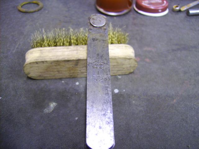

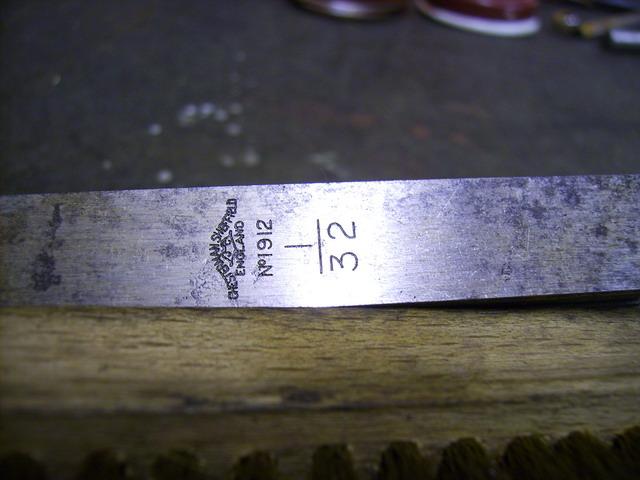

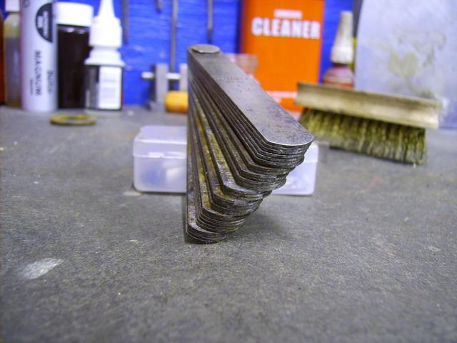

hi all i got this in a tool box full of stuff but i ant got a ? as to wat it wood be used for at furst i thort its a large set of feler gages but no all the blades are the sam thiknes see pic

Hi Bob
If it's Rabone Chesterman I would guess it's for setting wood-butchering machinery.
Blade/ cutter height or the like 'cos joiners can't deal with anything more accurate than 1/32"  :palm:
I have a mate who's a joiner .... I occasionally make metal things for him ... absolute nightmare ..
33/64" is 'HALF-INCH FULL'   ???? What the Hell is that ???
Likewise 31/64" is 'HALF-INCH BARE' ??? etc. etc.
Dave BC

This may be more than you want to know but...  :smart:
Years ago I worked as a draftsman in a wood office furniture company. We used “full” or “shy” to indicate 1/64” tolerance.
We would always dimension the desk pedestal cases to have an opening of 15 3/4” full. This meant that the opening could be 1/64” over the 15 3/4” but under no circumstances could it be less than 15 3/4”.  The drawers were dimensioned at 14 ¾ “ shy. When the drawers and cases were assembled that would leave at least 1” to 1 1/32” of clearance. The drawer slides would work fine with this clearance. If it was anything less than 1” the drawer would  jam and have to be disassembled and the drawer sanded down.
Basically “full” or “shy” was a type of tolerance applied to something that was critical. You would only find that applied to the length of a wood part, not the width.  :D

Hi Bob , I would say it will be for setting blade heights etc too, even if its not meant for that you could use it for that so handy bit of kit, another good find in your bargain tool box  :thumbup:
