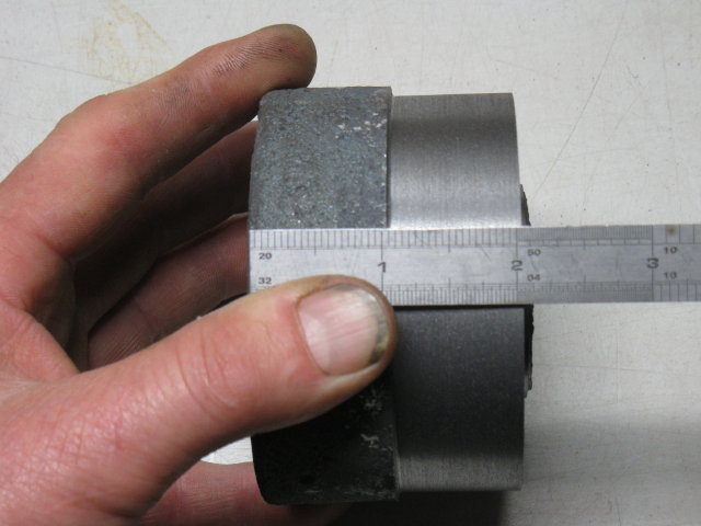

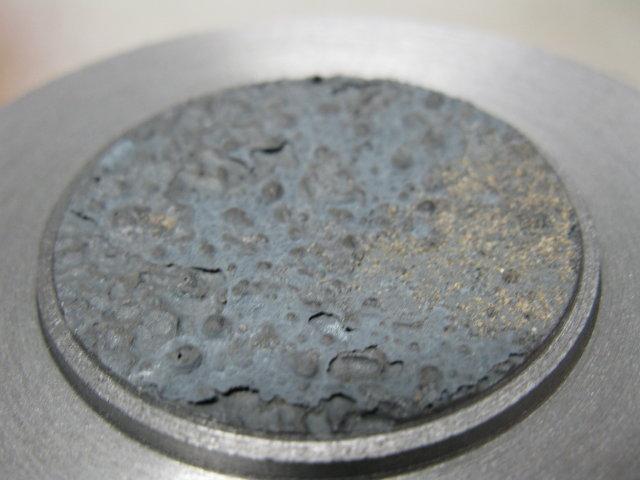

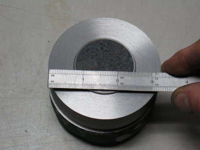

No blowholes in this casting
« on: July 26, 2013, 03:06:43 AM »
This was the leftover iron, I  poured it into a billet mold in the big crucible video.
This sand was made seven years ago so I rammed it lightly to keep the porosity high.
Two test cuts were made, no blowholes.
 After that pour I decided to get rid of that sand before blowholes begin to develop.
One last word on bubbles. Have you ever noticed what happens when water is poured into a clear glass? There is a lot of turbulence and air bubbles. This billet mold was poured the same way, no blowholes.
I have read the foundry books where you must keep the sprue full at all times otherwise you will get blowholes because of all the turbulence. I never bother to keep the sprue full and I don't get blowholes in my castings.
Pat you can't believe everything you read.
