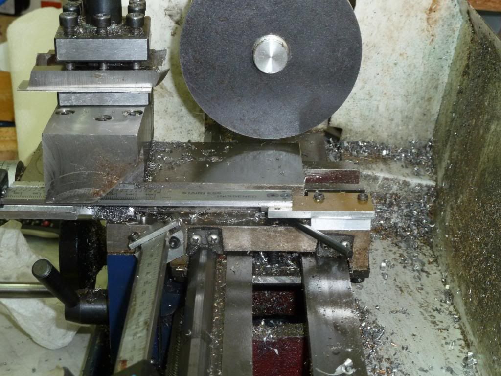

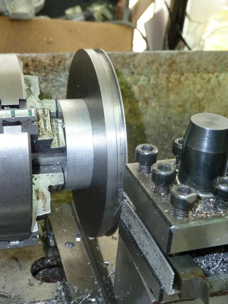

I need to cut a 4mm  wide slot onto the outside edge of a 108mm x 10mm mild steel disc. I only have a small lathe which tends to chatter with this kind of thing, so i thought I would do them on the mill with the rotary table. Not having a 4mm slitting saw, i stacked 4x1mm ones together. The finish at the bottom of the slot was rubbish, and it took quite a long time to do. I'd left the slot a bit shallow so I was able to tidy up a bit on the lathe. So I was wondering if it would be worth investing in a T slot cutter which can be bought for 4mm slots. The slot depth is only 2.1mm so that shouldn't be an issue. I need to do a few of these so what is the typical life of such a tool ?  The other approach which I'm a bit reluctant to consider, is to stand the rotary table on its side and have at it with a slot drill (2 flute endmill). But I have a less than stellar track record with the small ones, and as I only have a 6" rotary table it will have to be a very long slot drill - so probably not a good approach.
My current plan is to purchase two more 2mm slitting saws and stack them as before, but if its worth trying a T slot cutter I'll give it a go.
Best Regards
picclock

Offline picclock
  • Posts: 613
Re: Slitting saw or t slot cutter ?
« Reply #4 on: July 26, 2013, 10:40:56 AM »
Hi Roy
I have three parting tools 2.2mm and downward to 1.45 mm which I have tried. Its only a 7x14 lathe so its fairly limited. The issue occurs because the cross slide and tool holder are outside of the ways at this diameter, therefore the front way acts a a pivot for the cross slide. I can get away with turning metal as long as I am careful, but using a parting tool where higher forces are incurred causes issues. Parting at smaller diameters, say 2" is no problem but with a part over 4" its generally doesn't seem possible.
@ Fergus OMore
The slot is to be cut round the circumference of the disc (the outside edge) and goes all the way round it.
Best Regards
picclock
« Reply #5 on: July 26, 2013, 11:54:12 AM »
Any chance of getting a clamp on the top of the saddle, where it's exposed behind the cross slide, and the underside of the rear bedway, to hold the saddle down so it can't pivot?
Actually, studying your last pic, I see you already have a clamp hanging down between the ways. I'm surprised that isn't enough, but obviously it's not.

Any chance of a picture or 2 of your tool grinders
« Reply #12 on: July 26, 2013, 04:39:50 PM »
Maybe it's an illusion, but If I lay a straightedge across the photo of the face view your parting tool looks above the centerline.
Tubal Cain had a number of suggestions for assisting parting tool operations -- tough to describe all in words but I'll try.
First of all a fish tail shaped grind in plan view of the parting tool end.
Second, a packing strip of steel placed under the parting tool as a support. This strip had a rectangular leg -- looking like a flag hanging down near the tip. It was in contact with both the lathe saddle and the strip -- brazed to the strip. Thus the parting tool had essentially tangential support.
He also had an alternate toolpost -- basically a huge blob of cast iron he called "the Gibraltar" -- but that's beyond the scope of this job.
Offline picclock
  • Posts: 613
« Reply #13 on: July 27, 2013, 09:16:52 AM »
So although the info on the lathe changes are interesting no one has answered the original question as to which is best for cutting the slots on the mill,  a slitting saw or a T slot cutter.
Other slightly odd thing is I can turn the metal disc on the lathe with no real problems, but the chattering issue is always there with the parting tool with these larger sizes. I have tapered roller bearings on the headstock which I have just checked by hand for deflection, which gives +- 2 thou with strong hand pressure - is this excessive ? I have no idea what sort of movement a normal lathe spindle would have.
Re the tooling height. The height in the picture is correct but I tried varying a mm either way to no real effect.
